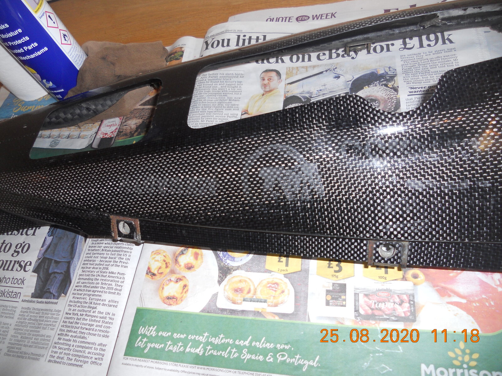

  1. Well folks i've removed the go slow stickers from the 998 carbon fibre belly pan with a hot gun & thumbnail at a safe predictable distance,but unfortunately the remaining adhesive residue is very stubborn with just a soft cloth coated in WD40,anybody up to speed on a faster method without scratching the carbon material would be appreciated.
  2. Nail polish remover or a bit of petrol. Try a small area first.
  3. Acetone, nail varnish remover is the same stuff. Dissolves any neoprene based glue.
  4. Just love this answer;"Try a small area first":thinkingface:.........so does it works without any discolouration whatsoever then,?
  5. looks like you have touch of the "bloom" unfortunately. As said, stripping off lacquer and re-doing is probably your only route, and hope the discolouration hasn't affected the base carbonfibre.
  6. Should be fine but agree with Chris. Might have to have a go relacquering. I just put that in for a laugh (try a small area first) TBH. Never had any problem with acetone on mine. It’s a good degreaser if you do have to re lacquer the part too.

  9. Chris / Richard,i think it's ok as some adhesive has been removed already by me with the WD40 and what i can see the top shine protective coat is still inplace,i really don't want to go down the re-lacquering route.
  10. It’s going to be fine then. Nail varnish remover job jobbed.

  17. not saying for certain/have no idea as "remote" but with lacquer any form of glue applied for some time usually end up "in it" rather than "on it" hence the term bloom. Don't be afraid of re-lacquering as it's hard to get wrong if you use the right product (worth a search).
