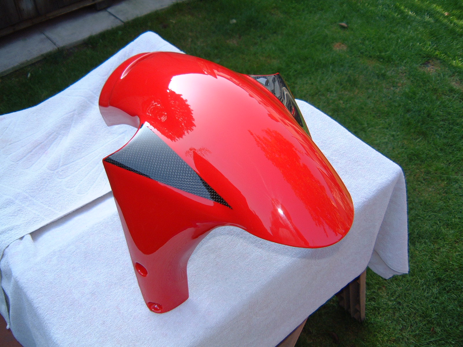

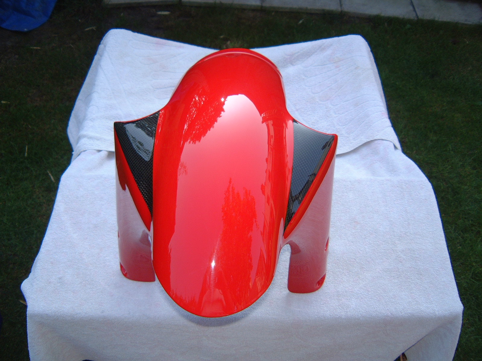

    Here is a mudguard I did a few years back to give you an idea. This was a very poor quality new mudguard I bought on eBay. It wasn't good enough to mount as it was as the sides were badly finished so I painted it but left some carbon showing through.
  16. Did you just teach yourself with trial and error and Google and chatting to people? That's awesome.
  17. Is that just from a rattle can and a can of clear?
  18. No it's from a spray gun using ICI Ducati Red and finished with a number of lacquer clear coats. It's very hard but by no means impossible to get a decent finish using aerosols because of the thickness of each coat is limited. The above work was done outside which made it a lot harder. As was this below, my Ford 1934 3 Window Coupe with 350 cu in Chevy V8, I spent 2 1/2 years and 3,500 hours building this from scratch and did 98% of the work myself . The photo shown was taken for an article in Street Machine magazine.
    I am totally self taught but have been spraying for many years, and it's saved me a fortune over that time. I purchased a very good compressor way back in 1984 to start spraying with and it is the only major tool I have bought that has paid for itself many times over. I still have the compressor even now and use it for a majority of my spraying. Most of it is about preparation and patience and working on something until it is right. You also need a decent spray gun.
