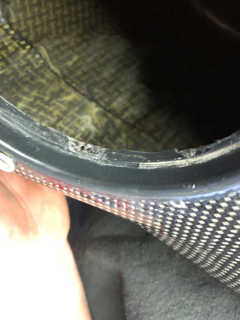

  1. I bought and fitted a second hand carbon fibre 916 fuel tank in the summer.
    Unfortunately it’s spring a leak from where the fuel pump base plate mounts.
    The workshop have reported today that the reason it is leaking is that the resin around the rim has been degraded by the fuel and is crumbling away. See pics (hands belong to Ray Petty).
    Thankfully it was only a dribble of petrol but looking at the pics it could easily have been a flood followed by an inferno.
    Any recommendations for repair or just chuck it in the bin and buy a new one?
    Thanks

  4. Looking at that picture, the flange that the pump ring bolts down on doesn’t have much meat, and looks very resin rich.
    potentially the vibrations and use its had together with successive tightening up cycles would have only stressed it further until it just gives up as theres no real carbon there to reinforce the matrix.
    you can get that repaired easily and reinforced rather than throw it away.
    after that use por15 or whatever their latest and greatest product is to seal it as best you can.

  13. If you do decide to replace, just get a beater aluminium tank, who are the daddys of the Suzuka 8hr and endurance fuel tank.
    The cost will be on par if not cheaper than a carbon one and you won't have the associated headaches and the world of hurt that is a carbon fuel tank bought by civvies.
    The problem you have with your tank is that it's a wet lay tank probably of nearly 20 years vintage and that fuel ring area is heavily resin rich. - And you don't know the resin system whether it's an epoxy or polyester based item.
    You're going to bodge paste one bit of it and down the line more will crack off.
    You'd be better off going to a composite manufacturer and getting them to take a mould of the area, and make a nice new pre-preg ring that they can graft on.
    The other option you might want to consider is to make a new ring entirely from alloy, drop in in there bonded in place and your filler cap bolts into this. In fairness it's probably the route I'd look to if I can't get a piece laminated to go in there.
    Yes your pump mounting plate might sit a bit higher by a mm or two but all said and done a rubber ring and some foam can hide that.
    You might want to talk to these people regarding the sealing matrix:
    https://www.masterbond.com/products/polysulfide-adhesives-sealants-and-coatings
    It's not at the point you have to consider dumping it, but new or used, it's a road bike it's going on and that opens up several other things you have to consider relating to the upkeep of it. :)

  16. just emphasise that if possible you want to go back to the carbon.
    That milkyness you can see in your picture on the tank ring is a thick slug of resin, and it's that which is breaking off. It's brittle so any little stress on it will cause it to fracture over time, and repeated heat and vibration cycles won't help.
    Whoever you get to do it ideally should reconstruct the area and give you a solid seat onto which to bolt your filler down onto. Even if they cut a ring out of carbon and bond it in it will be better than what's there at the moment.
