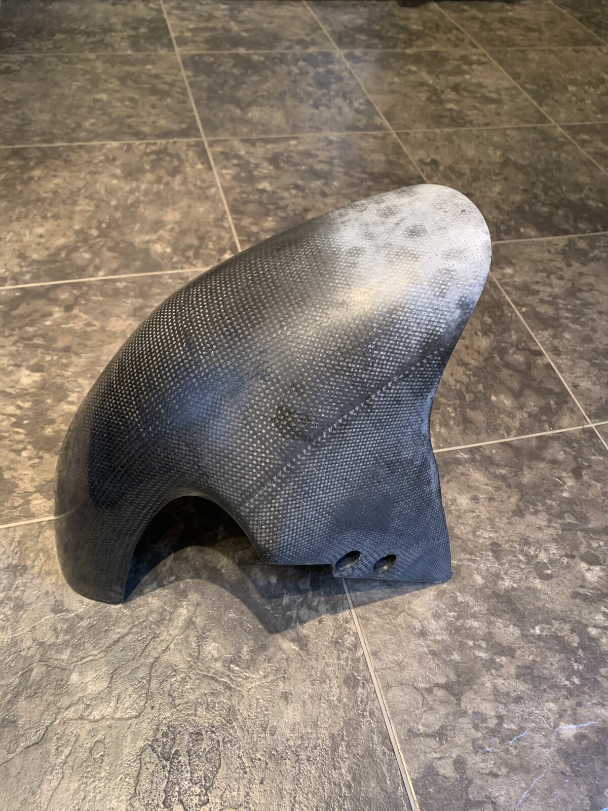

  1. Hi,
    does anyone have any top tips on how to bring the life back to an otherwise washed out looking front mudguard.
    The carbon fibre appears to have faded in the sun and has turned a washed out grey.

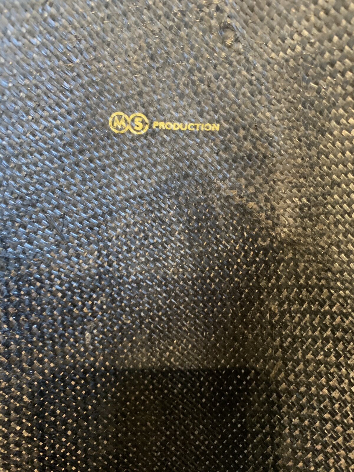

  16. Taken the mudguard off this morning, you can see the fading from the leading edge.
    From the marking on the inside, I don’t think it’s an original part! 7FDEC5A2-02A3-47F2-BF2D-E7CB07E6A4F9.jpeg
  17. Yeah it looks a nice original piece,just some TLC required.:upyeah:
  18. So as a sideline Marks and Spencer used to supply carbon fibre parts for Ducati?
    It’s a crazy mixed up world!
