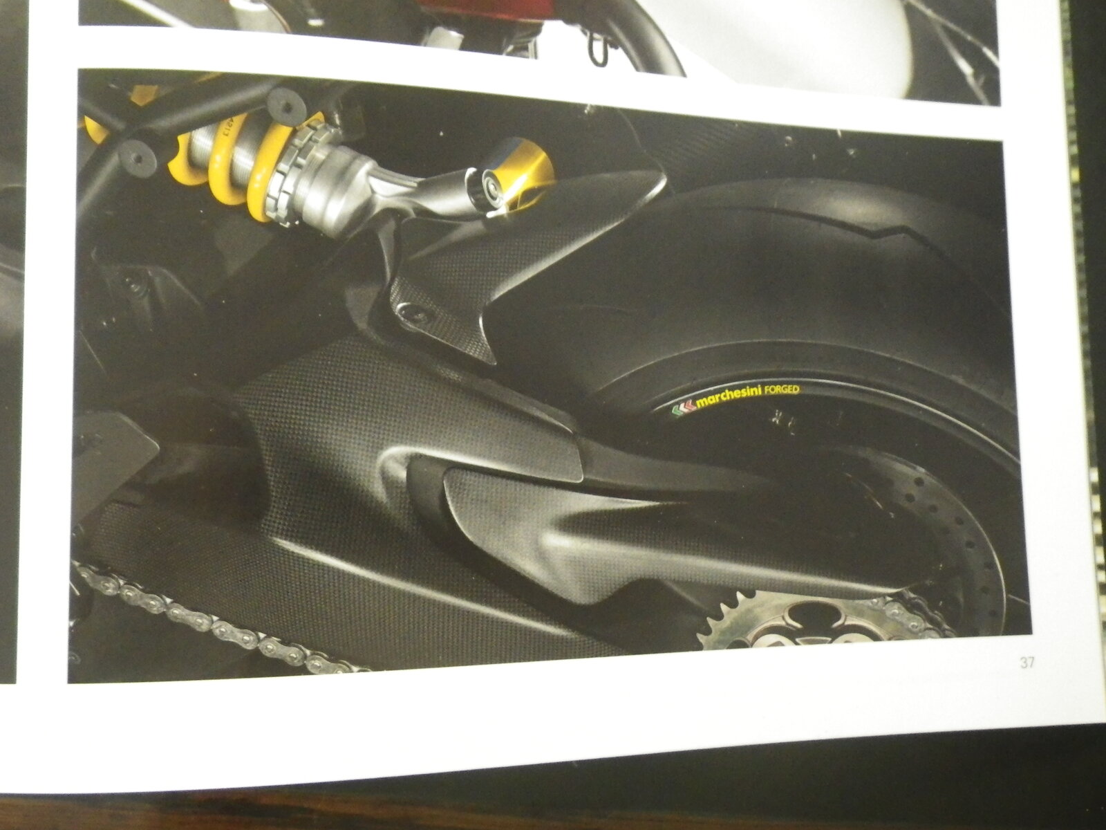

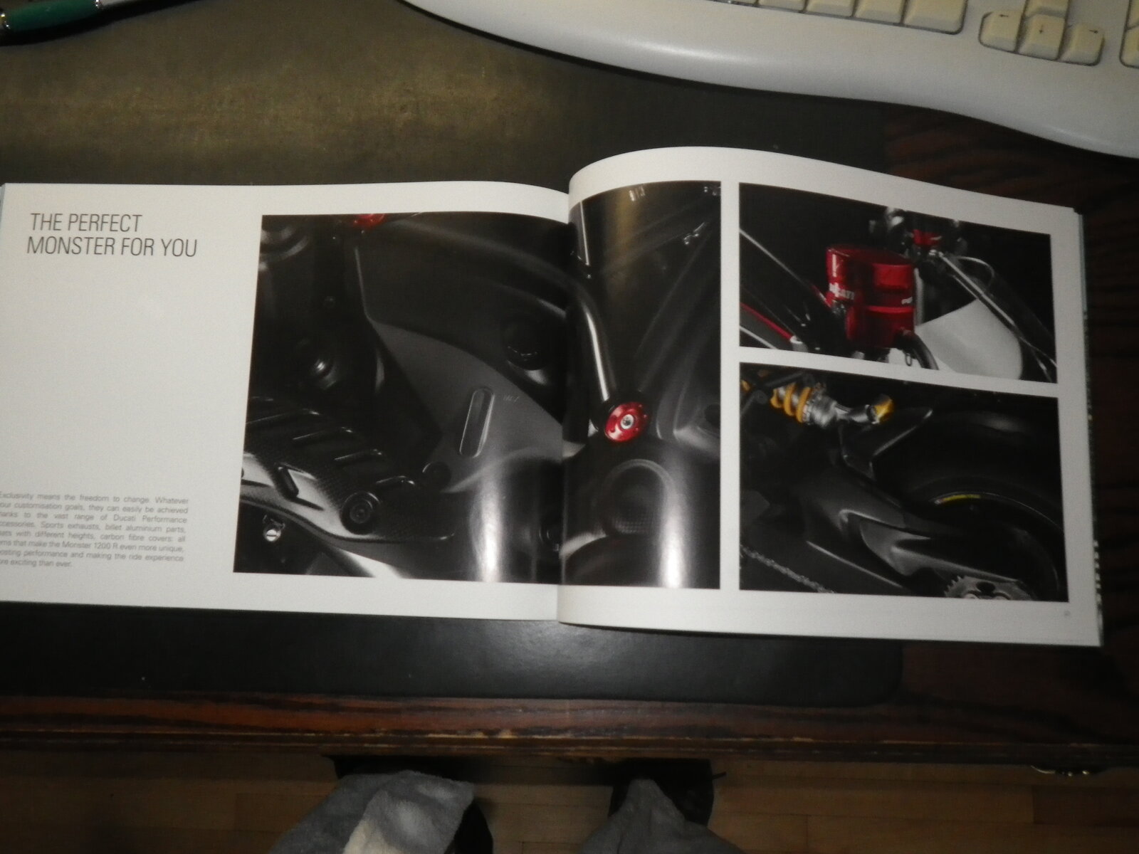

  4. The swingarm on the "R" 37021381CB is different even from the 2017~20 Monster S.
    I know DP made a swingarrm cover for the "R".

  5. Are you sure DP makes a swingarm cover for the "R" because i can't seem to find it?
  6. Yes. I just edited my previous post with photos from the Monster 1200R booklet.

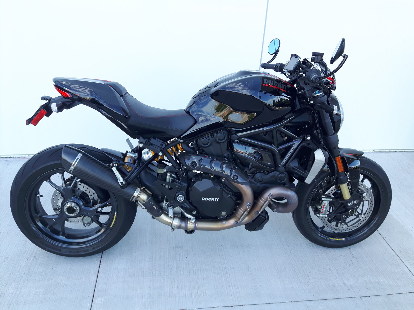

  8. You have a lovely looking Monster. Any pictures of the other side of it?
  9. Unfortunately not. I never think about taking a photo of that side.
    However, there's not much to see there in CF. All I have on the left side are: engine cover (Similar to the right) rear hugger and chain cover. I didn’t get the swingarm cover as it was ridiculously priced back then.

  11. The Monster 1200 2014/15/16 and R models have a different swing arm to the 2017 on models I believe.
    I think the supersport has the same swing arm as the Monster ?
  12. The "R" (37021381CB) has a different swingarm than all Monsters.
    https://issuu.com/desmoworks/docs/monster1200r_en_us_my17
