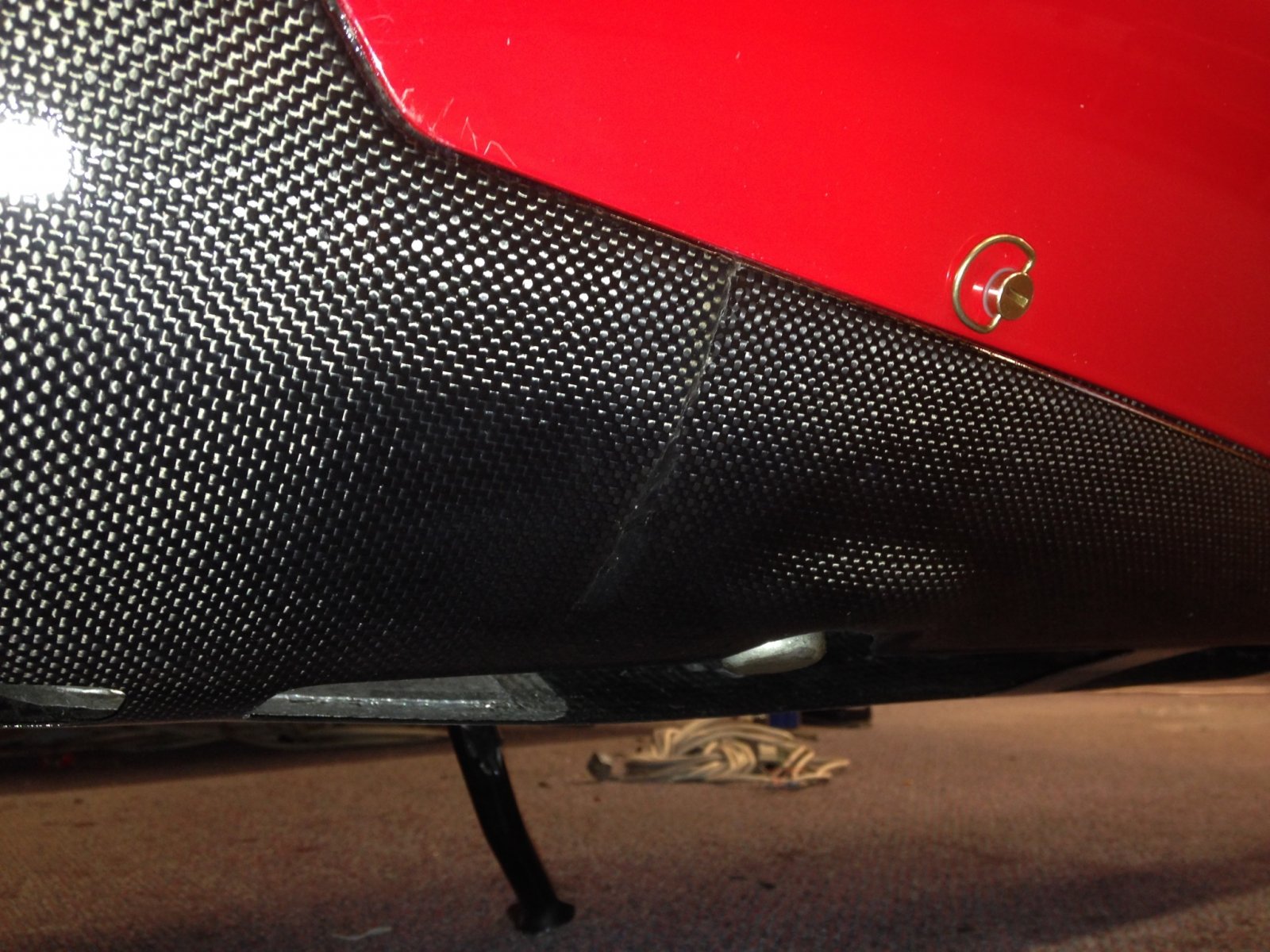

  1. Has anyone here had any cf repaired professionally, and how did it look afterwards?
    Mine has quite a large burn hole on it and you can feel the material as all the lacquer has burnt away. Maybe its beyond repair, only had the thing (cf belly pan) on around two weeks. :(

  9. I repaired a 4" split in my carbon belly pan the other weekend. I put some fibreglass mushy stuff on the back for a bit of strength. On the out side I used aroldite with a bit of black paint mixed in. Let it set, rubbed it down and re lacquered it. Decent enough job to go un noticed unless really looking for it.

  10. I've repaired CF belly pans with exhaust burn holes and used different techniques, can you post a photo of the damage @Pavey :Watching:
  11. Will do, thanks for the help. The bike and panel is currently at the garage, will post one when i go to pick it up.
  12. I'll be picking it up from the garage in the morning to bring it back (the panel, not the bike).
