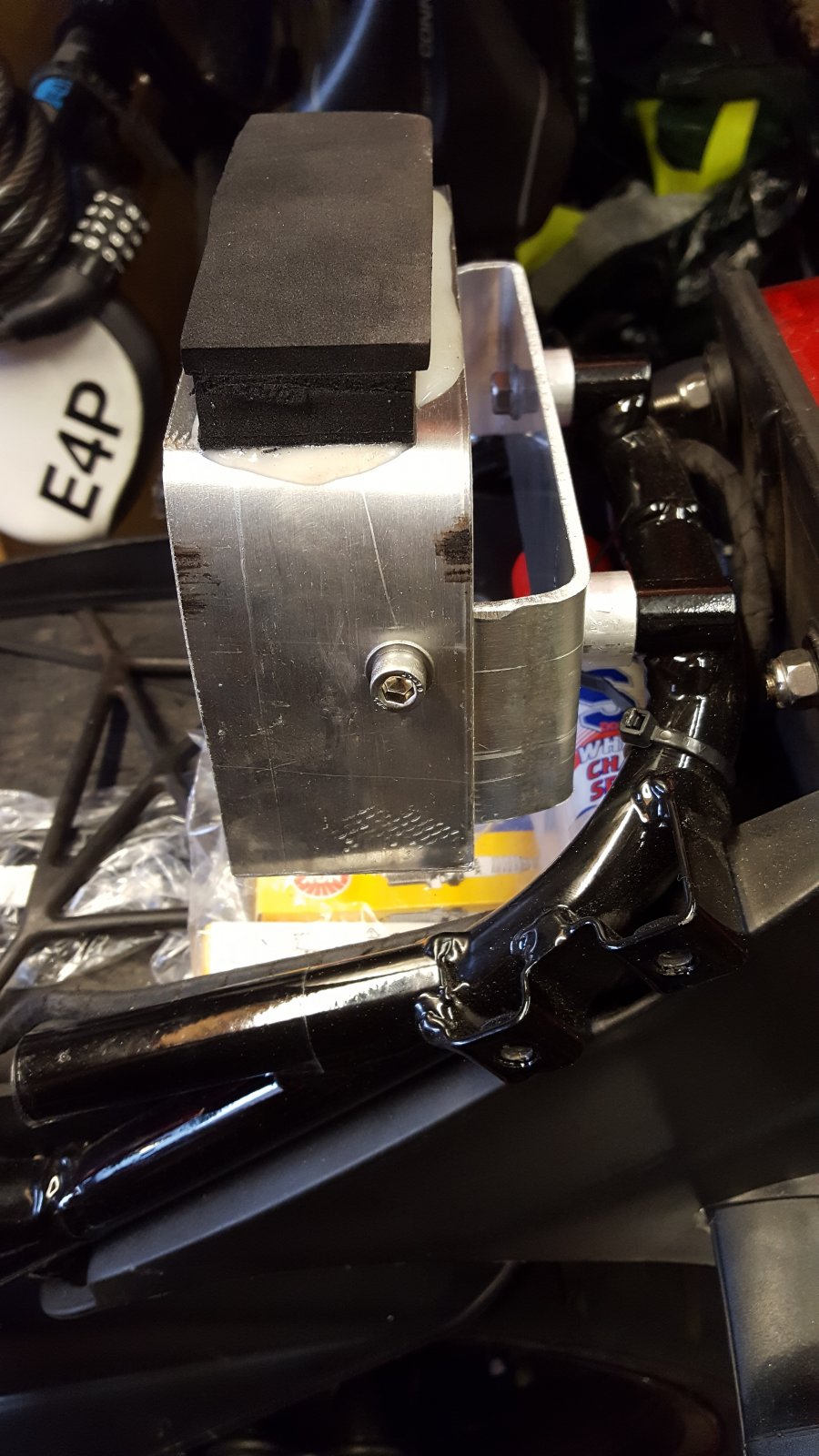

  7. I'm about to do this - I have just received the brackets I ordered a couple of months ago from Stein-Dinse. I was not happy with the RW as it came. so I will start fettling that first.
    Buying an original unit would be the cheaper way to go
  8. So - this is stage one felting the RW. I am extending the fibre-glass all round before cutting back to fit the light.
    I'm using thickish chop-strand mat and going to do three layers I think. It will be finished off with filler.
    This is layer one. [​IMG]
  9. Continued with three layers of glass-fibre and painted all the brackets...
    I made small holes where the bolts will go through and screwed small wood-screws through. This will allow me to locate everything before the final hole drilling.
    This is the rough cut for the first fit...
  10. I shouldve done that fibreglassing :(

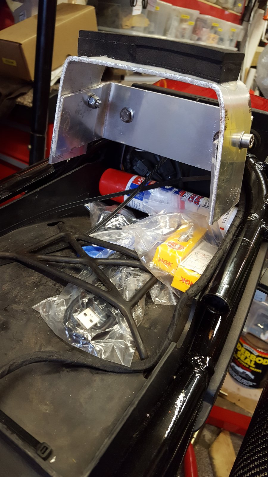

  11. Locating the rear brackets is fun! This was my method. First, I attached the front brackets roughly, and put the front lateral bolts in as a pivot point - this allows the seat unit to raise and lower at the rear. I then stuck the rear brackets on the frame. With this arrangement:
    1) to locate them on the surface of the seat unit I have used a light source to 'project' the shadow of the screw holes onto the inside of the seat unit.
    2) to identify the stand off I taped a bit of paper across from point to point inside the unit and put ink on the top of the brackets. When I closed down the seat unit, this made a mark on the paper.
    I'm going to make the stand off brackets next...
  12. The brackets are made. The stand off was 25mm. I'm just thinking about how to do the glassing in. I might take the rear tray/light/numberplate support off and try to glass these in on the bike. At least I'll know they are in the right place. But its will be a pain.
  13. Glassed the home made rear stand-off brackets in overnight. Did this while it was all located on the bike. Took the rear number-plate, tool shelf off to get access. Not easy to use chop strand mat loaded with resin upside down!
    It is all off the bike again and ready for some more grp work. I just weighed it in comparison to the 2 seater setup. This is 3.8kg with all seats and fittings. The 2 seater is 4.7kg. I'm surprised it is lighter by that much.
  14. Pics of it finished please
  15. Here are some pics of the rough glassed in brackets - i intend to do another layer over this.
  16. Superb set of pictures, hints and tips. Thank you!

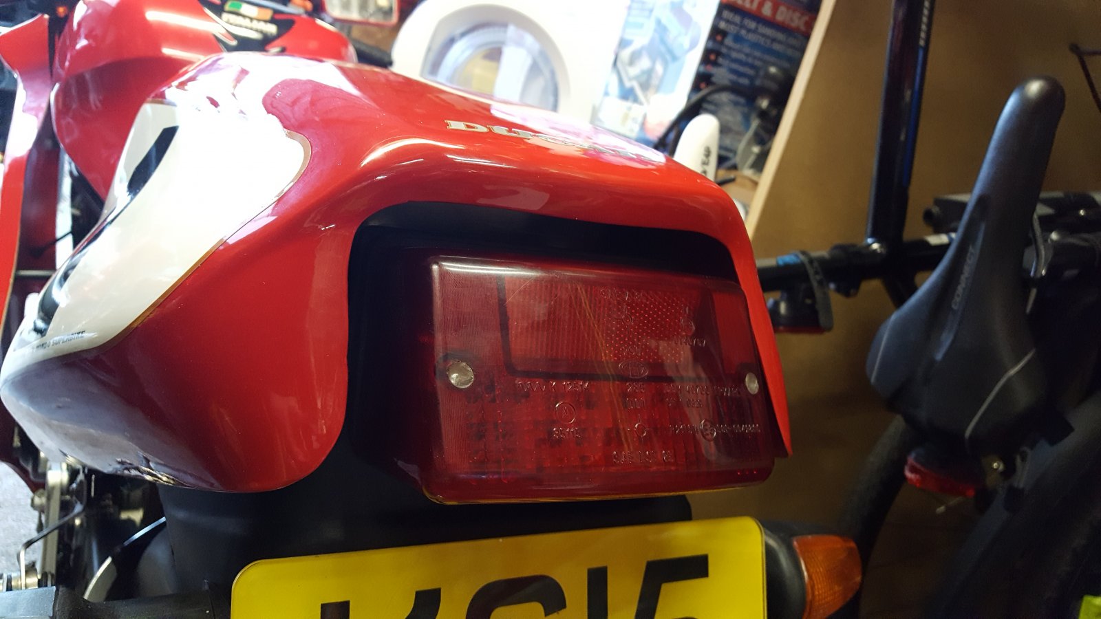

  17. It is finally finished! only 18 months on... My painter had a bit of a nightmare with the stickers. I have described this in other threads. So I finally got it all together today...
    Believe me that the total costs for this make original units at £300 a bargain! if you can find one in the right colour.
    Since I don't have a superlight, and since it is not that light with all the hardware despite six titanium bolts (3.1kg), I have had 'supersport' decals custom made. The white number blank was hand painted by Sarah, as the decal would not lie down flat on the complex curves.
