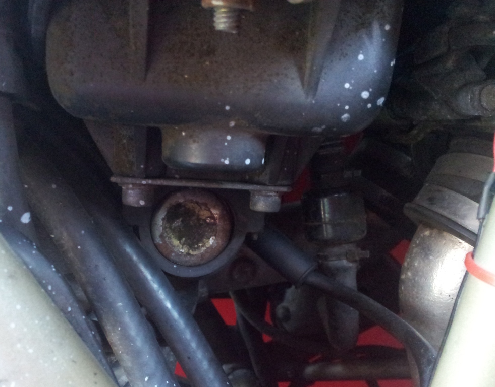

  14. Are you sure its the starter switch?
    The reason i ask is mine is temperamental at starting.
    If all is well you can hear the pump spin up and it will start on the button.
    If i hear no pump i have to fiddle with the round thing in the center of the pic below (taken from the R/H/S of the bike)
    Cant remember what this do-dad is but with a fiddle mine starts :upyeah:
    Like a factory fitted imobaliser NOT
  15. That's the solenoid.
  16. A common fault is that the lead to the solenoid vibrates out, Arquebus very kindly gave me some excellent advice and that is to smear the plug with a little silicon and then plug it back in, it's just enough to hold it in tight.
