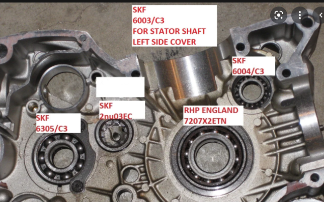

  14. Just to keep information together I thought I would update this thread.
    So, I never got the blanking plates done as they were going to be too over £100 so endind up taking the bearing out.
    I've been looking round for some temperature and times for heating up the casings. I had settled on around 120 deg C.
    As well as "Andy's motorcycle obsession" I watched a good set of video by an Aussie bloke renovating my exact bike - Wayne Pattersons motorcycles Bunbury Western Australia. The videos are under "turbobike" on youtube.
    I think he said he heated the casings to 170 ish for an hour which I though was a bit on the top side both for both heat and time.
    Replacing the bearings I did the following:
    Make sure the wife is out.
    Bearings in freezer over night
    Put casing in oven cold 17 deg C. (using an infrared thermometer)
    Turned oven on set at 150 deg C.
    in 5 mins in was 75 deg C
    in 7 mins it was 95 deg C
    in 9 mins it was 110 deg C
    in 10.5 mins it was 115 deg C
    in 12 mins it was 120 deg C.
    I will double check these figures when I do the other casing.
    At this temp I took the casing out and the bearing just about dropped in ok. The 2nu03EC and 6004/C3 caught up a bit but I had drift ready and tapped them in.
    Thankyou Stoshmonster Ducati.ms for the above picture.
    I think when I do the other side I will give it a bit longer may be 14/15 min and get it to 135 ish.
    On the videos mention previous he coated the outside of the bearings with grease - can anyone explain why?
    Cheers Gaz
