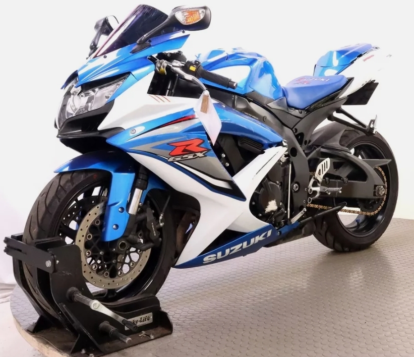

    As i have purchased bikes from MotoMine before, and the black 750 came from a guy who bought it from them, I kept an eye on their Ebay sales pages, and, a few weeks ago, this came up
    Screenshot_20240920_203657_Chrome.jpg Screenshot_20240920_203723_Chrome.jpg Screenshot_20240920_203744_Chrome.jpg

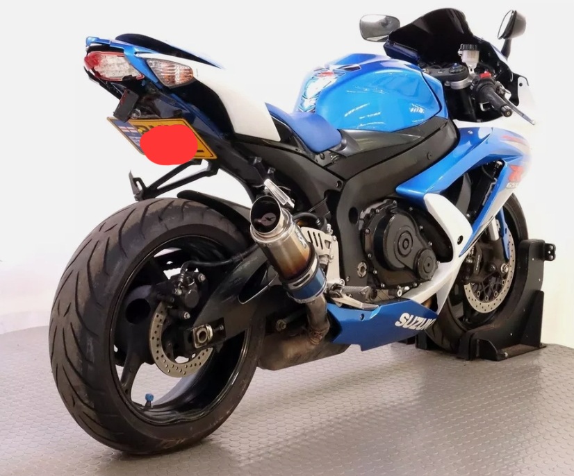

    Looks like it has been rear ended, then gone over on the left side, but, somehow, also managed to bend the slip on end can
    Studied the pics at great length, to see if I could spot any underlying damage, but, all looked OK, although, I did miss the cracks in both rear subframe pieces

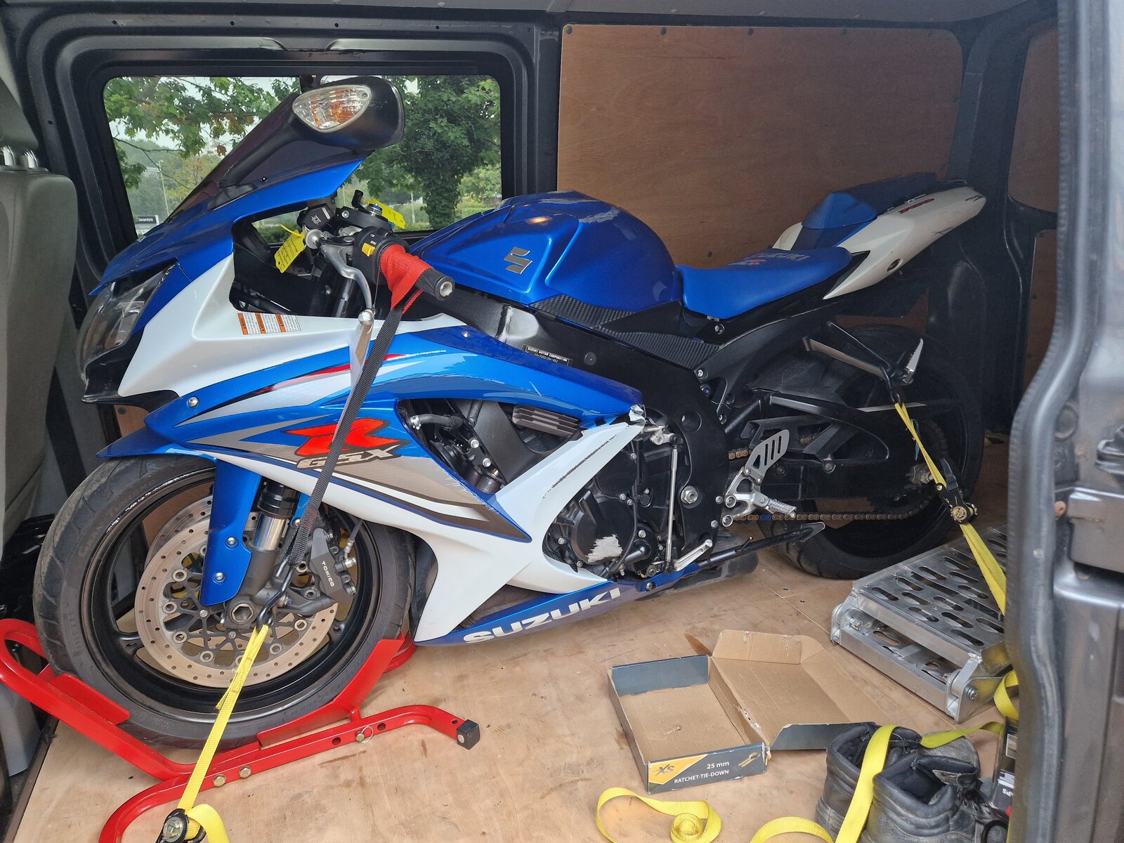

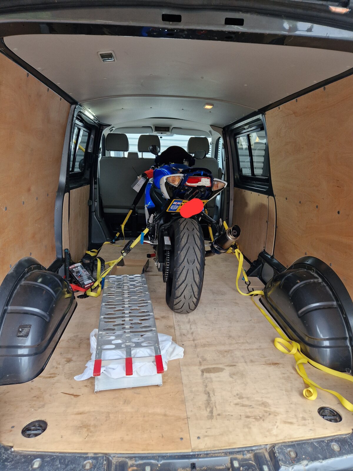

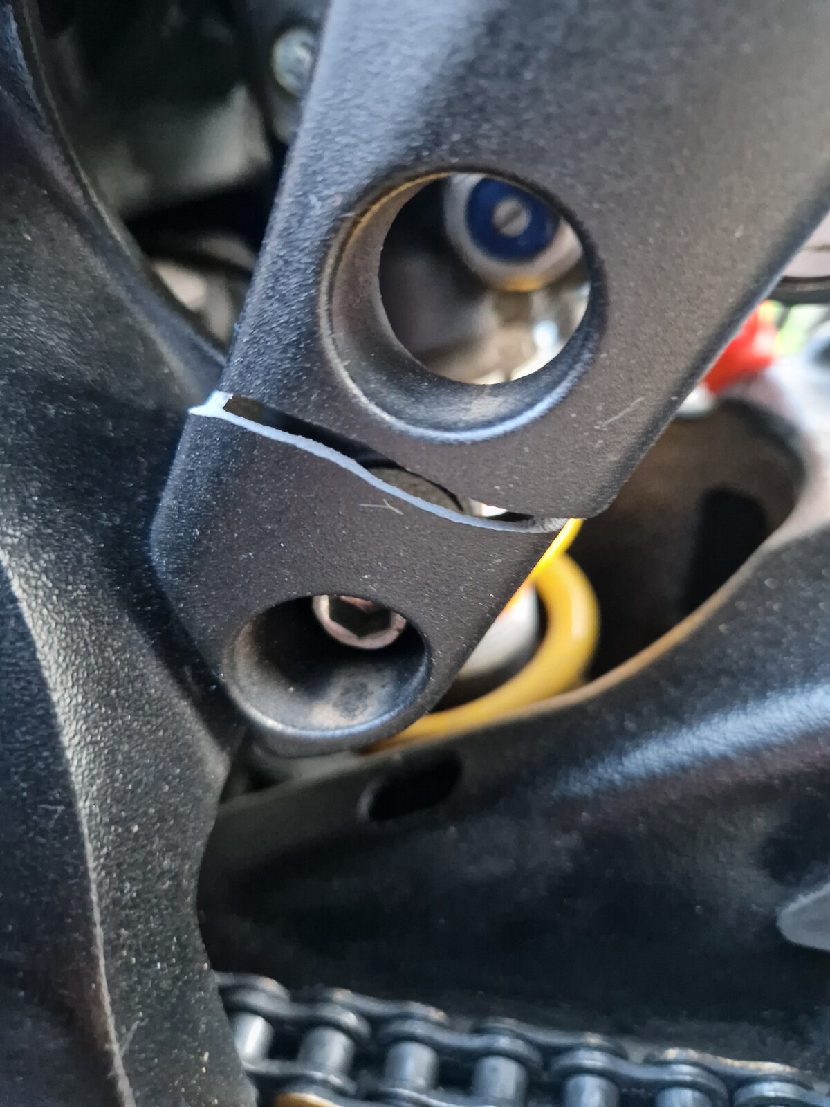

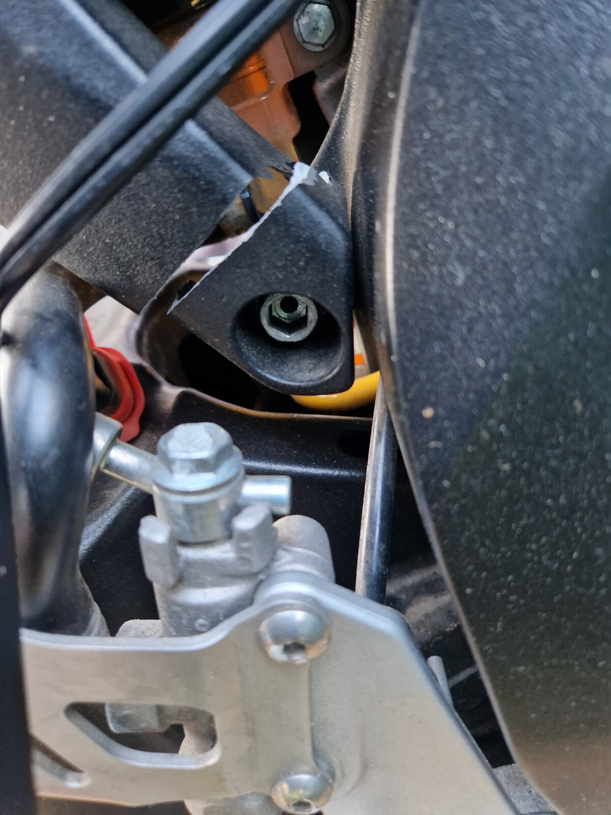

    Once the Gixxer was paid for, the warehouse staff brought the bike out to the van, and I could have a closer look round it, it was at this point, I noticed the broken rear subframes, upon arriving home, I switched on the computer and checked the images, the cracks can be seen, faintly
    And there it sat, strapped in the back of my van for a week while I was at work

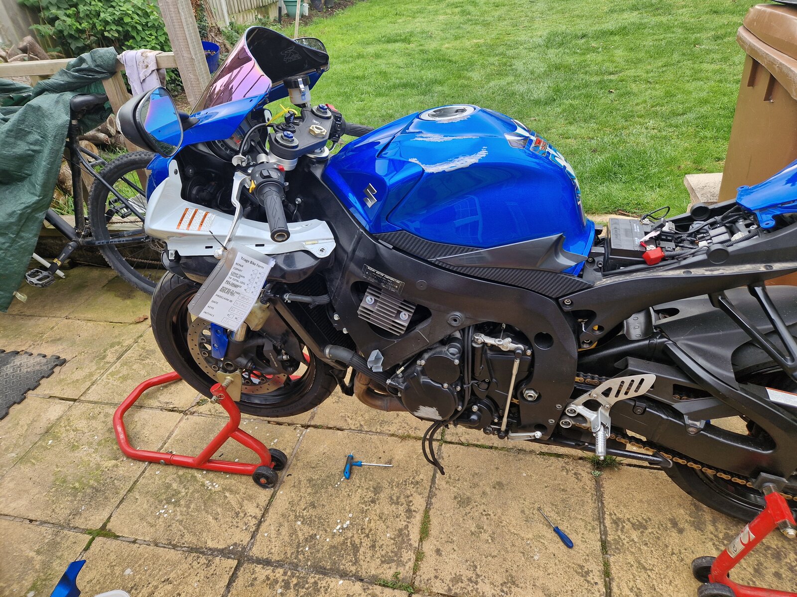

  4. Well, after I got the bike home, I had a good look over it, to try and work out exactly what parts were needed
    Rear subframe on both sides cracked
    Gear lever snapped
    Headlamp/clocks bracket broken
    Rear wheel Buckled
    And, a full fairing kit
    Fuel tank to be repaired
    Hopefully, it won't look too bad once the dress is removed
    Scoured the Bay of Fleas for the parts, acquired both OE subframes and the wheel rim as used items, the headlamp/clocks bracket and the gear lever were new aftermarket items
    After a couple of days, the parts started arriving, it appears that MotoMine also have a used parts side to the company too
    Had to wait a few more days for the gear lever to arrive

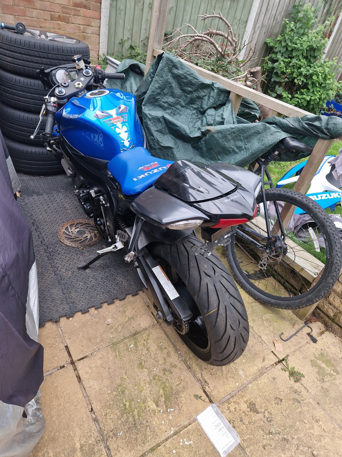

    First thing was to remove the rear wheel, and get the tyre changed over, to make the bike a bit easier to manoeuvre around
    Pretty sure that the axle block should be up against the tensioner bolt.....
    Tyre changed, the guy at the shop asked if my son had "borrowed" one of my bikes, and had a mishap, to which I replied, "do you think I would be standing here if he had?" :joy:
    Wheel refitted, fired the bike up, dropped it in to 1st gear, I think the disc that came with the replacement wheel has a slight distortion to it, so, it needs to come off and be changed :pensive:

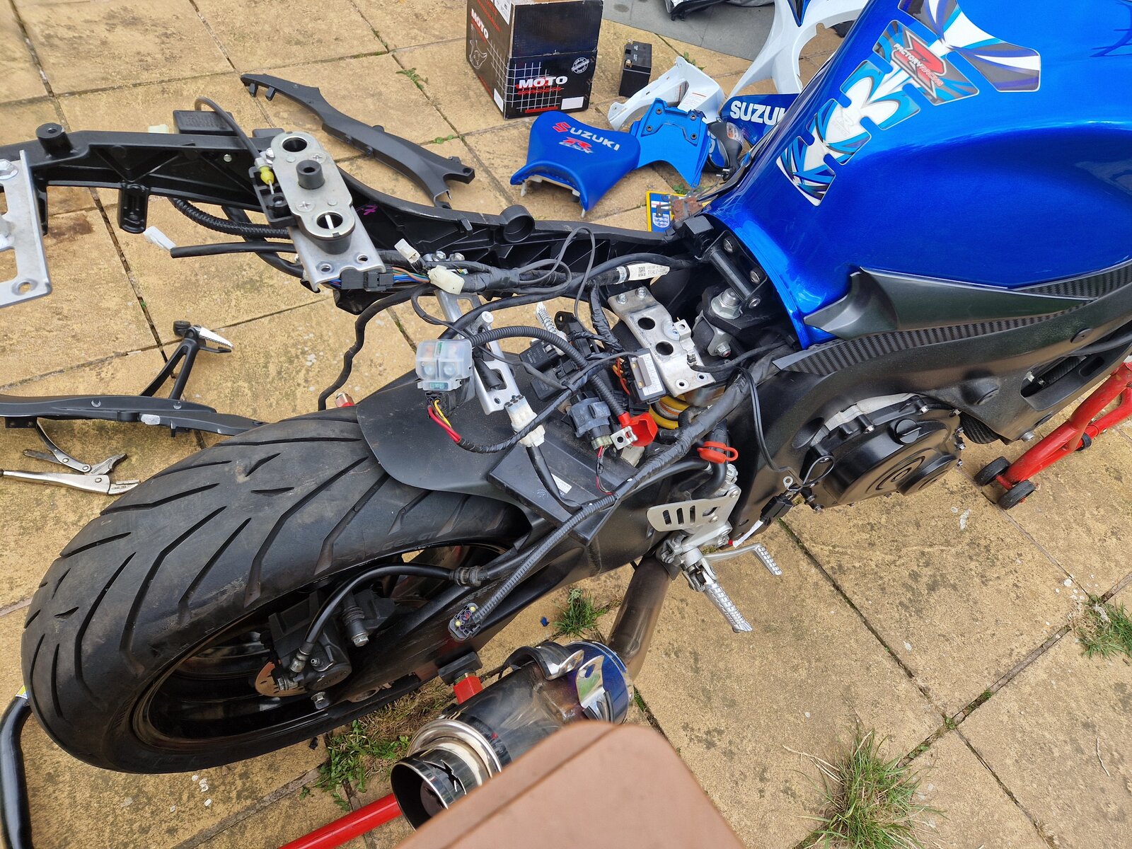

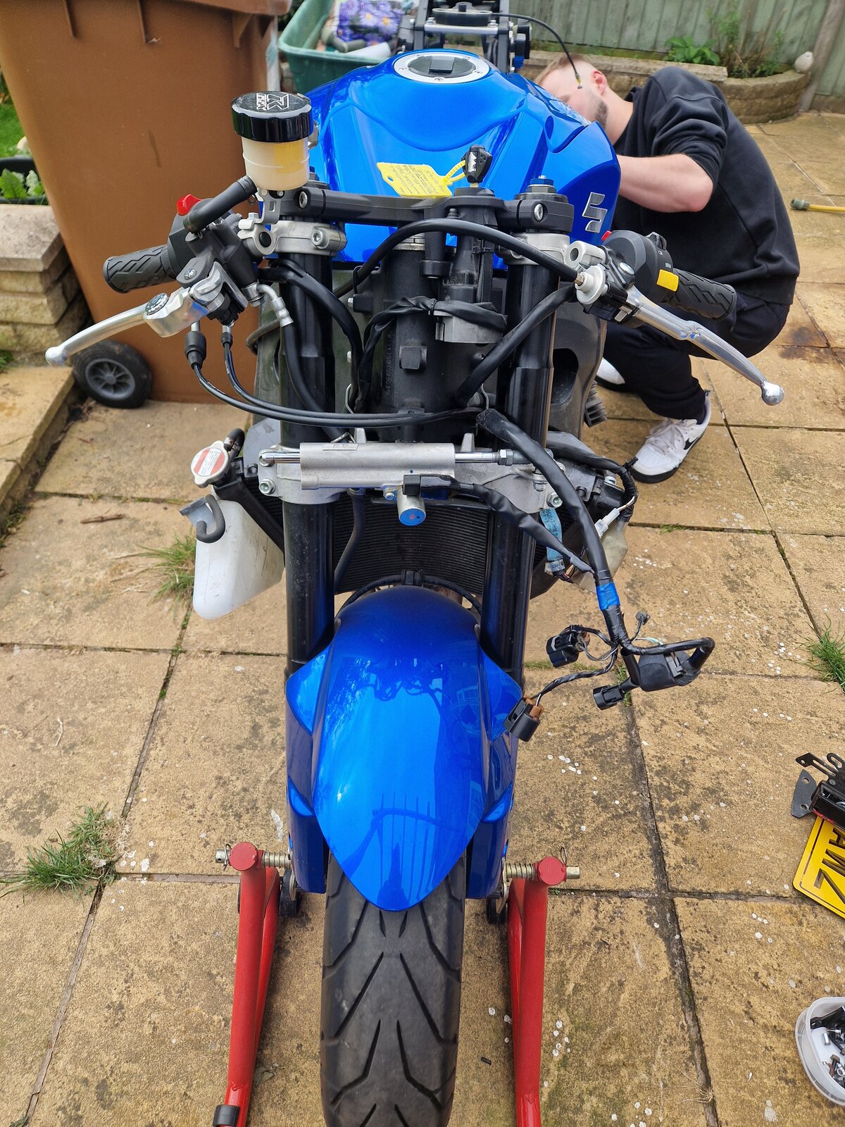

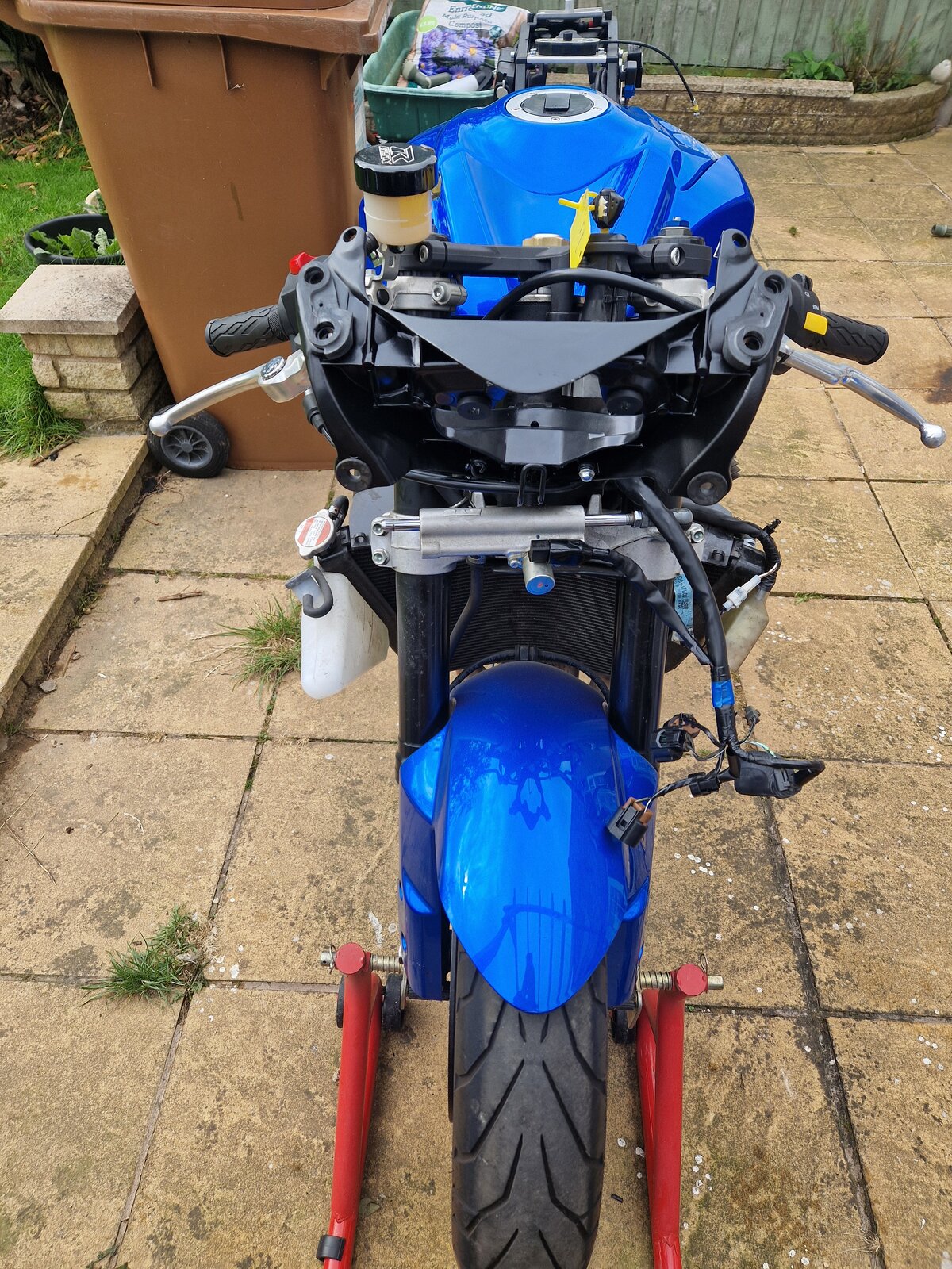

  10. The strip down started in earnest after lunch
    20240927_182528.jpg 20240927_182539.jpg 20240929_122323.jpg 20240929_122329.jpg 20240929_124448.jpg 20240929_125925.jpg

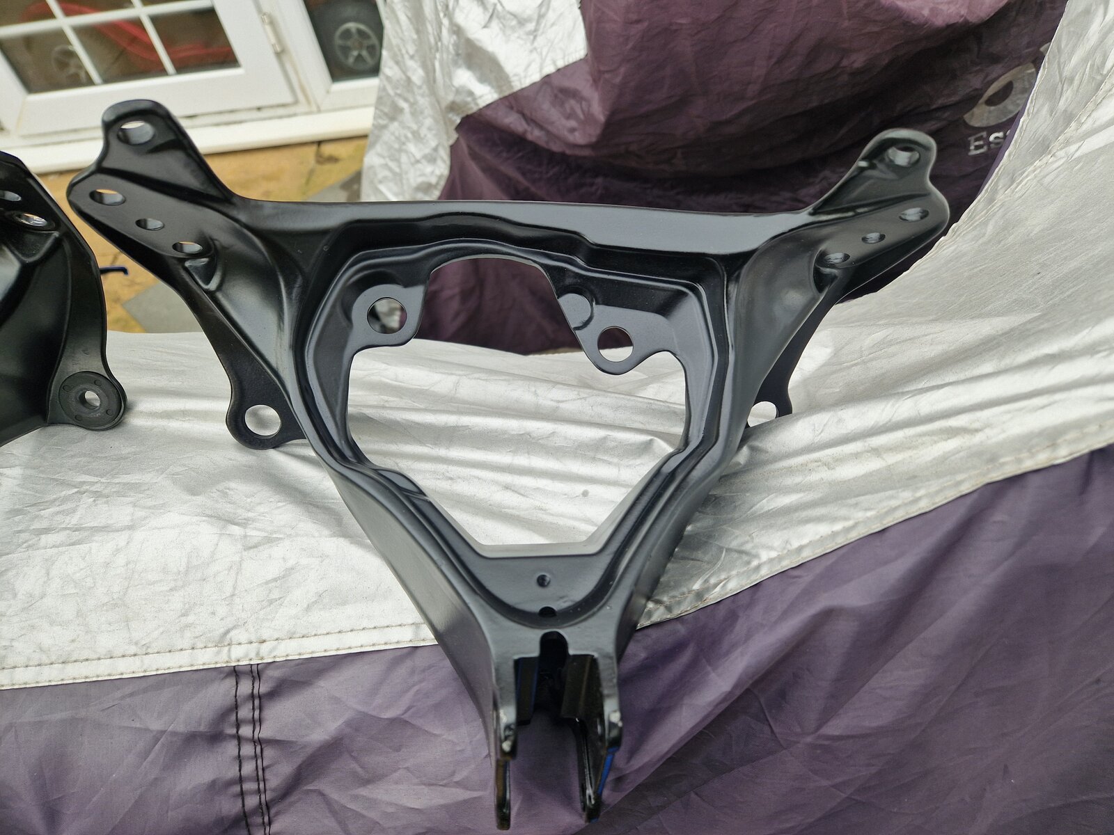

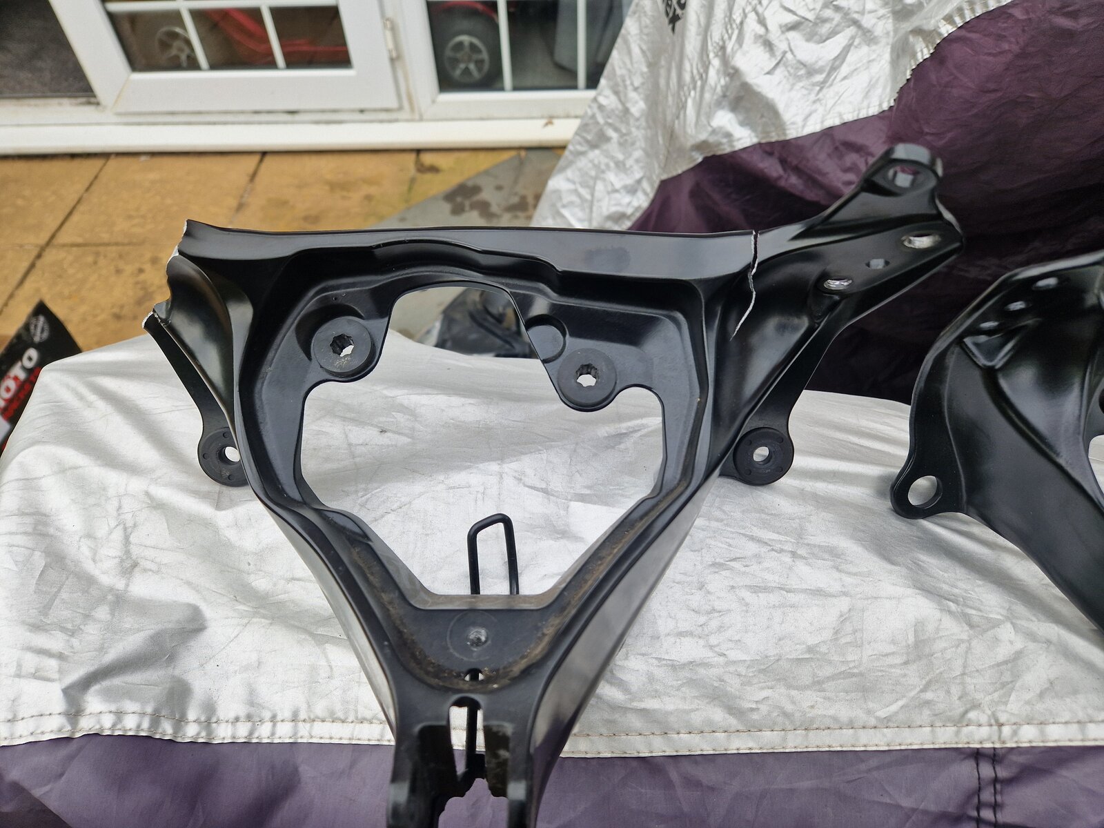

    Comparing the old and new headlamp/clocks bracket...
    Decided that was enough parts removed for now, time to start refitting some new parts, but first, coffee.....

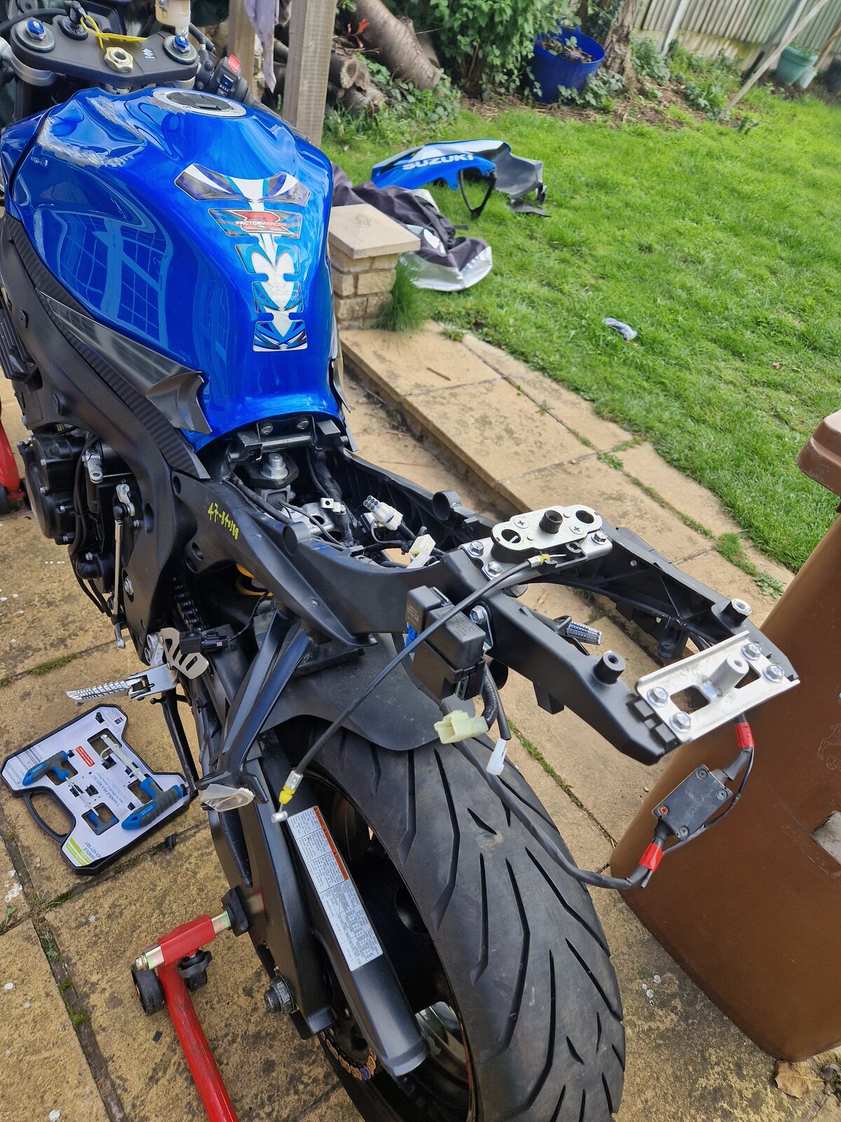

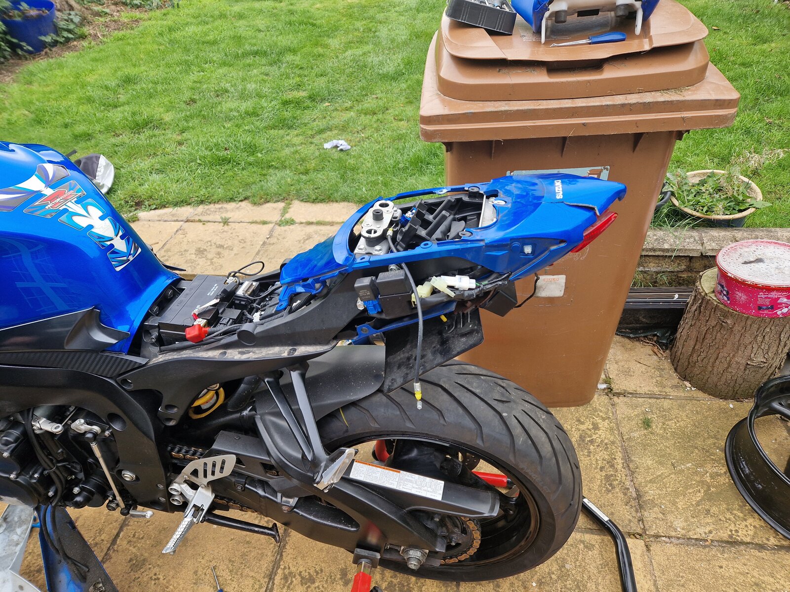

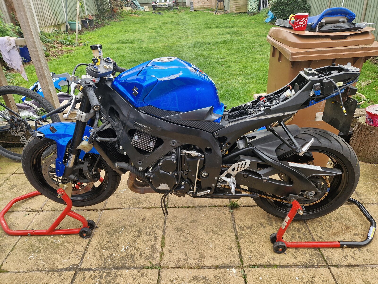

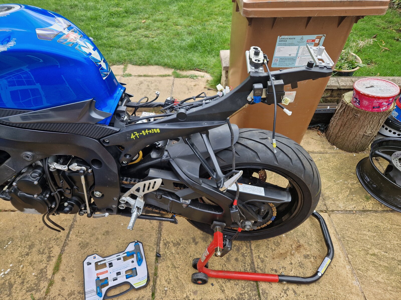

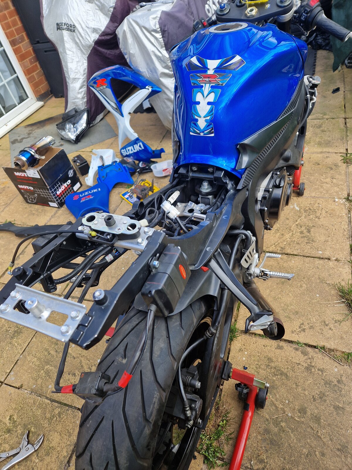

    The rear subframe was replaced one side at a time, to try to make sure everything went back together as it should, need to get the yellow item number off the left piece, that will be something for him to do
    20240929_133259.jpg 20240929_133307.jpg 20240929_133313.jpg 20240929_143957.jpg 20240929_144000.jpg
    The black plastics were fitted just to make sure everything lined up as it should, as he eventually decided that he would like to keep the original colours
    So, now he has decided to keep the original colours, the order has been placed with MFS for a full fairing kit

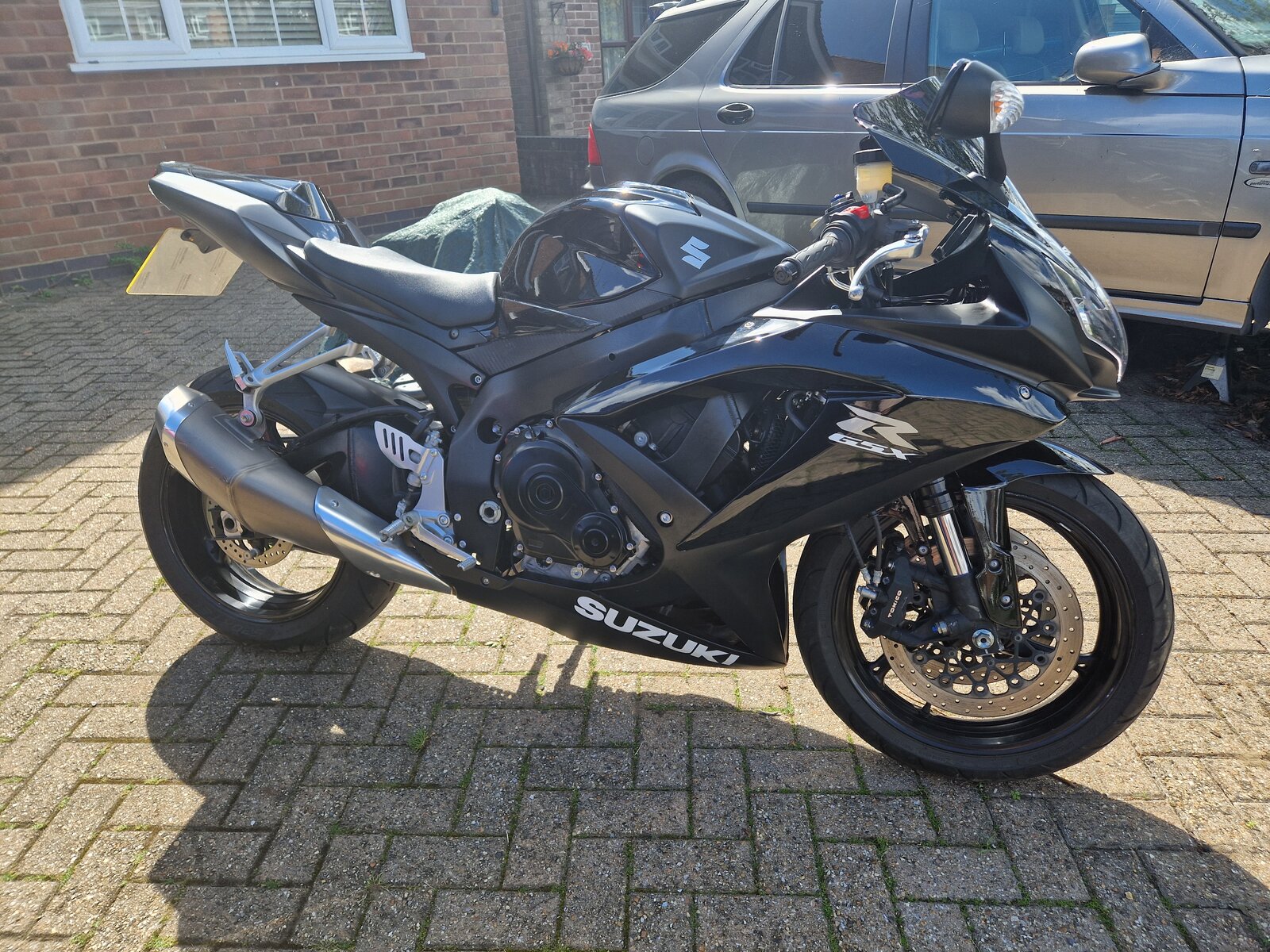

    I have purchased a full kit from these before, for the black K8 750, I was impressed with the quality and fitment of the panels, each individual panel is a copy of the original, and any panel can be interchanged between OE and aftermarket

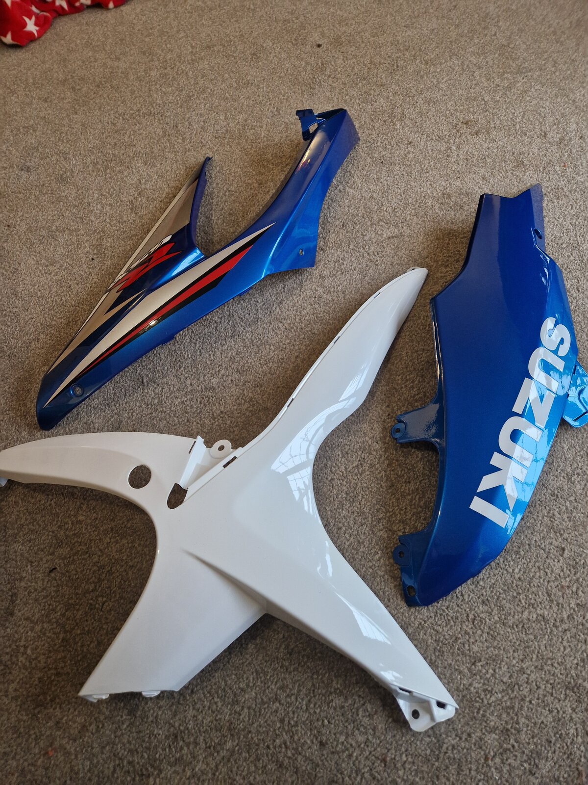

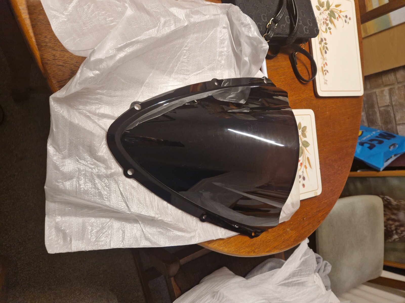

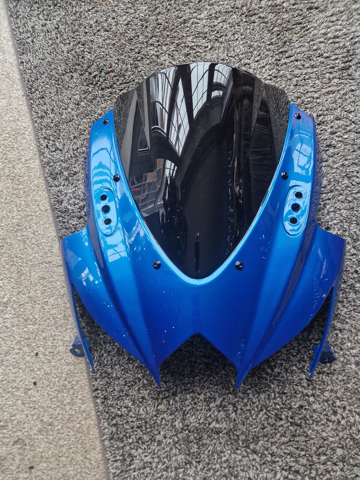

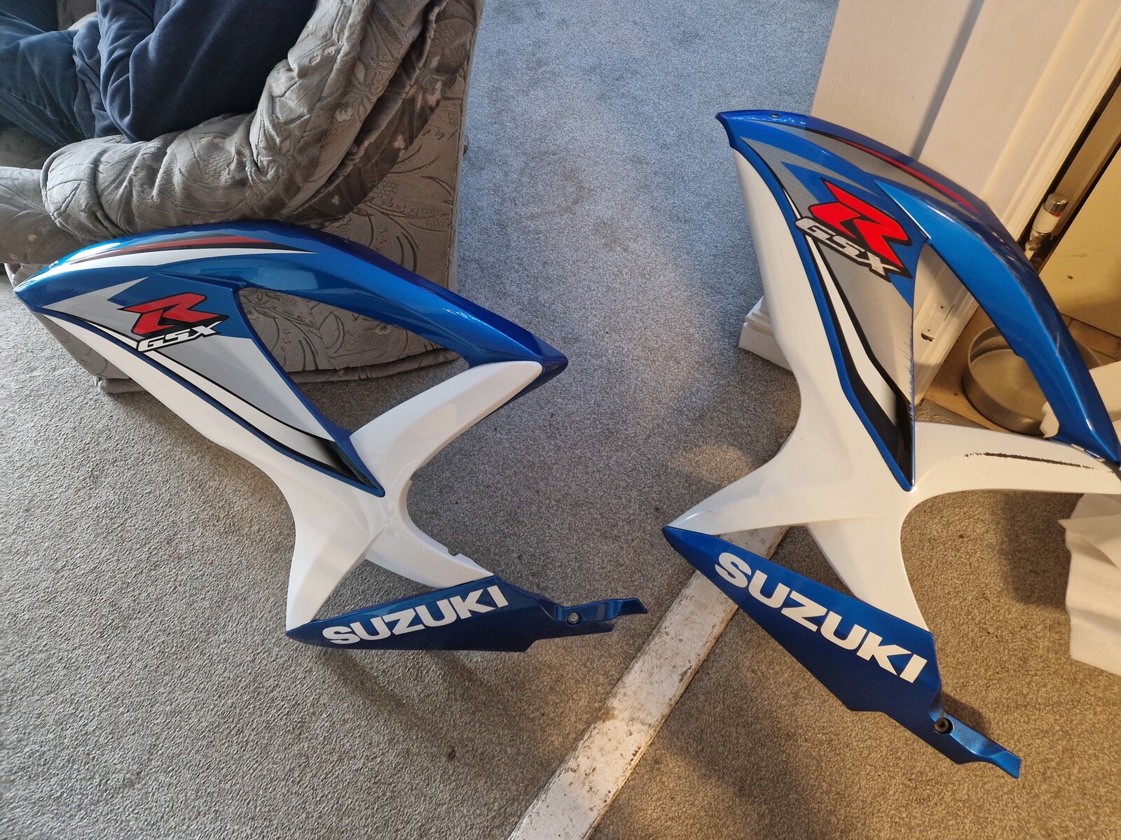

    The fairing kit arrived early November, decided that I was nit going to do anything with it, the boy can do it :D
    After 5 or 6 weeks of him not having the time to come down and do anything with the bike, I decided to start on the fairings myself
    20241226_083949.jpg 20241226_084012.jpg 20241226_084754.jpg 20241226_133011.jpg 20241226_140249.jpg
    Comparison between old fairings (right) and new fairings (left)
    Had to keep stopping, as i have not been well for the last few days, the dreaded Man Flu has took hold :mad:
    Even little jobs like building the side fairings are knackering me out :pensive:

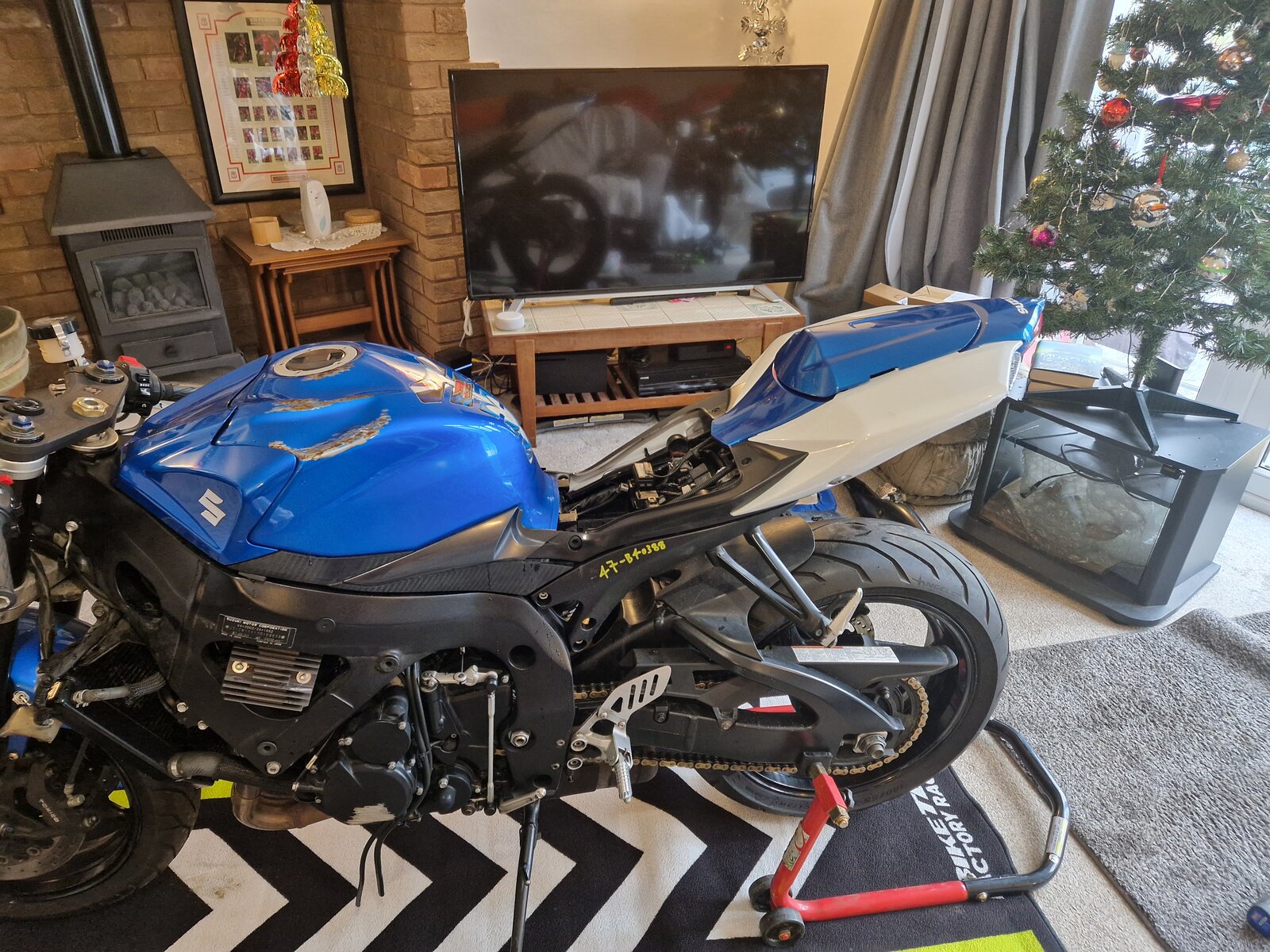

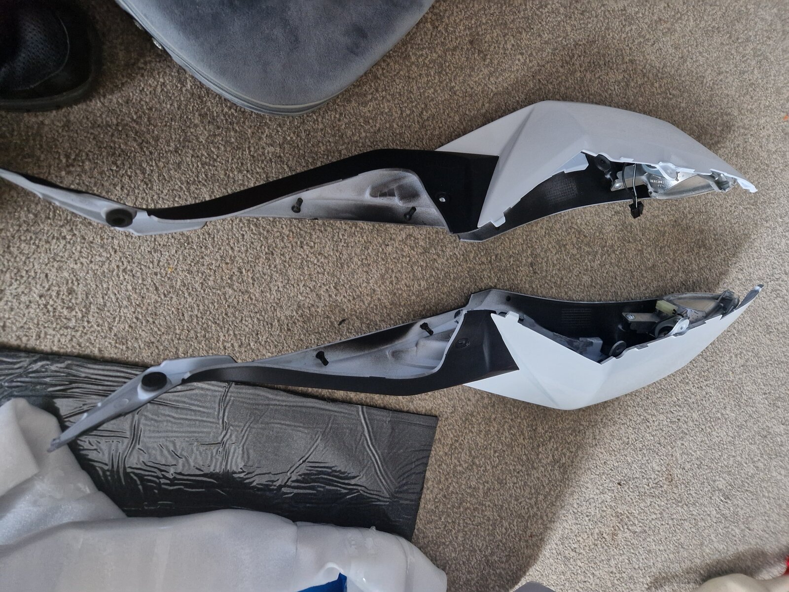

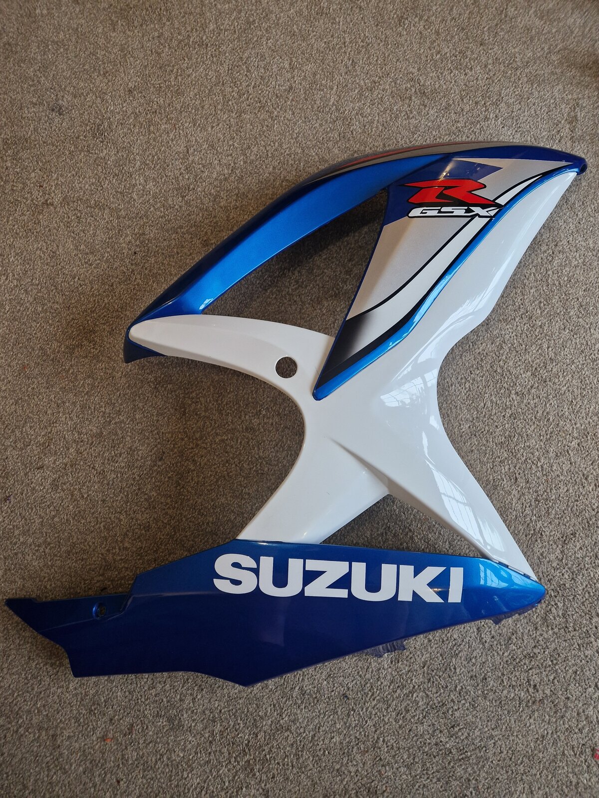

  15. Got a bit more done today, first of all, fitted the right side fairing parts together, for some reason, it was a lot more difficult to do than the left side
    Next was to swap all the rubber grommets and fixing brackets from the old tail pieces to the new ones, and loose fit them to the bike, after a couple of attempts, they fitted pretty well, it does help if you get the locating dowels in the correct places :joy:
    Once correct fitment was achieved, secure the panels to the bike
    Starting to look like a bike again now :D
    At this point, I was starting to feel drained and breathless again, so, time for a break

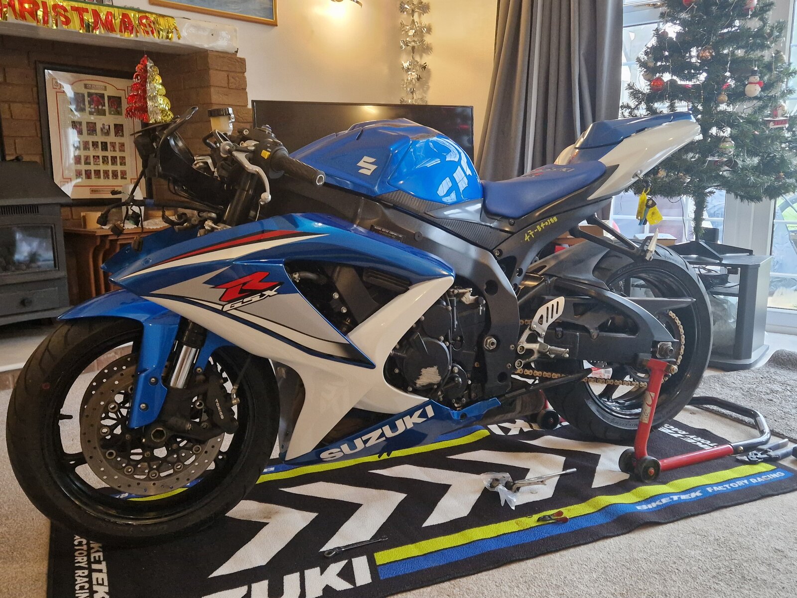

    After lunch, I decided to loose fit the front end, just to see what it would look like when finished
    Need to find where the son has hidden some of the other parts,such as the intake tubes, headlight, and some of the fixings
    That's it for today now, still not really feeling it yet:sweat:

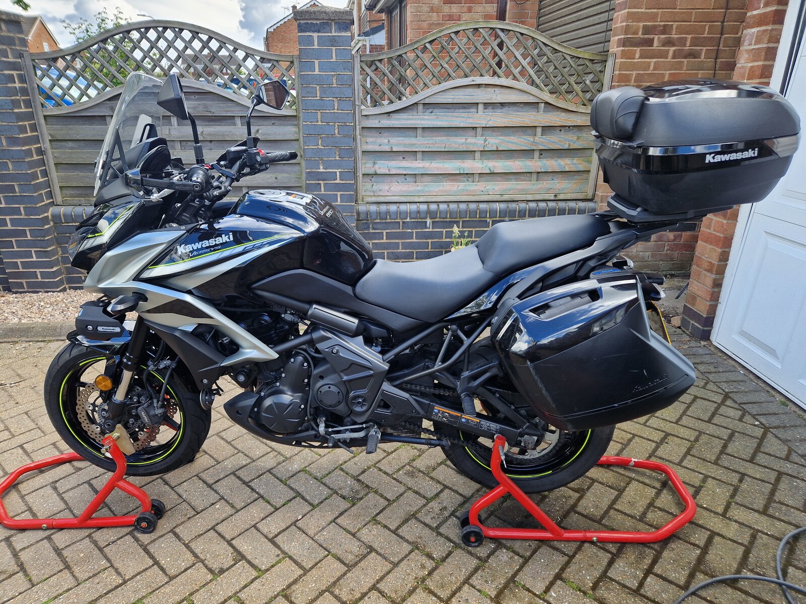

  18. As a rough guide, I bought this from the same company earlier this year, paid £3003
    2019 Kawasaki Versys 650 with full touring kit
    Bought all new, genuine parts from my local kawasaki dealer, all fixed, serviced, full 12 months MoT, still only stands me at under £3900
    As a comparison, the same dealer had a 2018 model, slightly lower mileage, at £6200
    It all depends on the bike, and the damage you don't see in the pictures

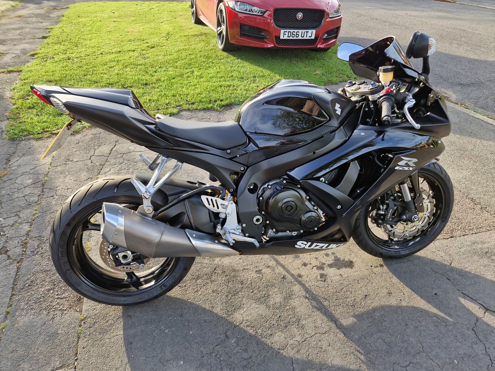

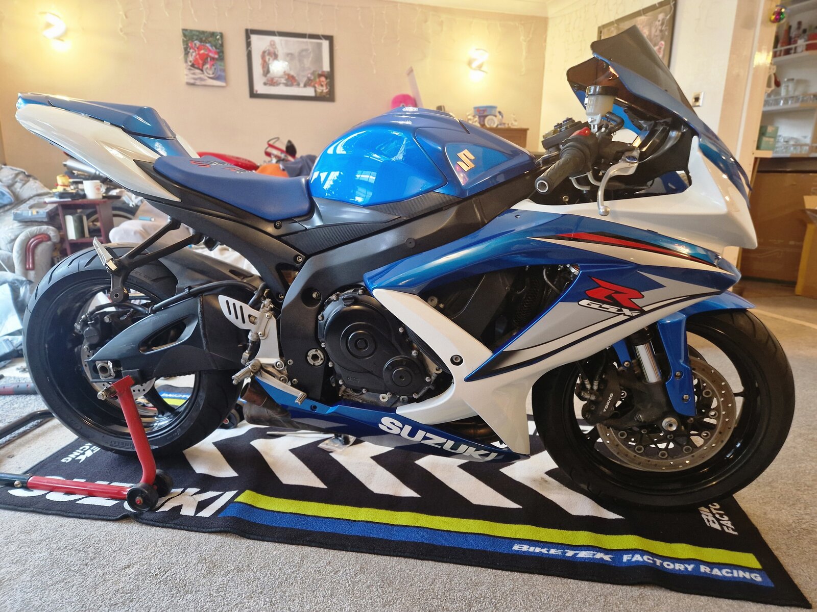

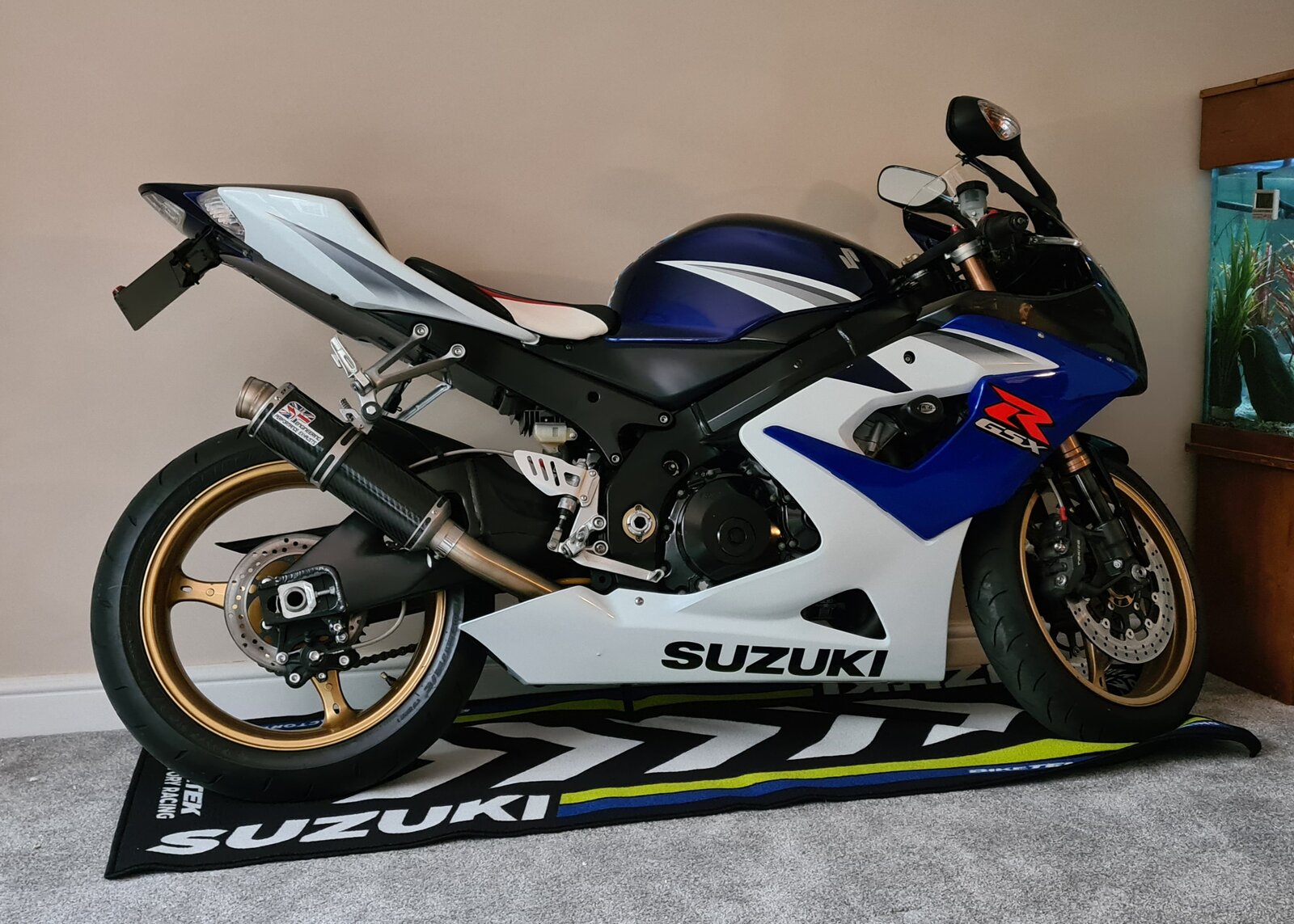

  19. This one, I made about £500 on it
