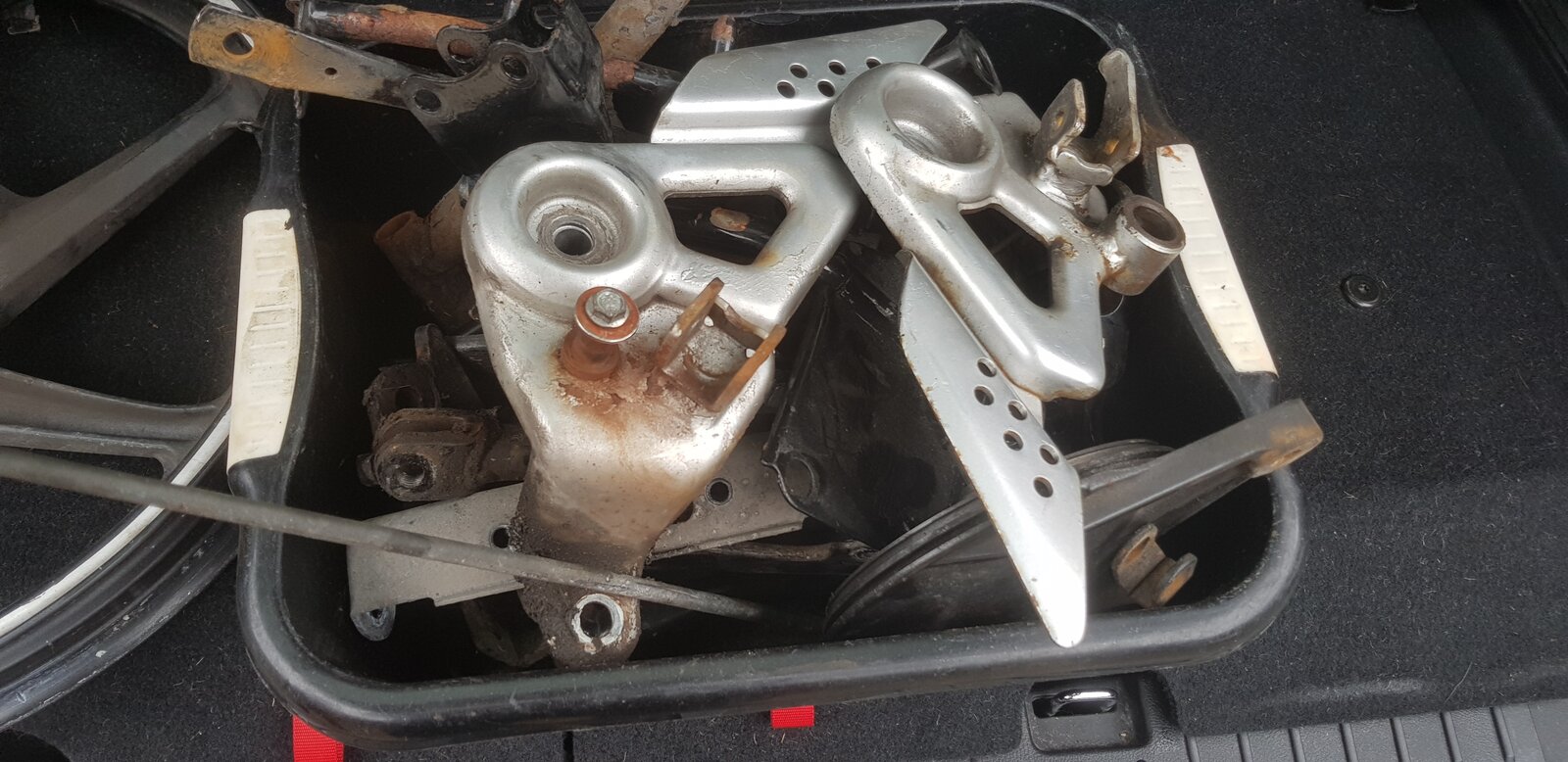

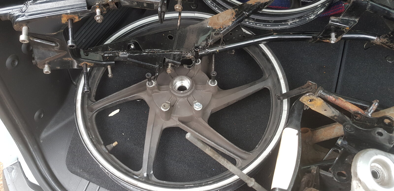

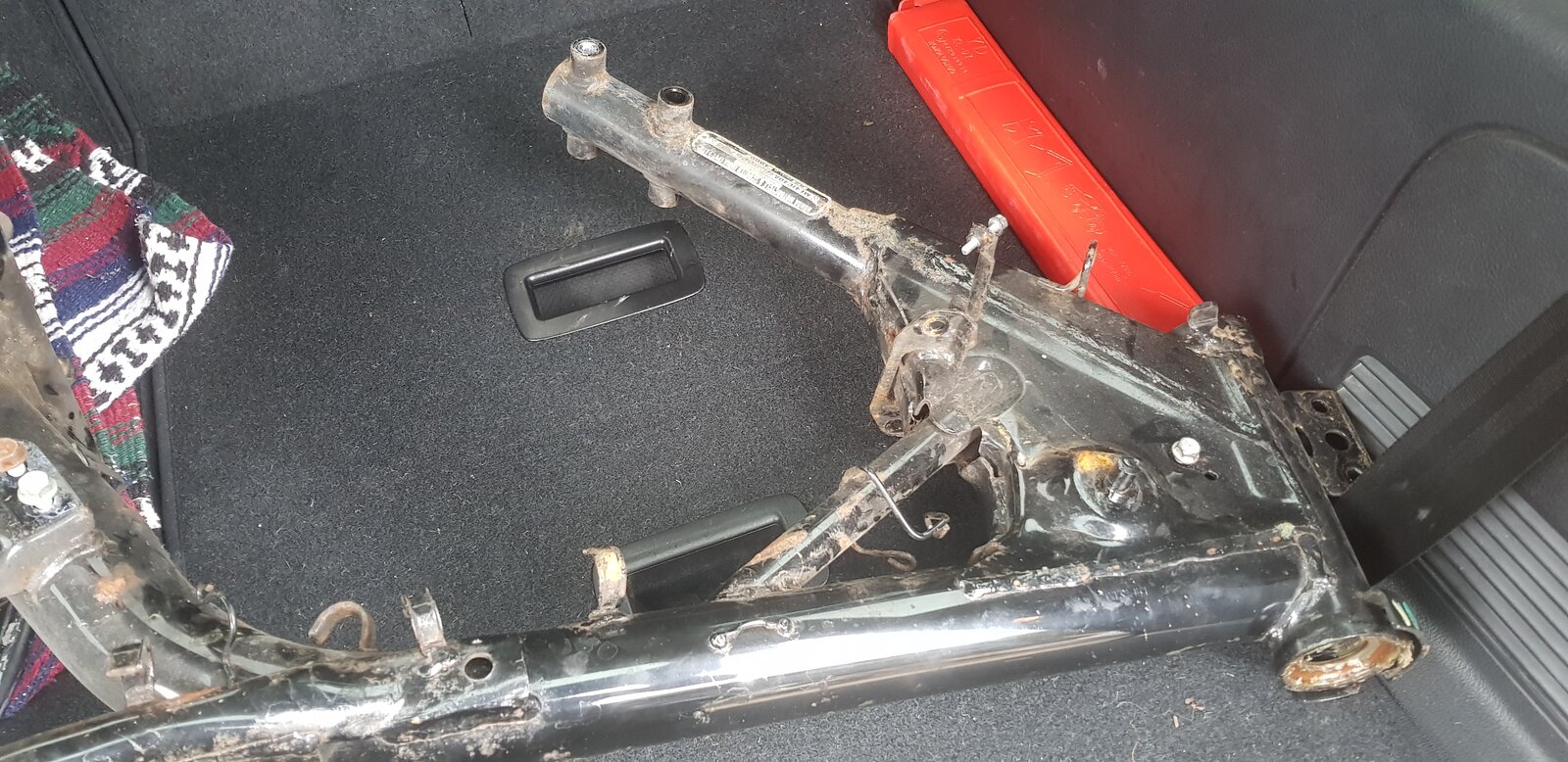

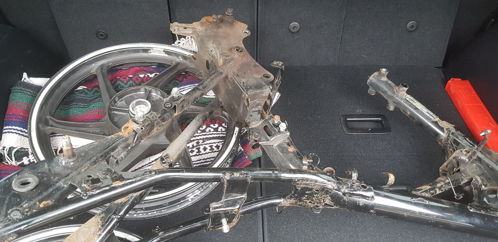

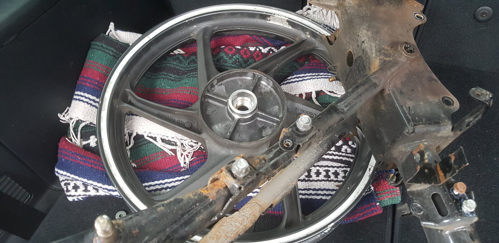

  1. Heres the boot of my car.... Just dropped it all off bar the swing arm.. Got one bush out but almost put my hip out on the 2nd one... Just soaking it in wd40. .
    20190318_143933.jpg 20190318_143934.jpg 20190318_143930.jpg 20190318_143937.jpg 20190318_143940.jpg

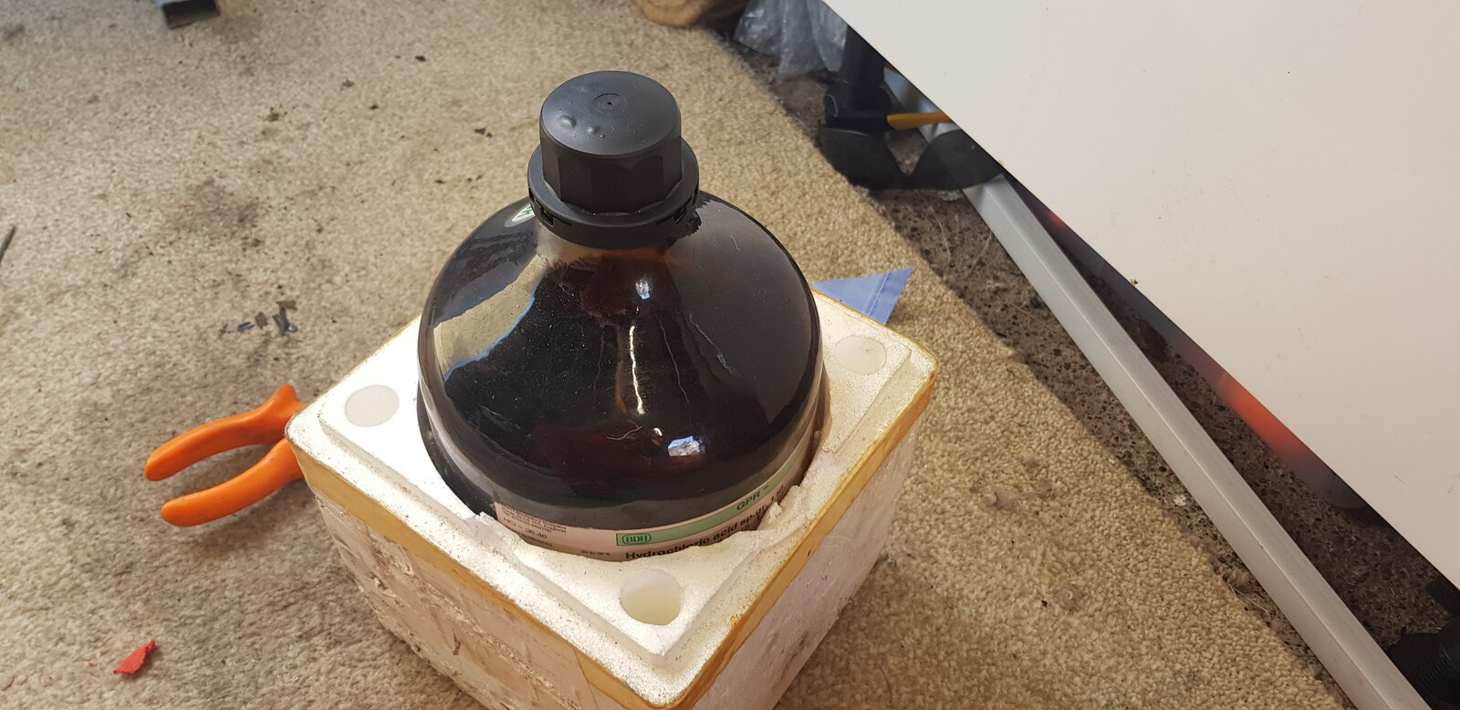

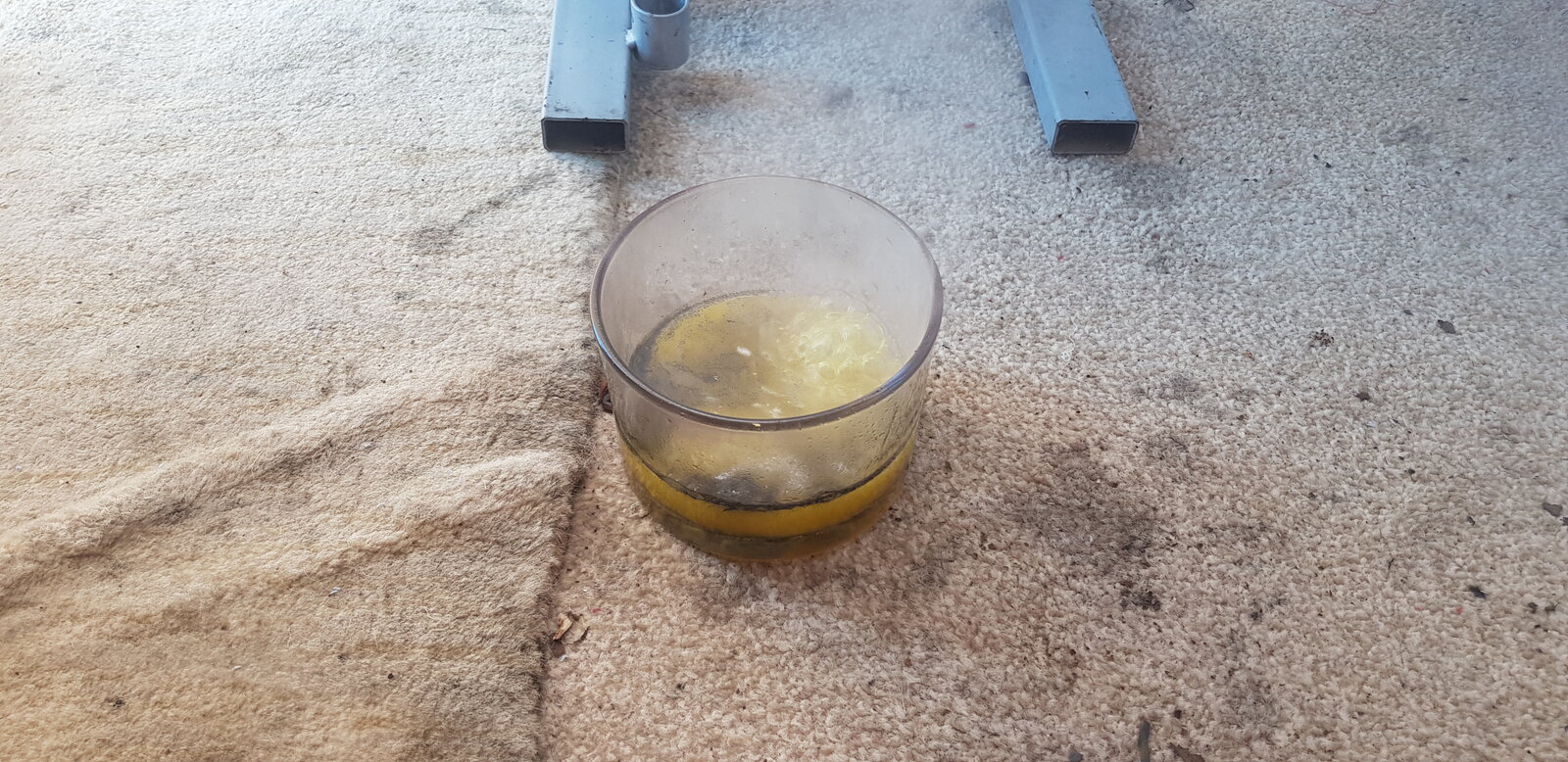

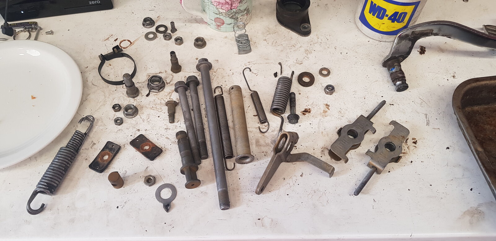

  8. Too nice to be in so... Whole the bike is in multiple place around the city the leftover bits are getting cleaned... Got a bottle of fuck off strong acid so all these bolts... Were covered in rust...

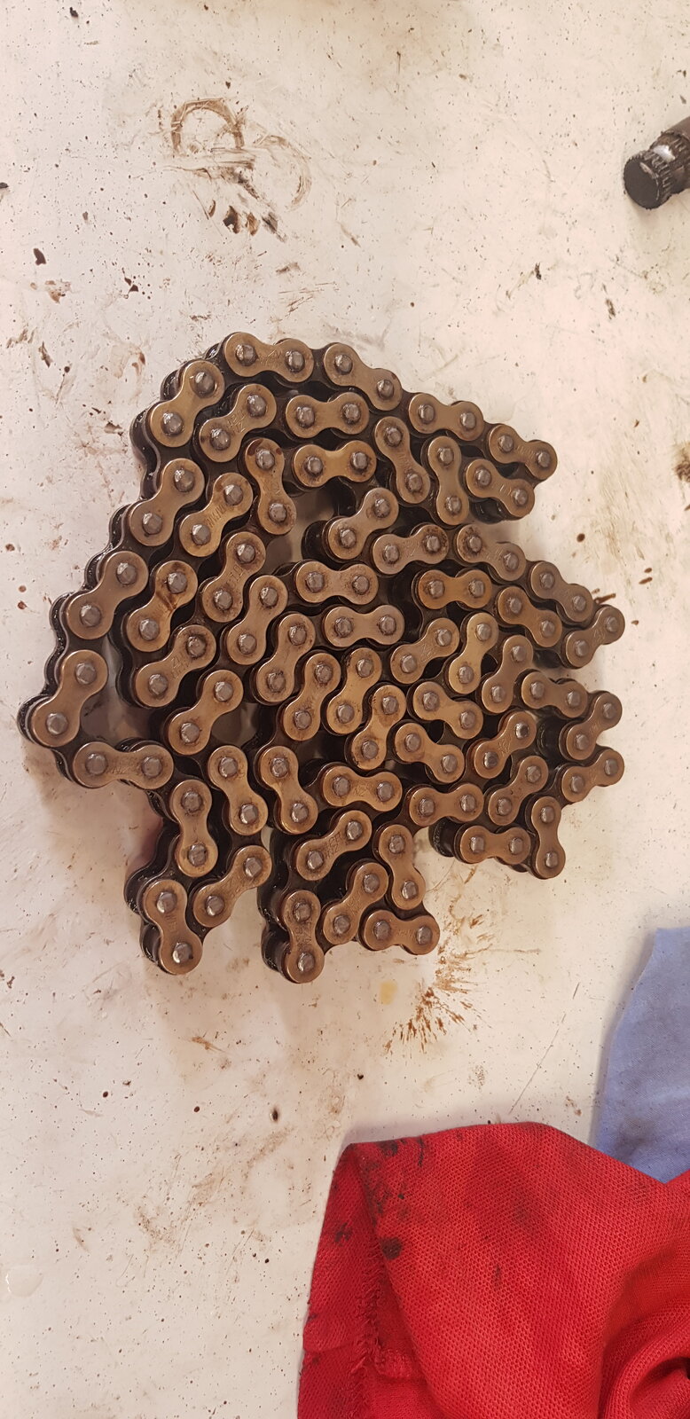

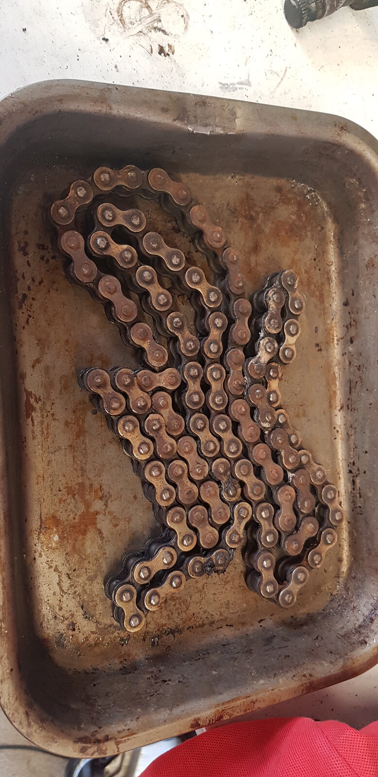

  9. 10 mins with a wire brush, Sdoc100, hot water and some wd40 the chain is clean..

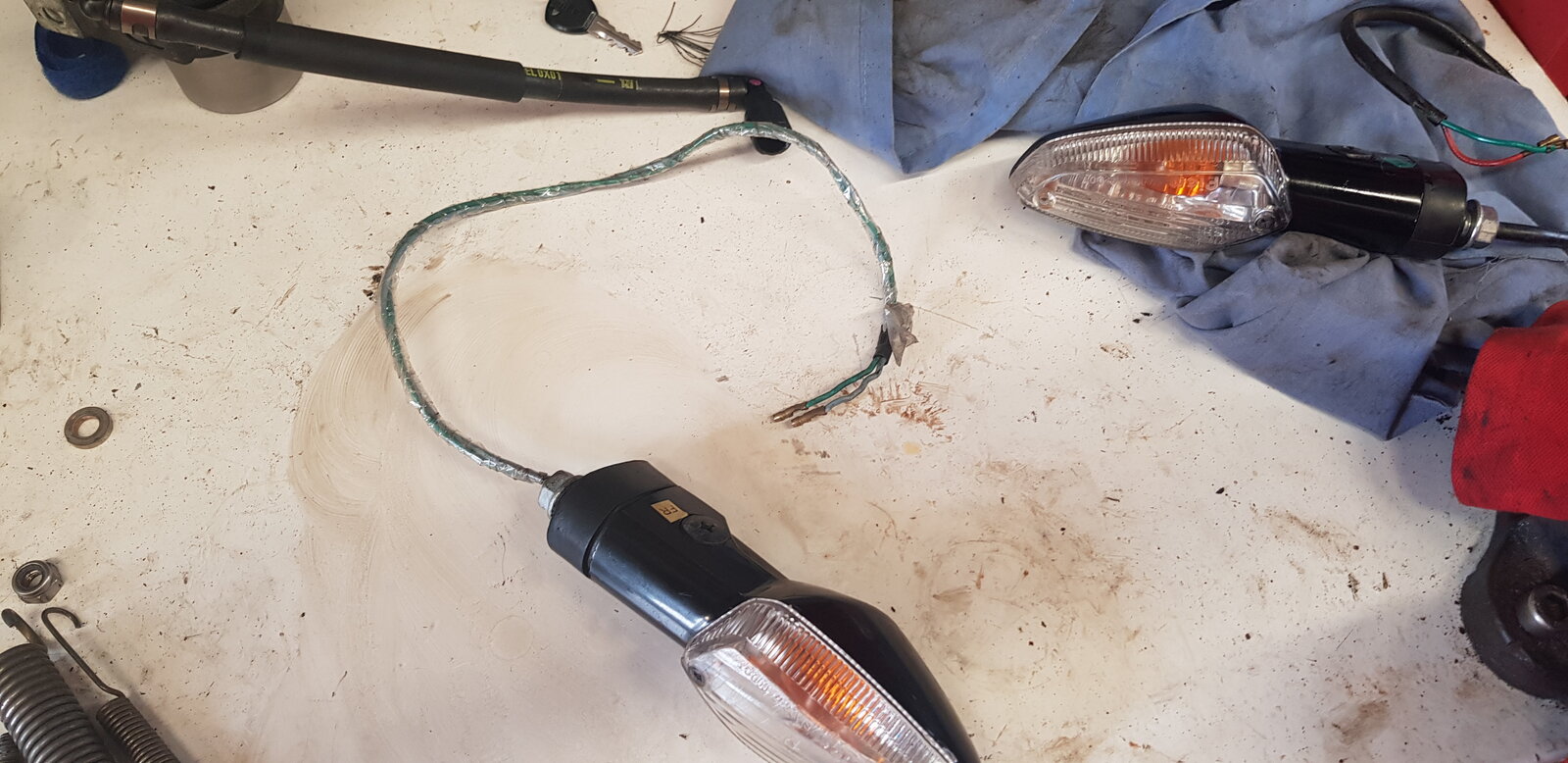

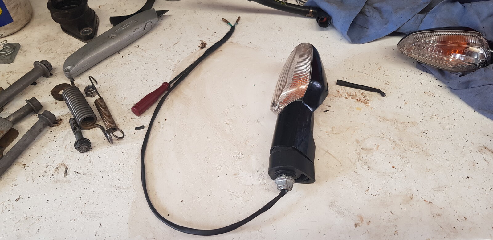

  10. Sellotape used to wrap cabling... Awesome...

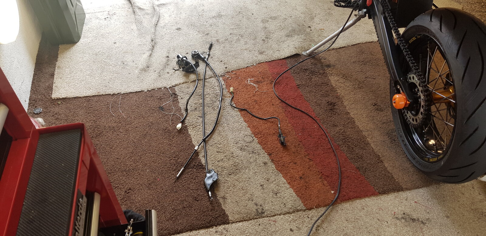

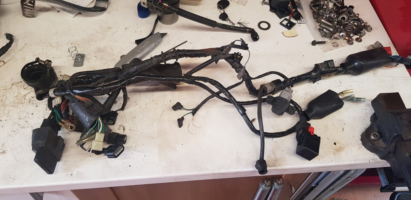

  11. Made a start on cleaning stuff... Cabling first... 15533423013875375667390836673031.jpg
  12. Impressive - what acid??
  13. Indicator resealed with heatshrink and amalgamated tape at the connector end to seal it.
  14. No idea... Wife brought it home years ago (she used to work in a lab) needless to say you can't use it indoors unless you have breathing apparatus (I really mean that) Hydrochloric .. And its got an "8" on the bottle...
  15. Drain the acid from a scrap battery into a glass bottle/jar. Use it for the same purpose. A weak solution is brilliant for removing rust from the inside of petrol tanks

  16. Ideas on tidying up the main loom?... Its ok... But scrappy... 15533454120966115963901858879432.jpg
