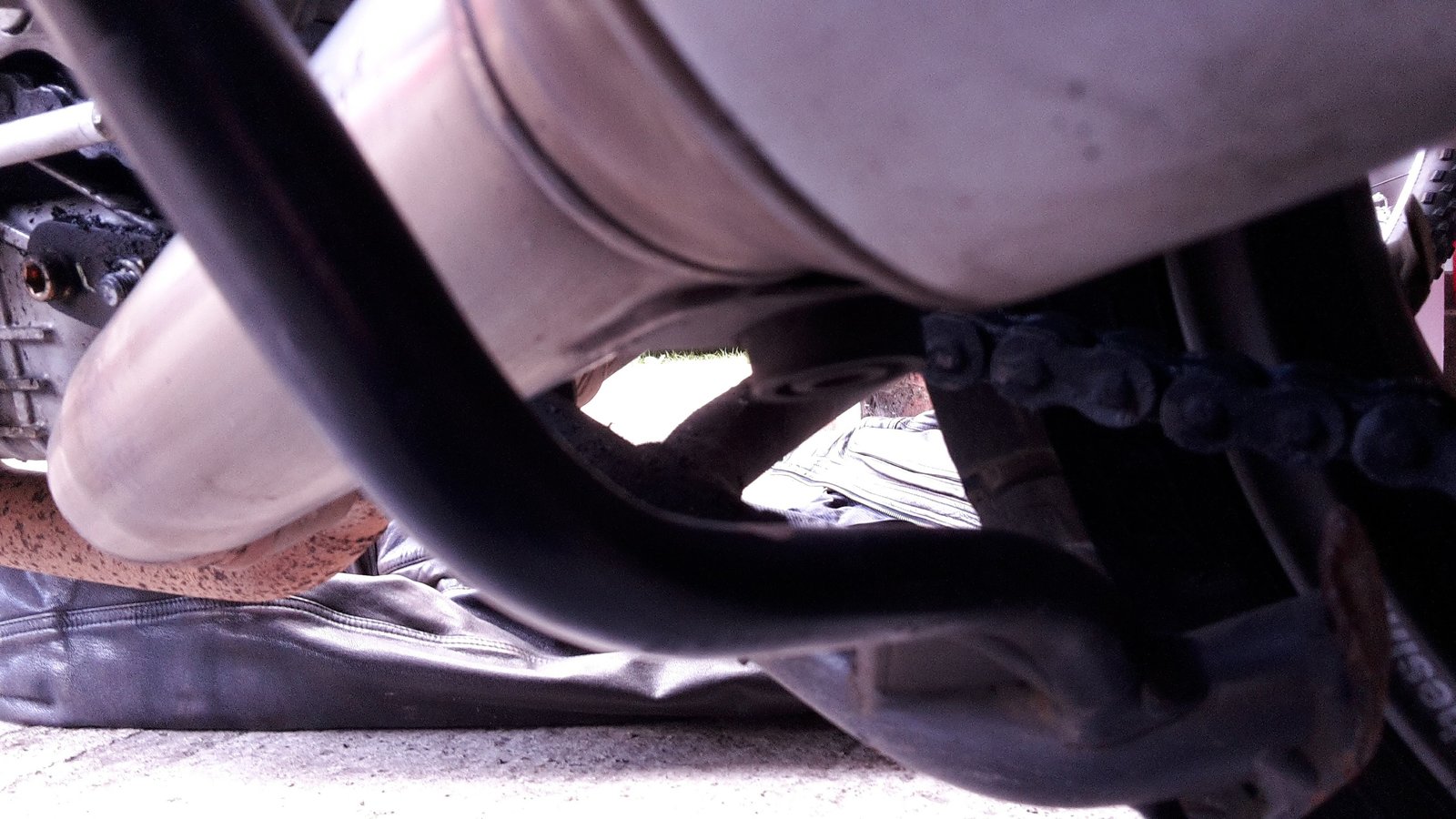

  15. Firstly ride height. I have just 1/2 inch ground clearance at the back.
    The mainstand hangs at least an inch below the stop on the silencer. Clearance.jpg

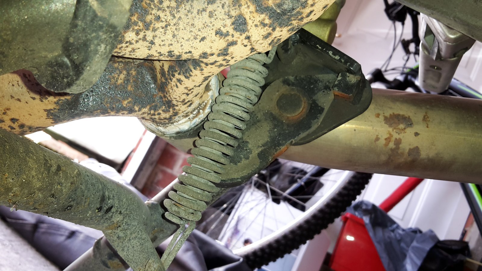

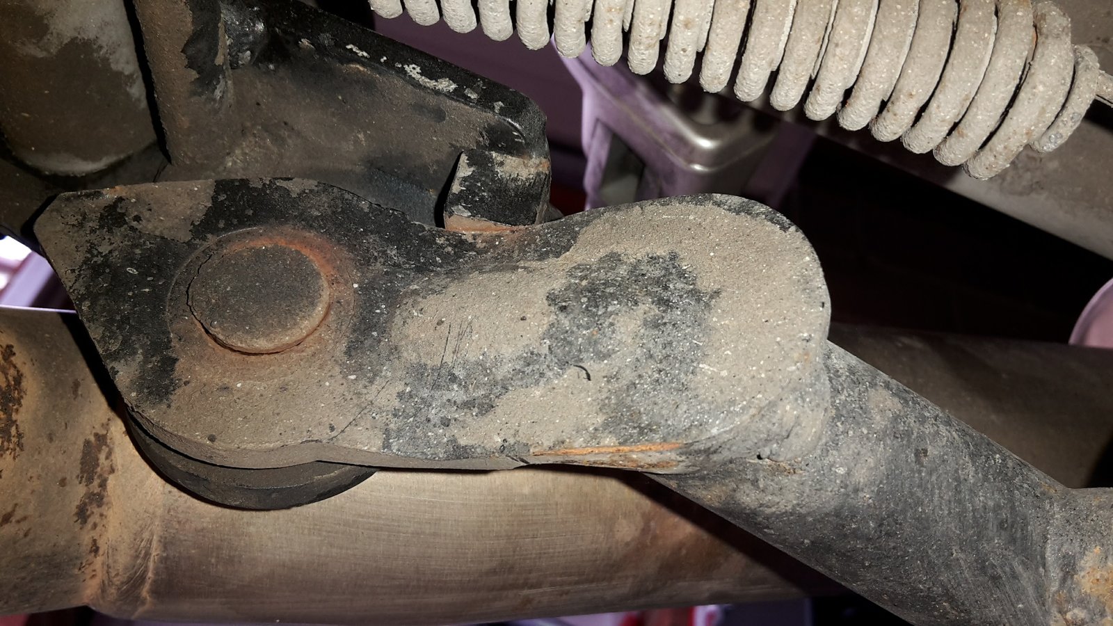

    The stand stops against the metal cube on the stand frame when in the up position..
    And on the other surface of the same stop in the down position
    This metal stop is on both sides of the stand frame. Two springs present as can be seen.

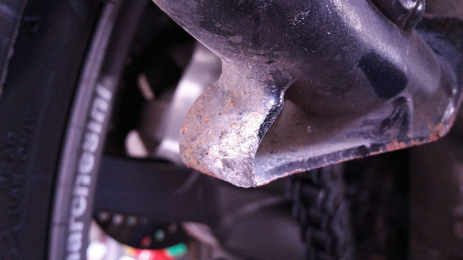

    This is how the stand is grounding

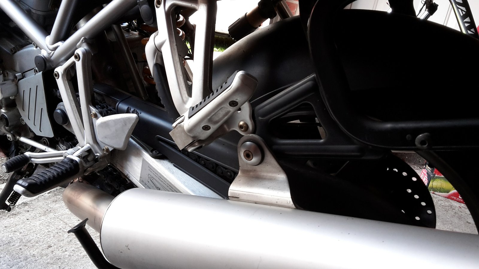

    This is the silencer/luggage mounting Mounting.jpg
    I'd like to get that stand up higher but it looks as though it is working as designed.

  16. Can you raise the rear ride height? Looks like it's only dragging in a straight line tho :upyeah:
  17. It only drags on corners when banked over. And only when 2 up but without luggage. I suppose I could raise the ride height but I've only got 1cm to go whereas the stand could move up nearly 3cm, only it can't because it is on the stops. Ho hum
