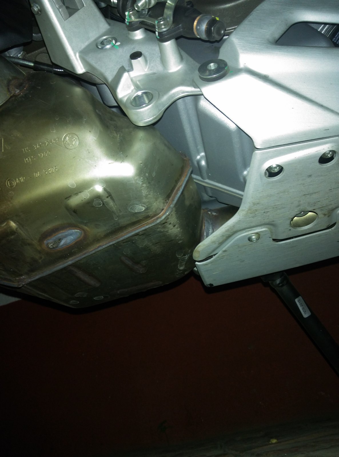

  4. Mine is a 2015 standard 1200s and this is what's under there IMG_20151221_201640.jpg
