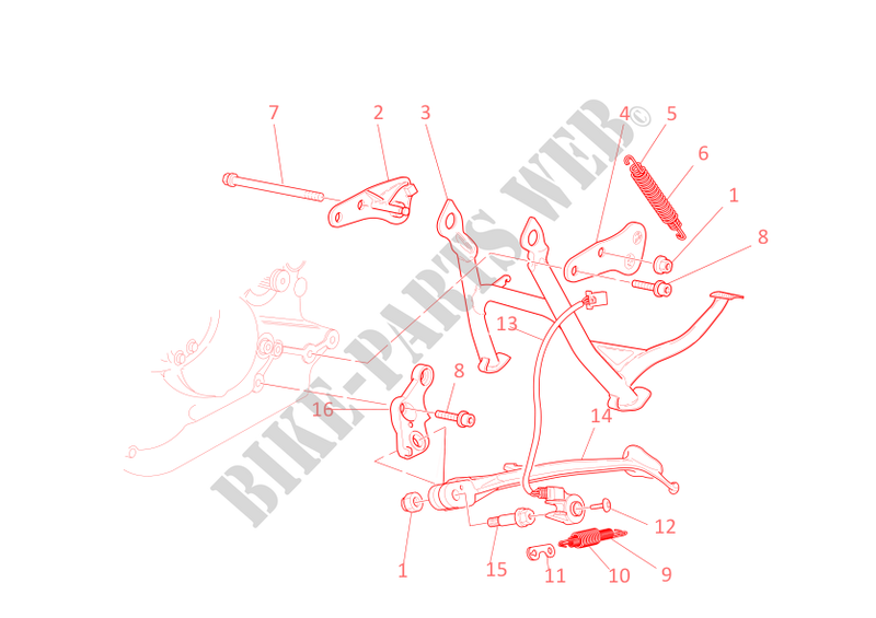

  2. Looks easy to remove if the spring isn't too troublesome - this is an ST3 one...

  4. Stand is held on by three bolts, one long one at the back goes all the way through then the two at the front bolt into the engine.
