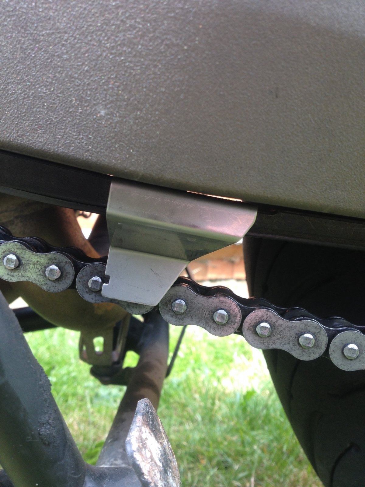

  7. Did we not get the chain measure device with the DVT?
  8. I got one in the tool kit

  12. After 2 dvt's neither had this item in the tool kit.
  13. Nor has mine and was told they dont bother any more
