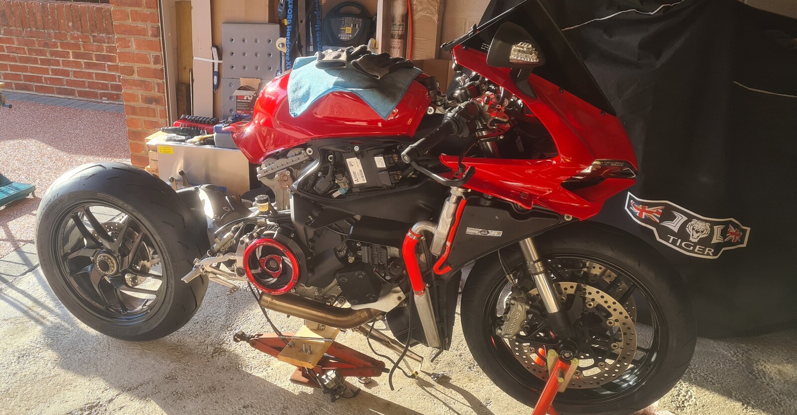

  11. Thanks for the input .... to put a spanner in the works I have gone off at a complete tangent and converted to a SSSA off a 1299.... so thats a 525 rear sprocket/chain.
    After some initial searching it appears to be a lot easier to purchase a 525 15t to fit the 959 front than it is to find a 520 43t+ sprocket to fit the 1299 rear (the std 1299 being 39t) and although I appreciate that there are quite a few 1199/1299 520 conversions done, I am quite happy to have a 525 ....
    So, in summary, I have gone for a JT 525x15T front and a JT 525x43T rear riding on a JT sprocket adaptor..... part Nos JTF749, JTR761 and JTA770B respectively. I already have numerous DID 525 chains, so its just a case of finding one closest to the No. of links required which I believe to be between 104-106.... I'll find out soon enough...
  12. :D see, I've got special powers :rolleyes:
  13. Hahaha! Is a hell of a way to upgrade chain and sprockets :joy:

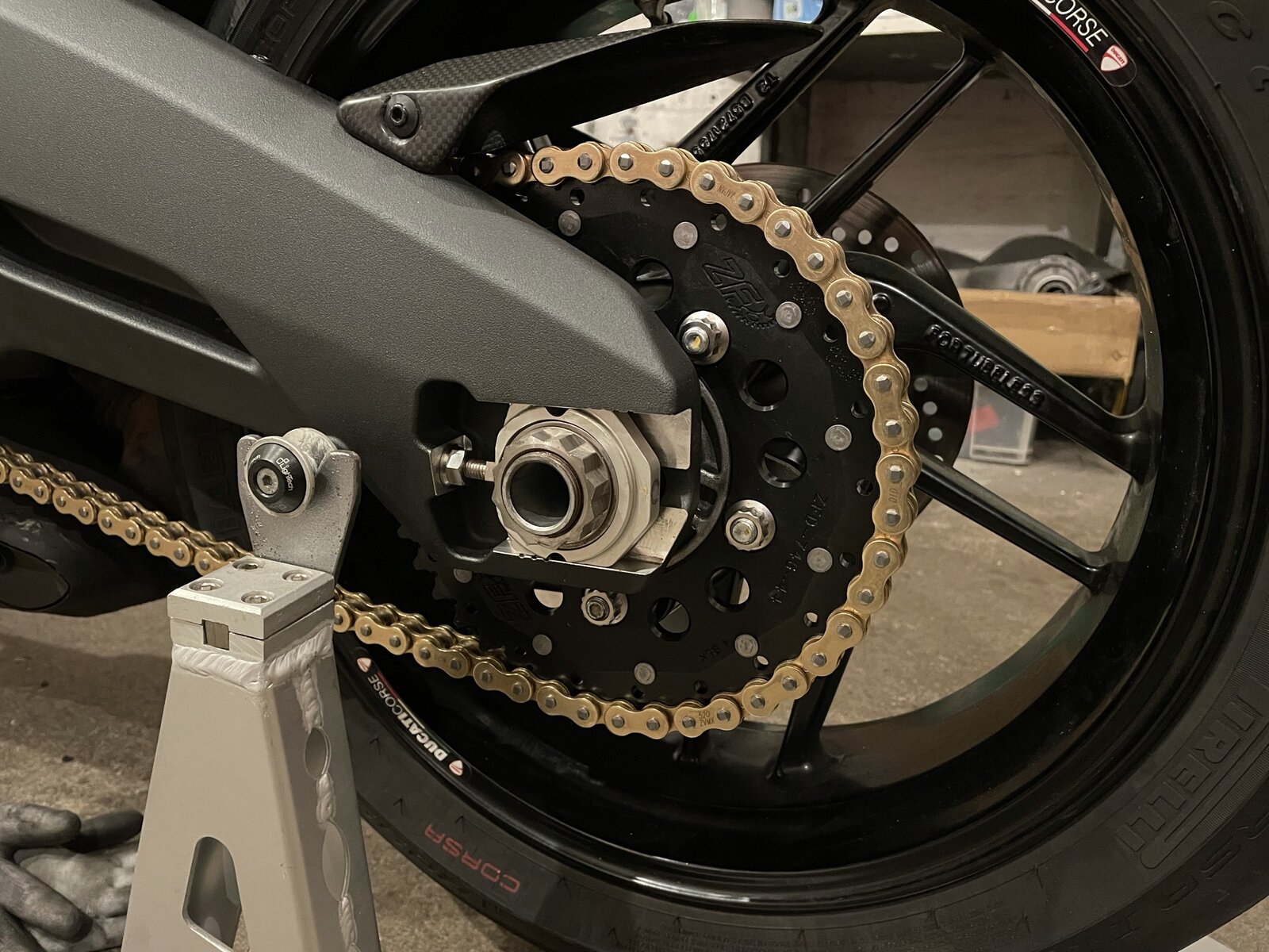

  14. Just fitted these. DID ZVMX chain, Afam front 15T and ZF T45 a long with a sprinkling of titanium nuts and bolts. Couldn’t wait to ditch that shitty, rusty std chain.
