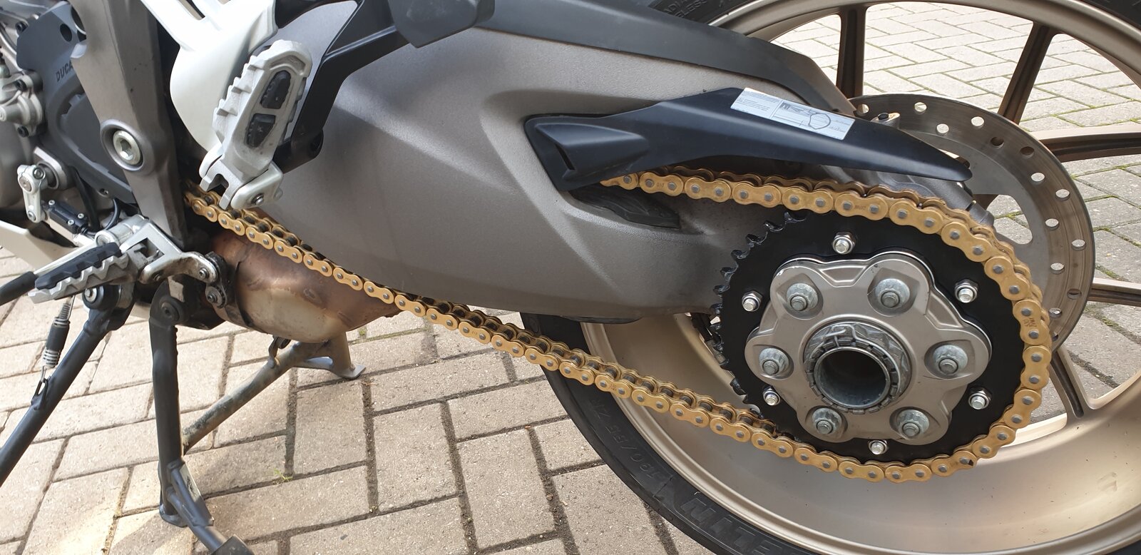

  14. Hmmm, no. Mine went together without issue. Firstly I assume that the carrier is the correct one for the 1260 as on the JT website. Important that the cush drive inserts are correctly located. Did you fit a different, fancy, sprocket flange at the same time as that might be the cause of your problem? Check that everything, spacers etc, is in the correct place, the parts diagram can be useful here.
    Here's mine.
  15. Morning thank you for for the info and diagram.
    Yes all fitted correctly, but the nut will not go on far enough, its about the same amount as the rear spacer (12 on the diagram. I'm wondering if the spacer needs to be removed? The carrier is a JTR760B and the sprocket is JTR763-40

  16. Can you measure the exposed thread you're left with after refitting the sprocket+carrier+flange? I've just recently done this myself with JT sprockets and had no problems. All the original spacers are refitted in the same position as they came out..
    Spacers 3 and 12 are different. Just check you've not got them swapped around by mistake...
  17. Hi Yes the spacer 12 is the thicker one, the amount of thread is less than the thickness of the nut.
    I have decided to sent the carrier and Sprocket backs i believe it's the incorrect carrier as the washer (12) should touch the end of the flange (i maybe wrong).
    I have ordered a new sprocket that doesn't need the carrier. So hopefully it will all fit as I'm to Spain the following Sunday (17th)
