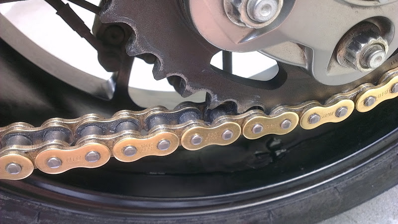

  9. Me too. Ridden in damp conditions and I've also got rust spots on side links. Chain lubed every week. My last chain had gold coloured side links.

    I think the gold chains have a coating or anodized finish which is way easier to keep clean, seems to be rust free and also looks cool (imo) cant remember which bike I had with that on when I bought it.
  11. I saw a red side linked chain for my multistrada recently. This will be my next chain:biggrin:

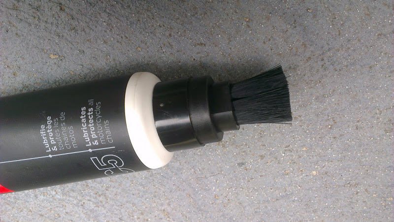

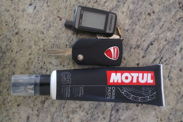

    3. I had to put tyres on about 3 months ago and I saw this new Motul C5 Chain Paste 150mL/143g and got a tube. It cost AUD$14 at a Ducati dealer and is in a toothpaste like tube with a brush applicator. Key shown for size. It is about as long as a tube of toothpaste and maybe 2x the volume.
    I had just replaced the chain and sprockets on my MTS1200 at 32,000km with DID chain and AFAM sprockets. I thought a bit of easy to use chain care would be useful. I have used both Motul chain wax lube and Bel-ray so far on this bike but both spray cans get pretty messy. The MTS has the rear chain crud catcher and this makes it hard to lube both sides of the chain without taking off the catcher with 3 hard to get at bolts. The other option is to just spray it on and get lube over the wheels and tyres or try to catch overspray with a piece of cardboard.
    I gave my bike a clean today and gave it a go. This is what the top end looks like. Bristles are quite stiff.

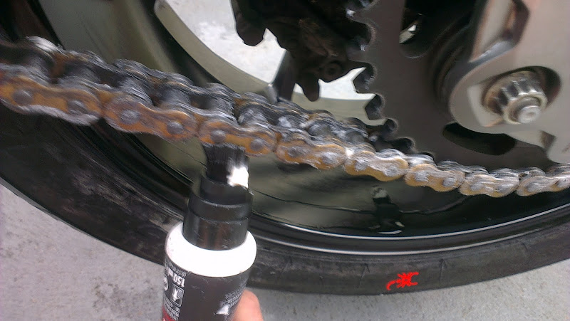

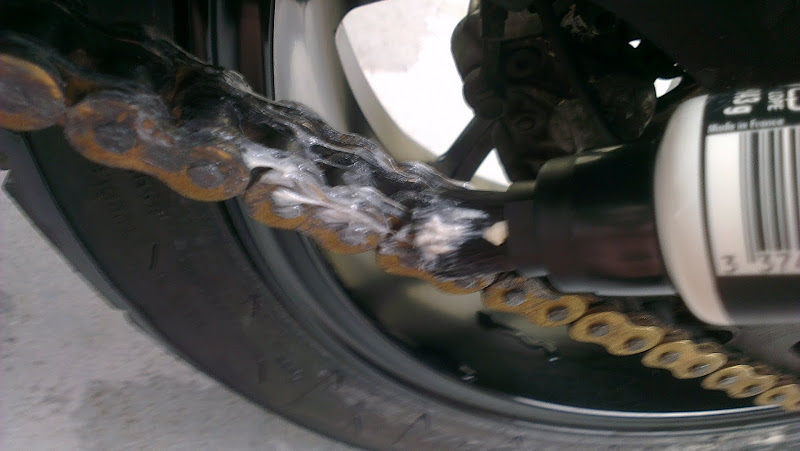

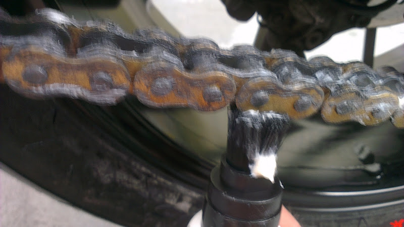

    Uncap, unscrew the brush, remove a foil seal on the tube end, refit the brush, squeeze and "paint" it on. Seems to work really well. Easy to apply to both top and bottom of the chain and use the brush to work the lube onto the o-rings. Top.
    Bottom.
    Just paint with one hand and rotate the wheel with the other.
    Seems also to help get the crap out of the rollers and o-rings. This chain has only done about 1,000km so it is still pretty clean. Wipe clean with a rag, job done in maybe 2 minutes. Absolutely no lube anywhere but on the chain. What a novel concept.

    Summary. Seems an excellent product and quite good value. It is a small tube but there is so little wastage that I guess I will get ?30 lubes out of a single tube. The tube itself is small and flexible and would be easier to carry on tour than a pressure can. It is more of a paste or creme consistency rather than a wax but it is waaayyyyy cleaner to use than any spray I have ever used and is easy to lube the chain pivot areas without getting it everywhere. Many sprays really need you to spray and let it dry for some time to stop fling. This does seem to have that problem. Put it on and ride. You will need a wipe off rag after lubing but so far this is pretty good stuff.
