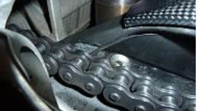

  1. Guys
    Just noticed my chain is rubbing the swingarm behind the gear lever hanger, so pretty close to the front sprocket.
    Bike has 870 miles on clock, looks like its been rubbing for a while.
    Anyone else had this on a 1299?
    Booked it with dealer for inspection regardless, but with 4 track days up and coming id like to offer as much help as possible with the causes as they haven't seen it before.

  8. image.jpeg Are we talking side of chain or top/bottom?
  9. Yep, that's the spot.
