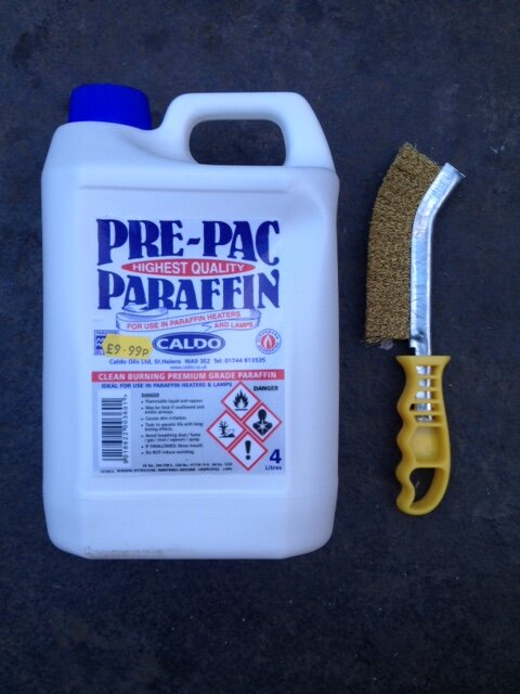

  3. Paraffin and a brass wire brush works wonders. Then keep it well oiled. Job Jobbed.
    Top Tip: Don't let wifey know you've stolen her suede shoe brush. Deny everything.

    Paraffin as suggested by bootsam is the way to go imho

  13. Paraffin & wire brush + abbaskylift.

  17. I just bought the same Brush today from B&Q - had the paraffin already :)
