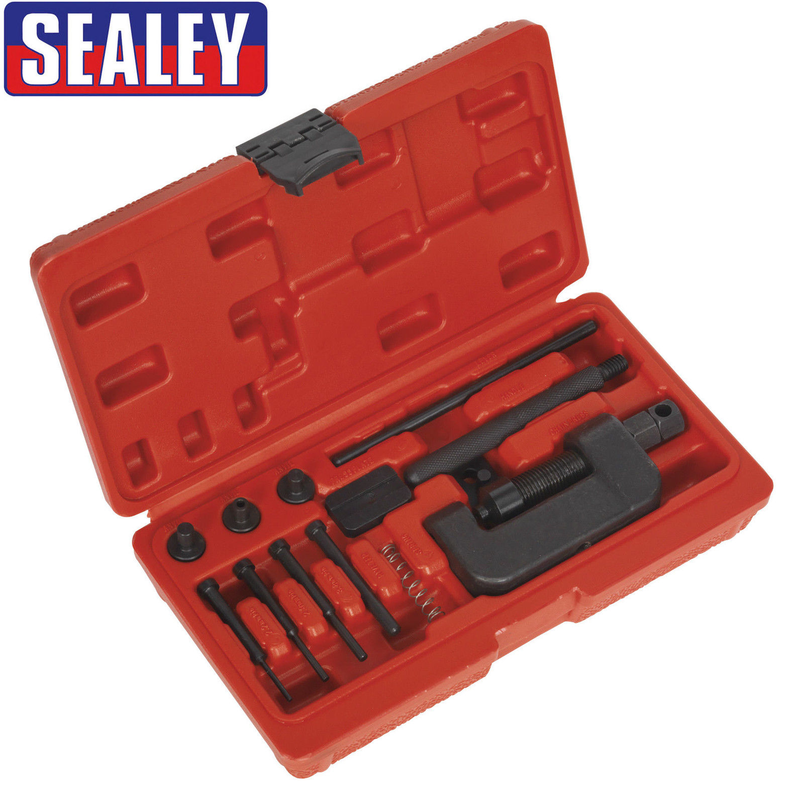

  1. Need a decent splitter. Not for everyday/professional use so without going bonkers on price, any recommendations?
    I was going to get the Sealey one but mega mixed reviews..

  3. I have used one that looks like the Sealy one. After two chains the jaws of the G clamp deformed.

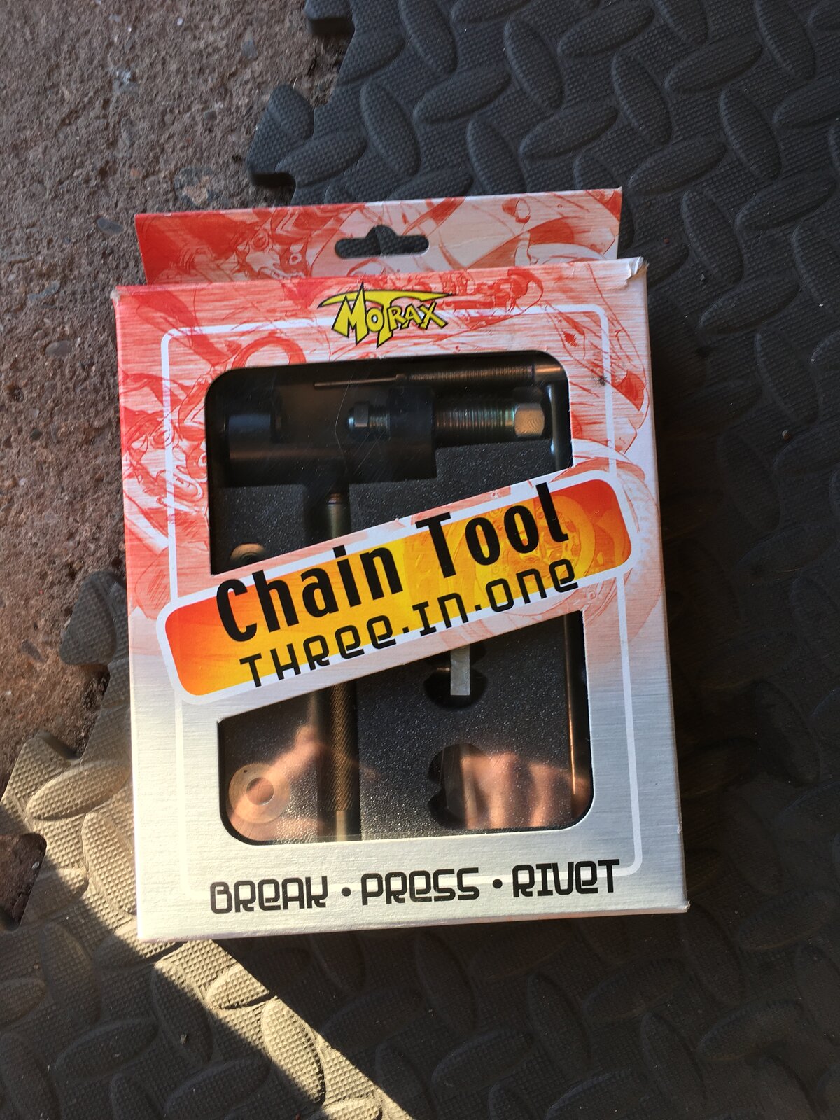

  8. 8E5E3EA2-B29F-468B-956A-0C22DC9439F2.jpeg 9377483F-6EDB-4AF1-ADA6-E402210D18B1.jpeg Ironically I have just done the chain and sprockets on my multi, I asked the same question about a year ago and ended up with this one, used it 3 times now two 520 and a big 530 and no complaints, decent price also

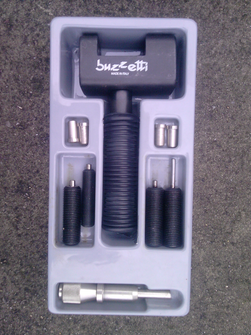

  9. Curiosity got the better of me , so I dug out the one I bought 10 years ago .
    Essentially a hand-held anvil .... mighty heavy , mighty tough , and never failed me .
    Can't remember how much , but much less than the Whale at the time ...
    ..... 70 Euro ? .... I'm guessing .
    The silver coloured doo-dad at the bottom has a beveled tip to do the
    " quad staking " of the rivets .

  10. The one I have linked is the orginal version, Motrax is the copy & costs £45. British maker I linked costs £30 odd although I use that version with a large bar on the handle. As I cannot gain enough grip around the fairly small handle.
