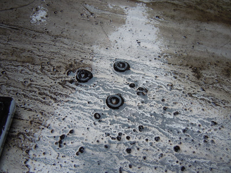

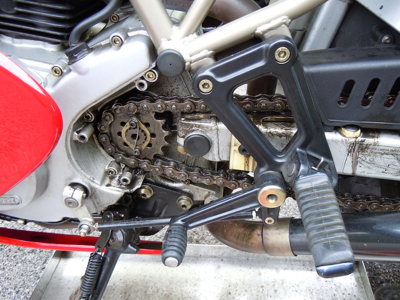

    Thought I'd clean & lube my chain today, give the old girl a little treat ! So out with the Jizer, trays & brushes & started the clean up. Took the gearbox sprocket cover off & these, what looked like, three spring washers fell out !
    Where on earth have they come from I wonder. As soon as I picked one up I realised they were O-rings off the chain. Sure enough after cleaning the chain I could see there were a few of the O-rings missing.
    Looks like a new chain & sprockets is on the shopping list now. I last changed the twenty years ago, but it has only done around 8,400 miles in that time !:joy:

  2. I imagine in 20 years the rubber has got too brittle. I’m surprised there is no rust after that time too? I think 20 years is beyond the normal call of duty.
  3. I'd agree, like you say after 26 years, (I checked my records for when I did it) the rubber is well past it's best & I've had my monies worth I think !

    So I thought I'd at least cut the old chain off & replace the engine sprocket. As it was a bit of a faff to get it on my bench I figured I'd do the work on the garage floor. Makes you realise how good hydraulic benches are, working at a sensible work height !!:joy:

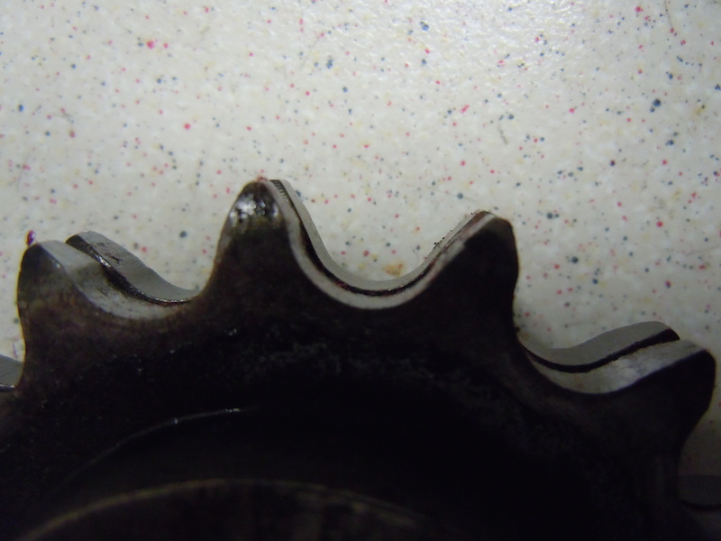

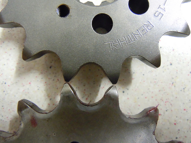

    On the face of it there didn't look to be too much wear on the sprocket, but when you put them on top of each other the wear is clear to see.
    These have lasted 19 years & just over 8000 miles.
    DSCN3794.JPG Although it's not a massive amount of wear & I've seen far worse on peoples bikes.

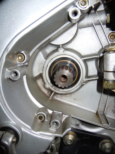

    Old one off & cleaned up ready for the new shiney sprocket.

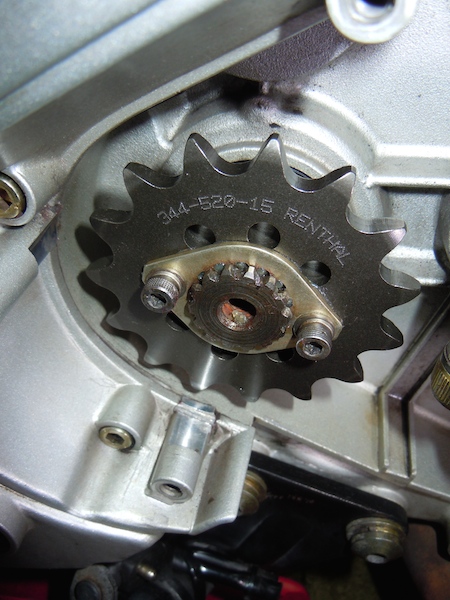

    New sprocket fitted, I'll tighten the two cap head screws & wirelock them when the chain is fitted as it's easier to hold the sprocket that way.

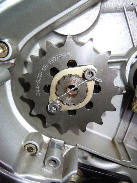

  14. Got bored today so tightened the sprocket bolts up & wire-locked them. Took all of five minutes !! :joy:
  15. Nice, wish mine looked like that ,still got the rest of the day though?
  16. bottom bolt fixing is that machined or wear from the chain
    have you thought of fitting a case saver/protector quite easy to make
  17. Damn that’s clean!
  18. That is a normal machining mark along with the other machining mark on the boss at the 9 o'clock position, as it left the factory.
    I have seen protectors advertised, but never felt the need to fit one on a standard road bike. If I was tracking/racing it then I might, but I've never had a chain fail & never known one to fail that has had regular maintenance.
  19. fair comment didnt spot the one a 9 oclock doh clearly see that one is not chain mark
