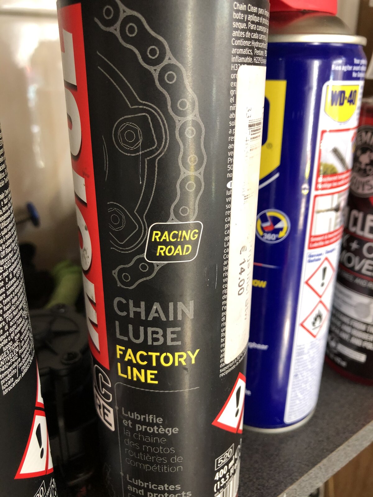

  3. I use Motul chain cleaner and lube. If you clean it throughly enough with the chain cleaner first you can get it that clean. A small tooth brush on the outer edge of the chain helps and plenty of cloths to rub it clean. It wont stay that way though.

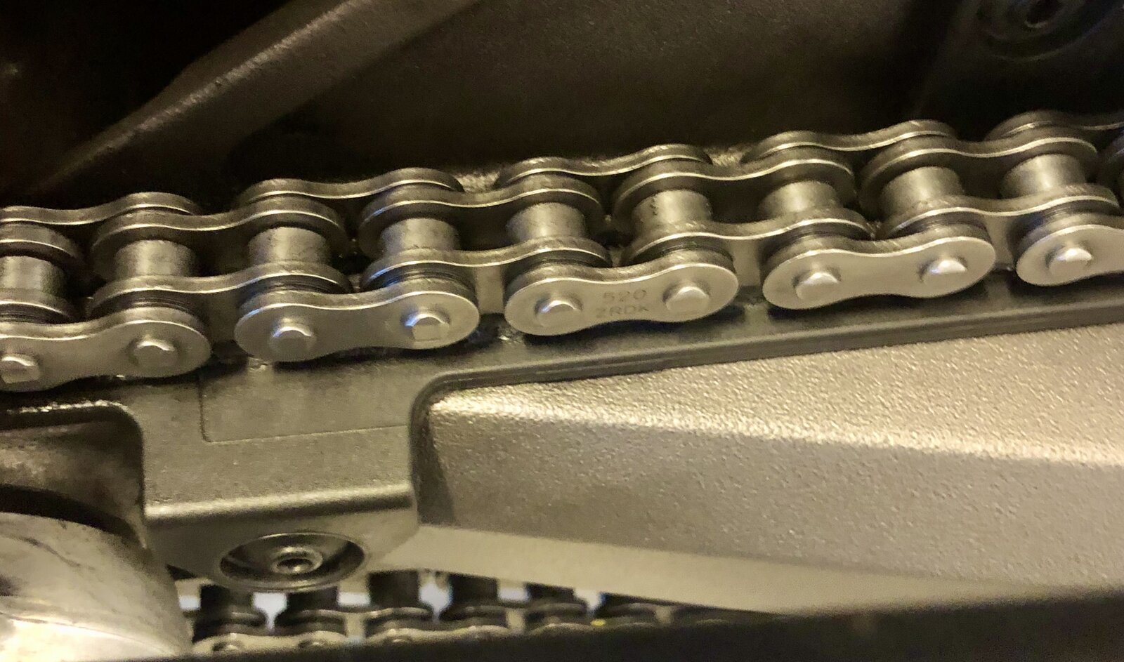

  11. I used to use Motul but for the same reason stopped using it. I have been using this
    https://www.walmart.com/ip/DuPont-T...y73MKJWb1l3qGoqvR2RKZmwxUPr5ATwhoCQksQAvD_BwE
    This is a video on how I get it really clean. The Dupont goes on clear, no residue and most importantly no fling. This picture is after cleaning and oiling with the Dupont chain oil. Notice how clear it goes on. I wish I would have found this when I was younger. I have used so many chain lubes and very expensive ones. Dupont is overall the best I have used yet.

  12. Might give this a try.
    Have used paraffin then gearbox oil for many many years but your chain looks so clean I can't resist trying it.
    Will find out how much first though.

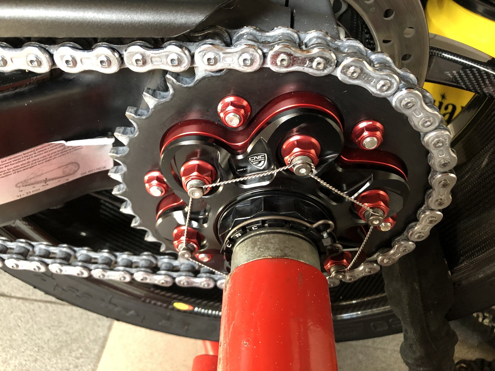

  18. As far as cleaning my chains, I’d like to share my fetish products:
    - Essence F (distilled gasoline?) to clean the chain. Won’t attack the chain o’rings like classic WD-40 would;
    - a specific helicoidal brush called Tirox 360 which I was introduced to a couple years ago. A little wonder;
    https://www.sportbiketrackgear.com/tirox-360-chain-brush/
    - Profi Dry Lube for lubrication. It is Teflon based, clear, won’t splatter everywhere (wheel, sprocket, frame, etc.), but does need to be applied more often than your regular chain lube. For high mile tourers, they sell smaller « trip » cans.
    https://www.mandp.co.uk/products/profi-dry-lube-400ml-532568
    The results I get with these are phenomenal, both visually but also in terms of longevity for my chains and sprockets. Disclaimer: I very rarely ride on wet roads.
