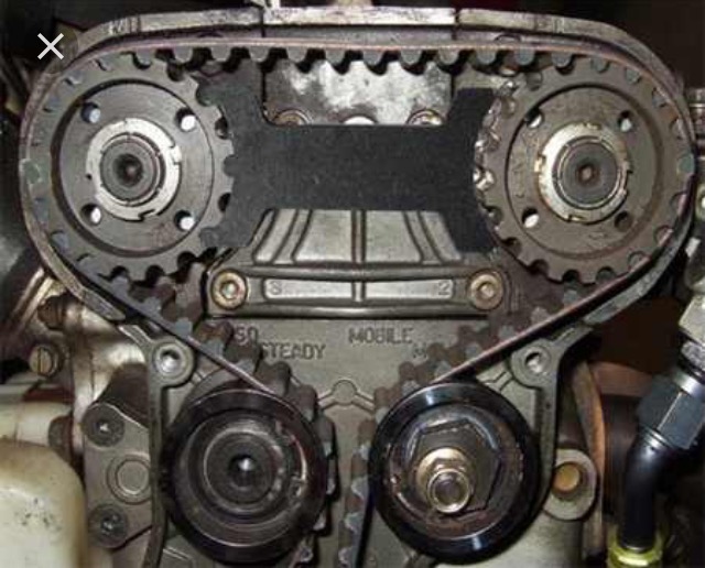

  6. I think you might have it old rider, The tensioner should be rotated anticlockwise to achieve tension but it is possible for owners to erroneously rotate clockwise. Never stripped one myself and discovered this, but I know people who have. Two things result from this, you can't achieve as much tension (just as you have found) and the belt becomes perilously close to touching itself. Below is correct so you can easily check: – image.jpeg
  7. Yea agree with Chris above, changed mine 2 weeks ago and noticed this too. Need to turn anti-clockwise.

  10. What are you using to tension the belts? Twist method isn't too reliable. I've seen what you're describing many times, but the reality is that using the correct tool to tension shows the belt can be set right.

  17. Thanks for all the advice - I've stripped the idler and tensioner pulleys out to check the bearings, they all seem to have the same amount of float - all the pulleys rock slightly on the bearings, but seem ok otherwise. I swapped the tensioner pulleys over, and horizontal belt was still looser than vertical (using both twist and 5mm deflection method). I've taken the idlers off, next step is to swap them too, and measure pulley diameters to see if they've worn - just need to get some threadlock to put them back on.
    I will try the anticlockwise method, I was doing it clockwise, but I can't see how that makes a difference, it's down to geometry surely?

  19. Tightening clockwise will make a big difference, for a start the inside of the belt may rub against itself on the other pulley. If so it will shred the teeth off and cause you a huge problem when the cam timing jumps. :eek:
    I have also heard of belts tensioned wrongly 'walking' on the pulley so that it wears the edge away plus, as you noticed you might not get it tight enough...
  20. There's your problem right there...
