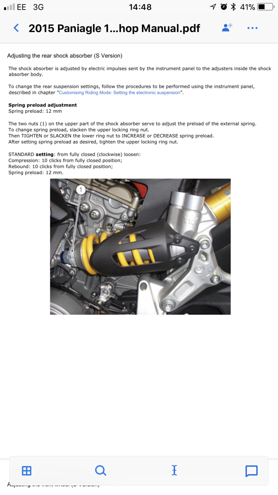

  2. Get hold of the workshop manual... if it isn’t too many pages I’ll post the bits you need in here. Pretty straight forward, but you will have to support the rear (I’ve done ratchet straps from seat subframe to roof and a scissor jack on top of the rear wheel).
    Out of interest, why do you want to swap? F is better most of the time, and P is really more for if you carry a pillion because it ramps up the force required towards the end of travel to stop it bottoming out (not a problem with just rider).

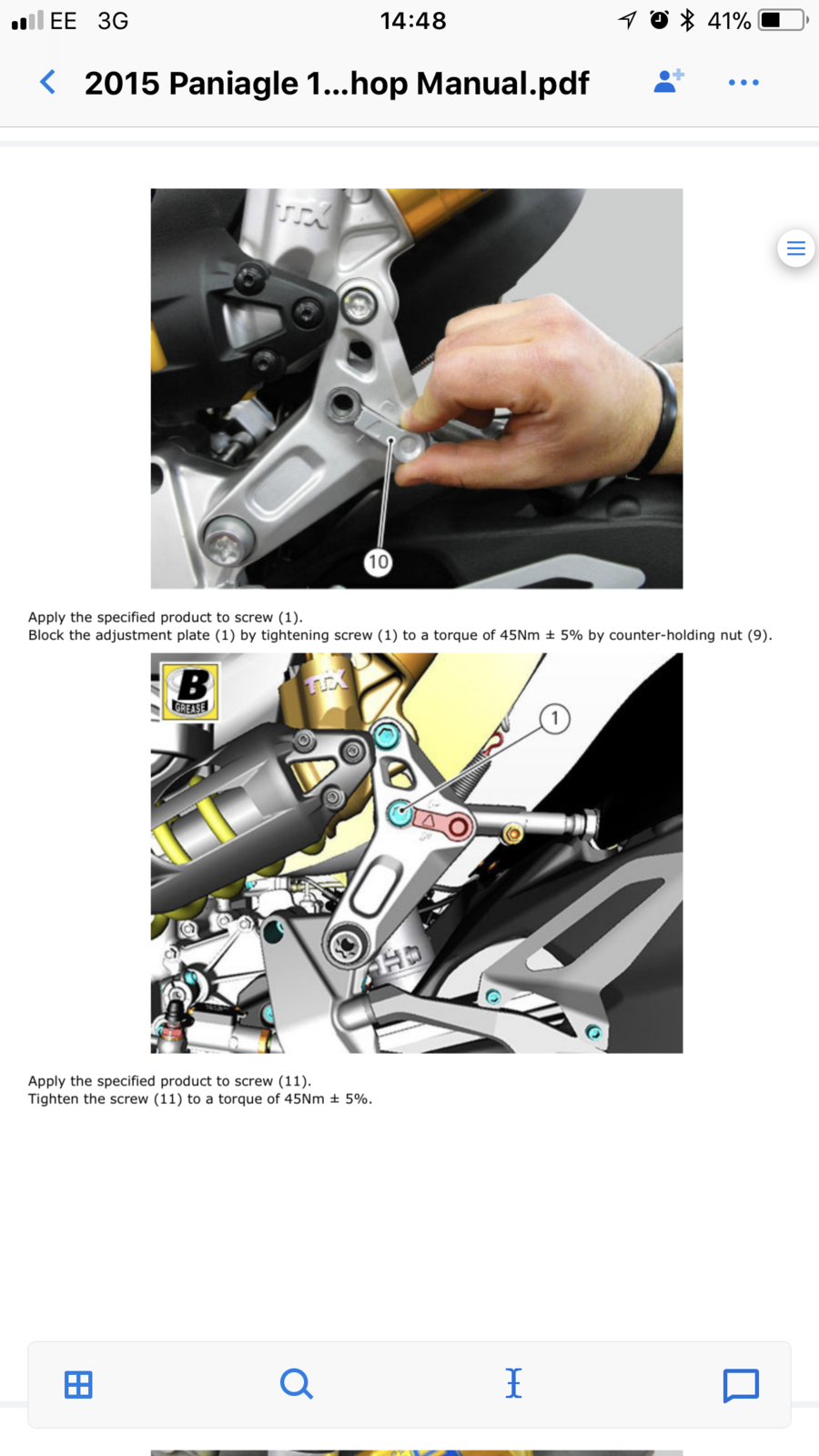

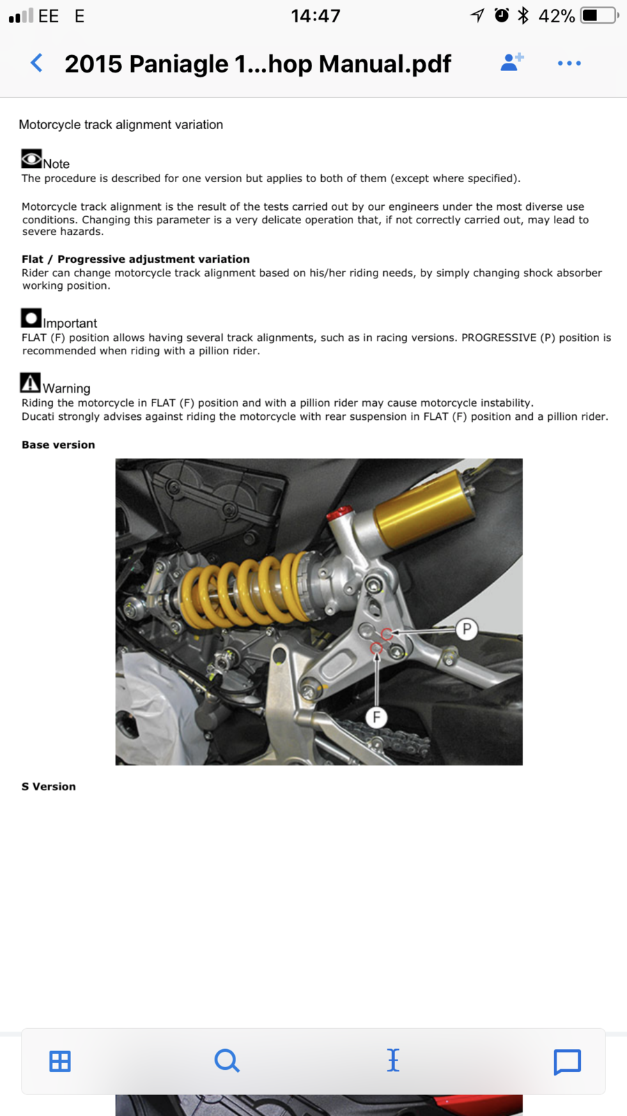

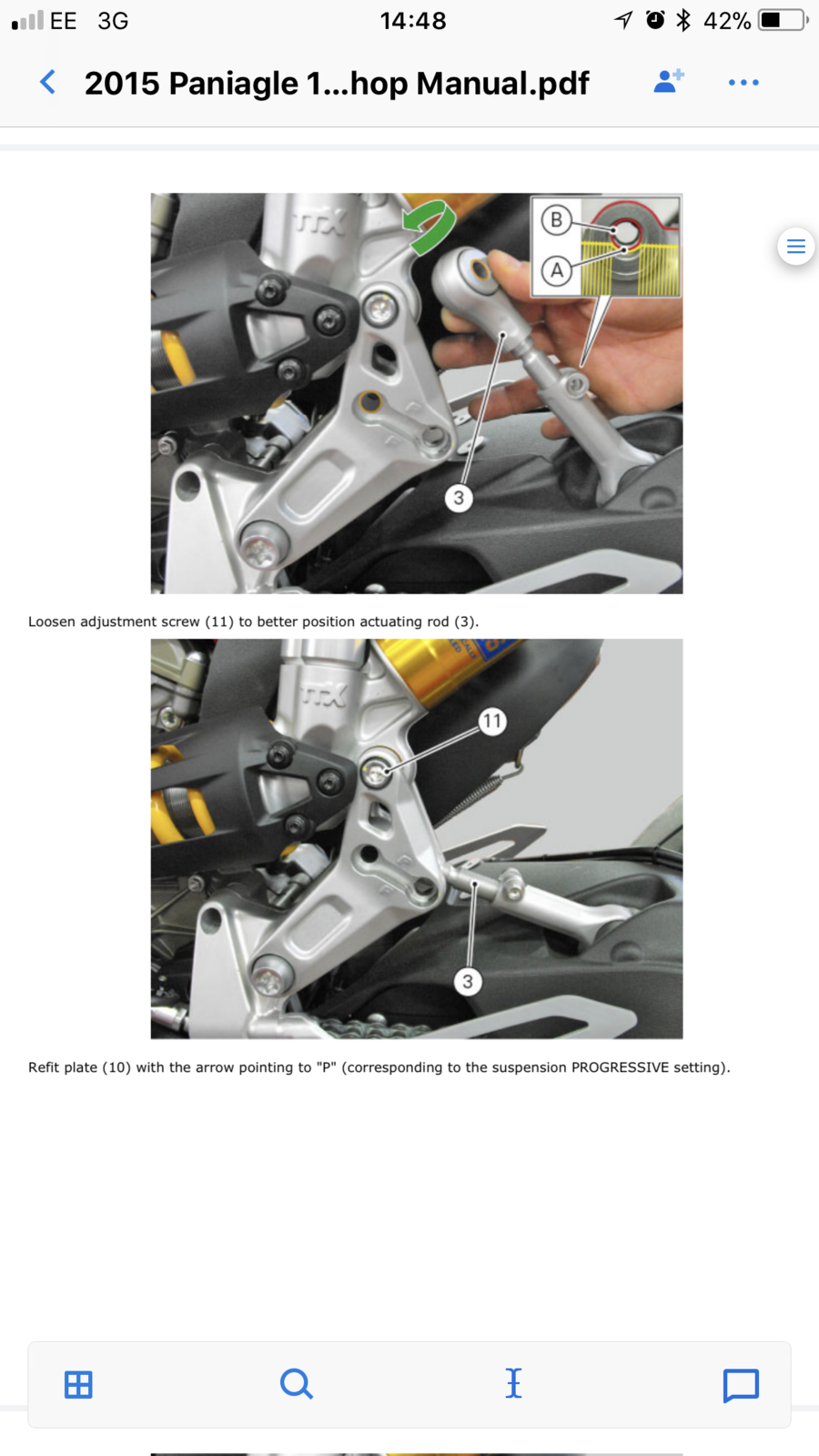

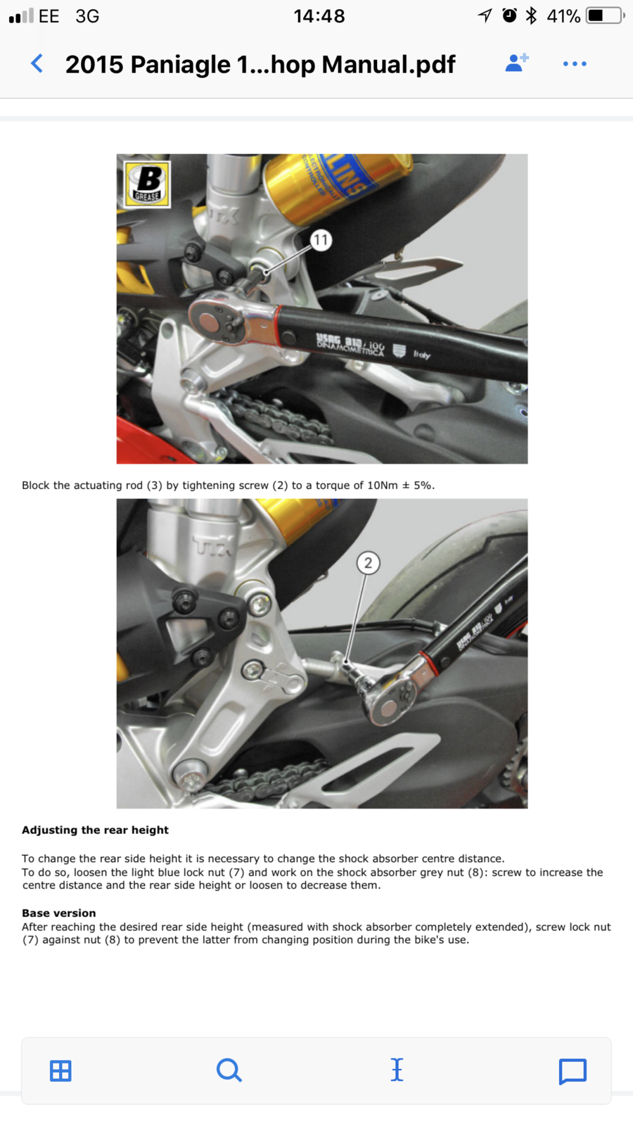

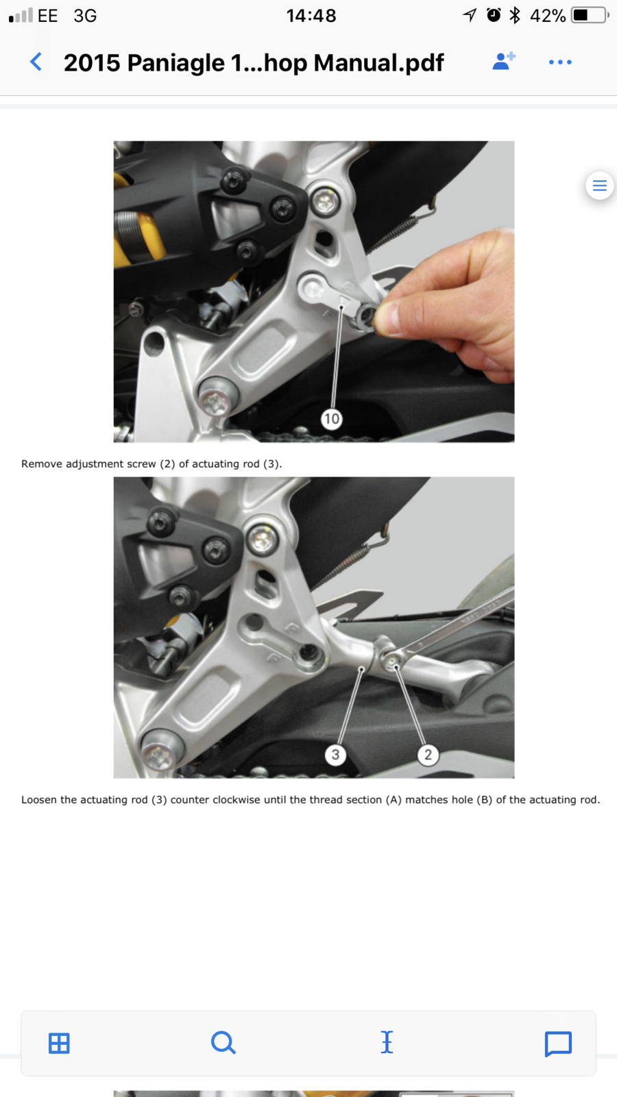

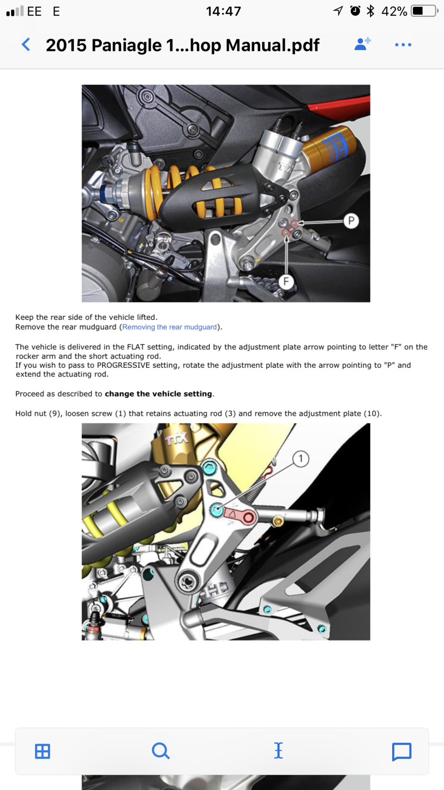

  3. Here are the pages you need.....
  4. Thanks for the info Jolley, great instructions.
