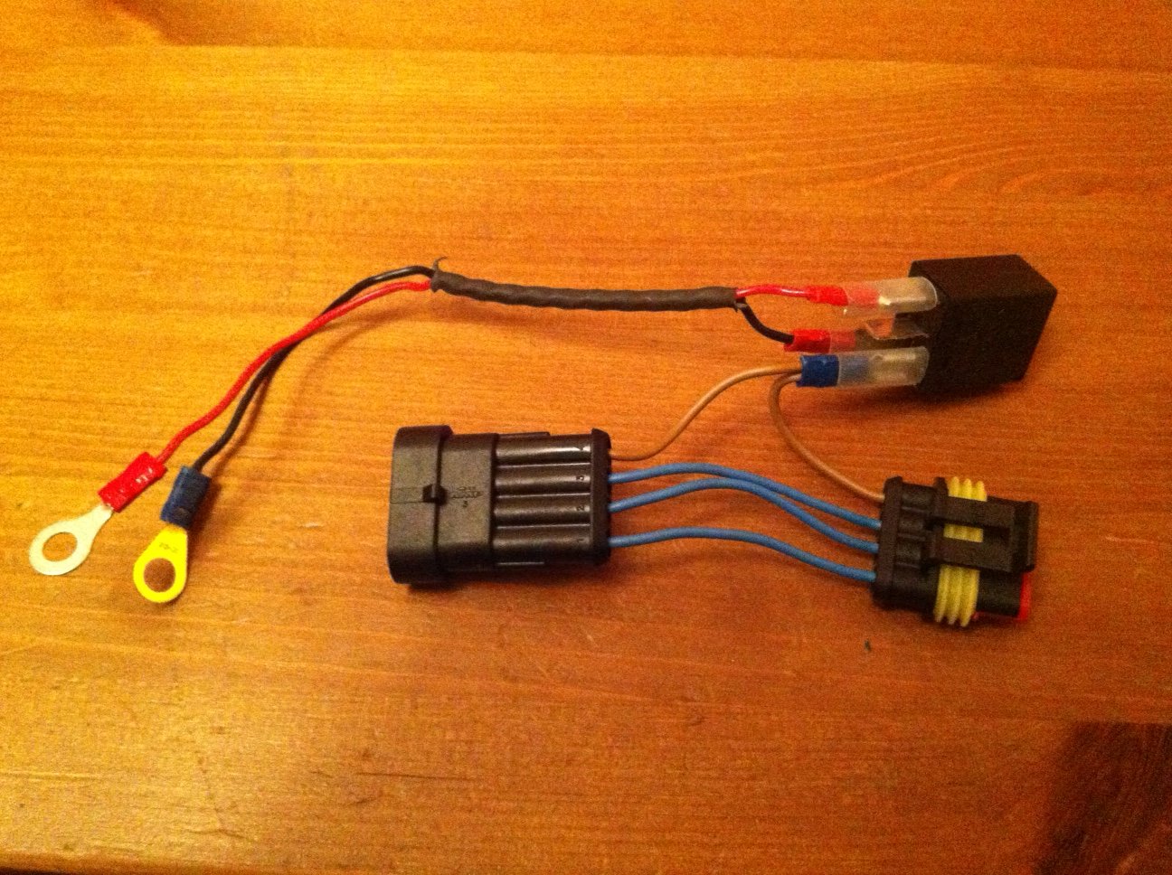

  7. You run the trigger wire of a relay to something like a light or anything else that only comes on when the bike is on, because it then means it's only drawing power whilst the ignition circuit is on. No battery drain issues.
    I used to use a thing like @Exige mentioned but had to keep remembering to unplug it when the bike was off or it could drain the battery.
  8. That will work too. You can just wire it to the battery if you don't want the hassle, just remember that it will drain whilst off. If you leave your phone plugged in or something, you could get stuck. Relays cost a couple of quid and are easy to wire. Once you use one you'll be hooked as they make life so much easier.

    As above, use a relay so it only runs when you bike is running. A good tip is to work off the rear light or brake light, and use a couple of connectors to make a short extension into the harness so you're not chopping wires around.
    I've done the same on a couple of bikes and in the car they work really well, are easy to remove and can power all sorts of things including heated grips, sat nav leads, etc.
