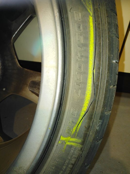

  1. Not bike tyres, but this is what the MOT man found on my Mrs runaround Fiesta ST.

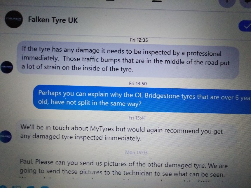

    And Falkens explanation.
    Quite amusing, when my Mrs drives like the little old lady she is, and the only speedbumps the car sees are in Tesco's carpark. IMO the sidewalls aren't up to the side loads the ST can put through them, on the odd occasions I take the car out for a drive. So bear this in mind if you're looking for mid range tyres, and you may have to drive over speed bumps. The inner sidewall on the opposite tyre has started to split too.

  3. It's the inner sidewall, so unless it's on a ramp or the wheels are removed, hard to see. I was horrified though. The tyres have just under 6mm across the full width, and are under 3 years old. I bought them because they got good reviews in the wet, but they're not as good there either, as the original Bridgestones are.

  8. Falken are now saying the tyres were run under inflated. That's BS though, as the car has a TPMS, and a warning light and chime come up on the dash if the tyre pressures are low. Plus I check the pressures weekly anyway.
  9. Seems like a bit of a stretch that. You’d be able to see wear if they were under inflated

  11. When I had that tyre taken off, I asked the fitter about getting a replacements FOC from Falken. He said they'd deny it, and use every excuse going.

  16. Yep. In my experience when you run around on under-inflated tyres they don’t crack in one place but instead a band of abraded rubber forms around the entire circumference of the sidewall as result of the flexing and overheating. The inside of the tyre is also often full of black rubber dust too.
