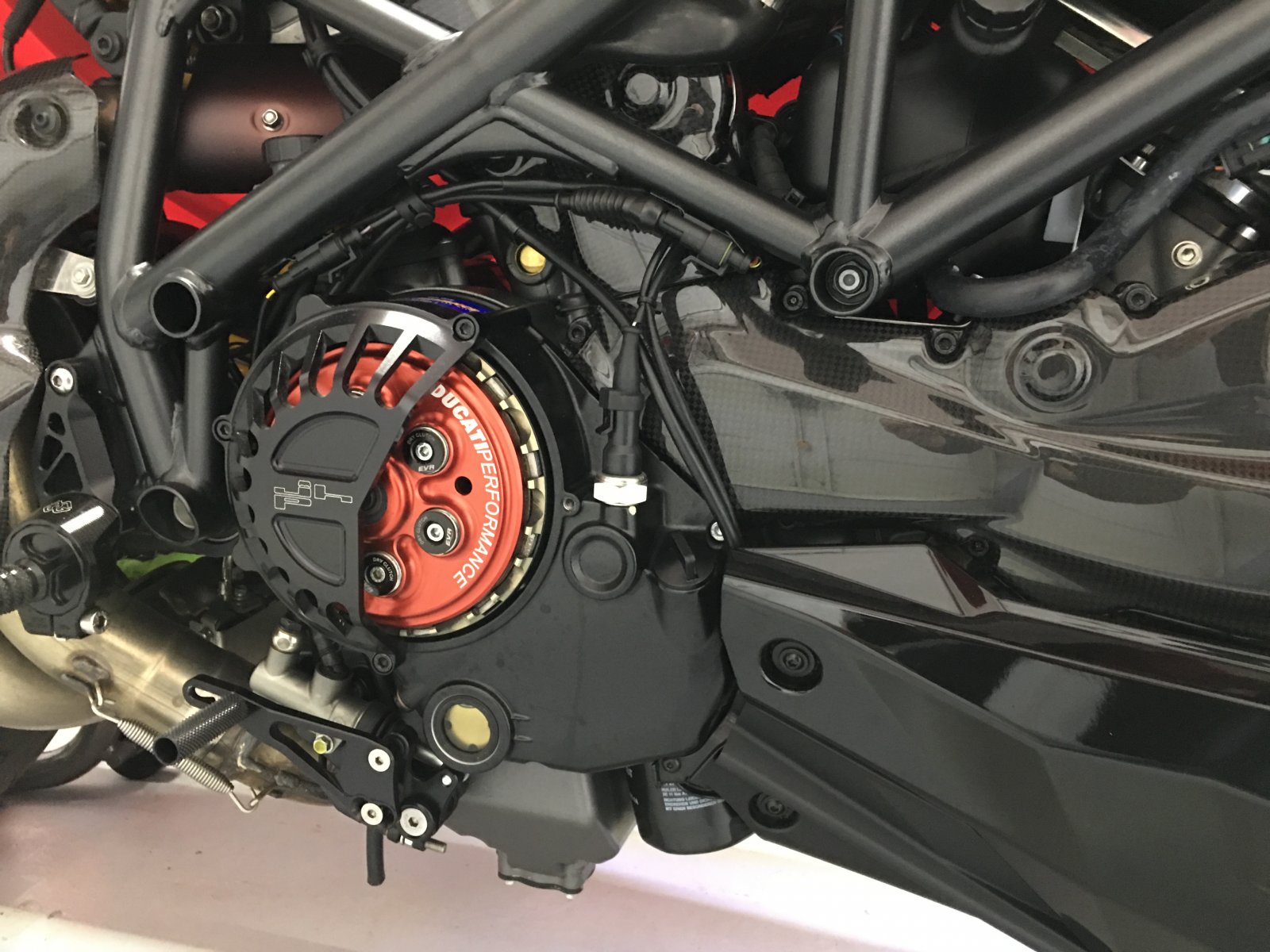

    • Fill it to the top mark on the stand and then not worry too much about it. Posters above are correct that too much oil is not recommended, but you are talking about quite a bit more then this slight overfill would give you. I'm sure Ducati have built some level of margin in there knowing that the majority of oil changes will occur with the bike on a rear stand. I've seen my bikes serviced in the dealers and they are always only on the rear stand. When I have checked (it's always nice to see fresh oil in the sight glass :)) they are almost always filled to slightly above the sight glass upper limit mark. Here is a picture on the engine of my recently Ducati main dealer serviced Streetfighter. The oil is slightly above the top mark. IMG_3897.JPG

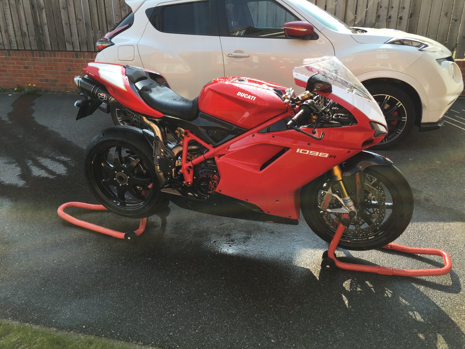

    • Buy a front paddock stand. They aren't much money, keep the bike level to help you with your problem and are handy to have for other tasks (cleaning the front wheel without moving the bike back and forth, removing the front wheel etc.) :upyeah: IMG_3988.JPG
    • But as said above. Don't be tempted to start holding the bike on it's wheels while trying to fill and check the level. You might get away with it, you might not. :(
