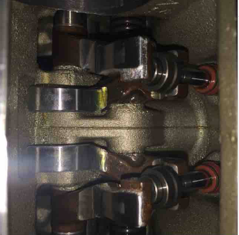

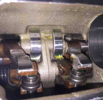

  1. For all the Desmoquattro owners who find flakes of chrome on the oil strainer, things might not be as bad as they appear. Just prior to my 12000 mile service I dropped the oil from my 02 748E and found 5 fairly hefty flakes of chrome on the strainer. With a heavy heart and humming "Always look on the bright side of life" I took it to Doncaster Motorcycles for what I thought would be a poverty inducing service and rocker arm refurb. To my complete astonishment I received a call 4 days later to say that the service was done and the rocker arms were fine apart from light scuffing with pictures to prove it!
    The full service came in at much less than 500 quid not including cost of the belts which I supplied. I didn't think an hourly rate of £35 existed anywhere these days especially for a Ducati factory trained mechanic. The bike sounds and rides like new. First time I have used these guys and would highly recommend especially if you baulk at paying £60 and hour excluding VAT.

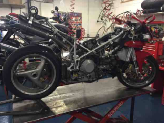

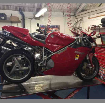

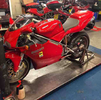

    The pictures of the bikes rockers and of it in various states of undress during the service was reassuring and a nice touch.
    All ready for the new season once the wind has dropped and the rain stops.
