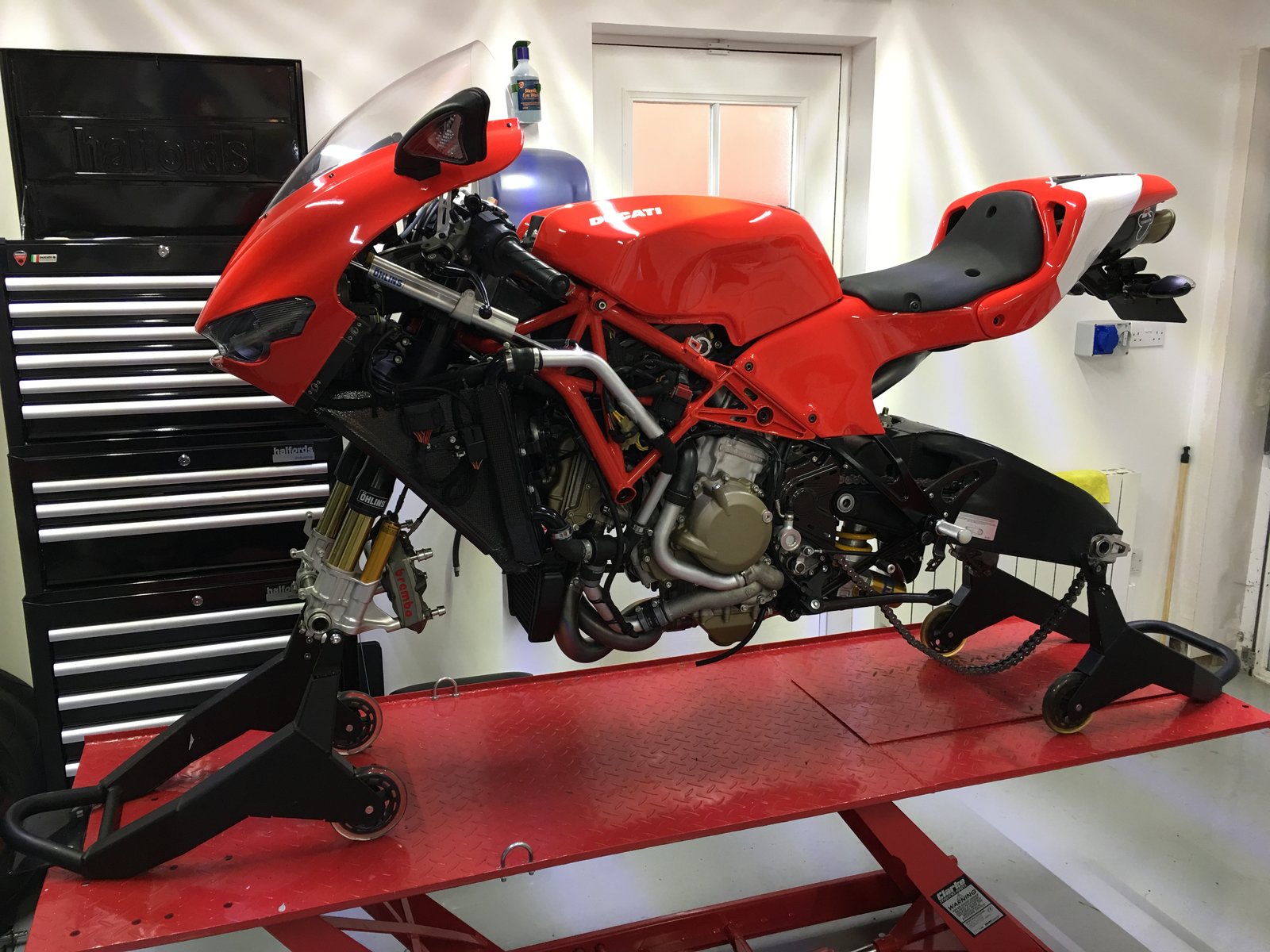

  3. IMHO make sure its long enough and wide enough for front and rear stands or its not worth bothering (front stand may need a chock removing)
  4. Yep, when I take the front wheel off using a paddock stand, I take the chocks off. 2 mins with an impact wrench and spanner. :upyeah:
  5. I have the CML 3 air and foot lift, absolutely invaluable. Takes a full size single sided swing arm paddock stand and is long enough to use front and rear paddock stands at the same time. Andy
  6. i made the mistake of buying a narrower lift. it was fine with regular bikes but useless with single sided swing arm as the paddock stands tend to be wider
  7. I've told you before to strap those paddock stands, you trip (the size of you) and it's skittles :mad:

  12. Scare's me when I see this photo, With my luck the lot would end up upside down on the floor :eek:
  13. I've telt him time and time again :rolleyes:
