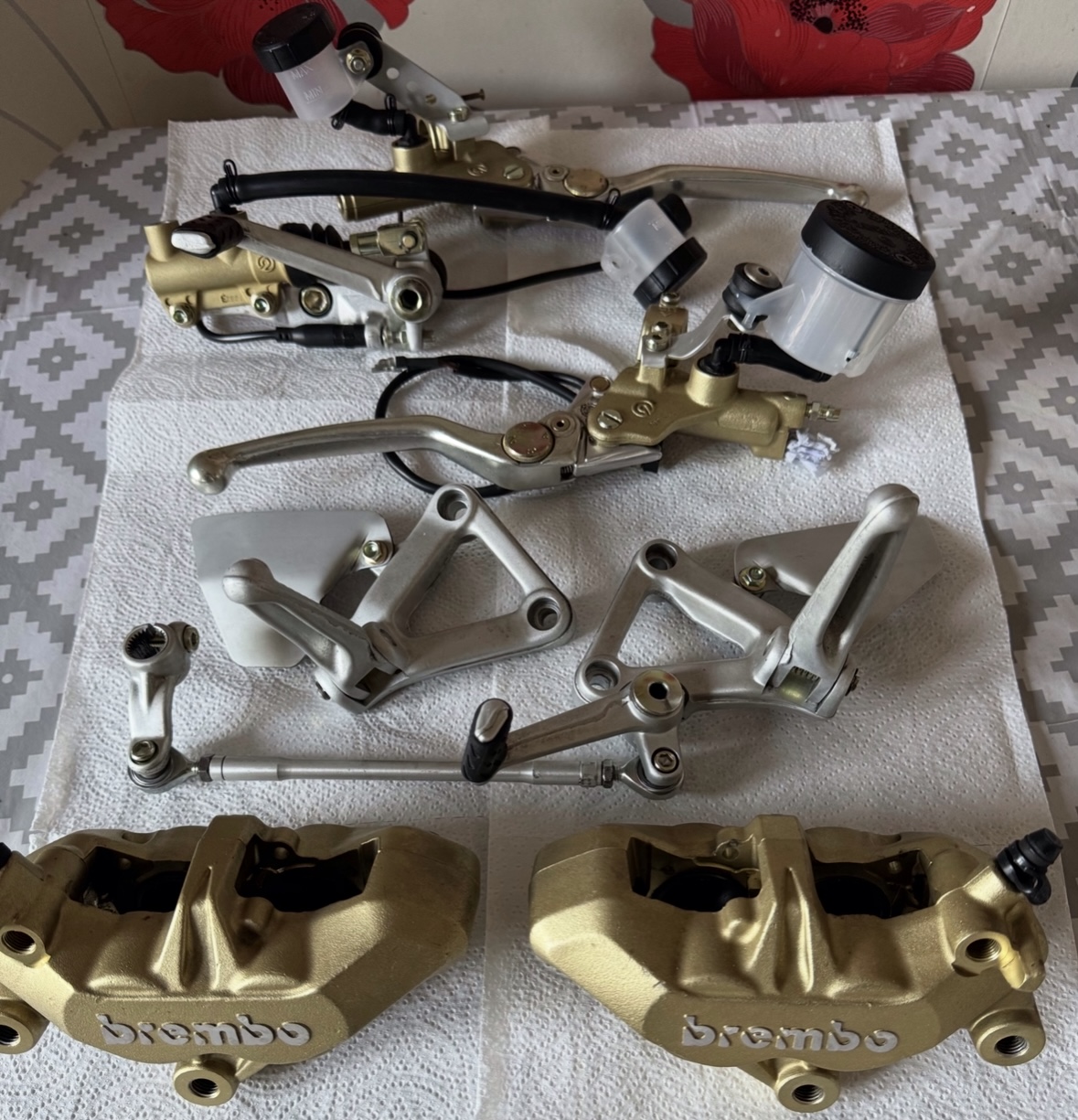

  5. I have used brake cleaner to clean calipers on bikes and cars for decades and never had any problems.

  6. Another one for Bilt Hamber like Andy said. Did all this lot with it and came back up like brand new.

  10. the original gold coating on Brembo calipers is first class and will tolerate many chemicals. Of course brake cleaner will work but if the the "Brembo" etc is highlighted in red then best avoid this area. I prefer WD40 or GT80 etc for this reason, the propellant works just as well.
  11. I'm always impressed how tough that original coating is.
    I like using the modern fancy wheel cleaners available, they are great at degreasing and cutting through brake dust.
