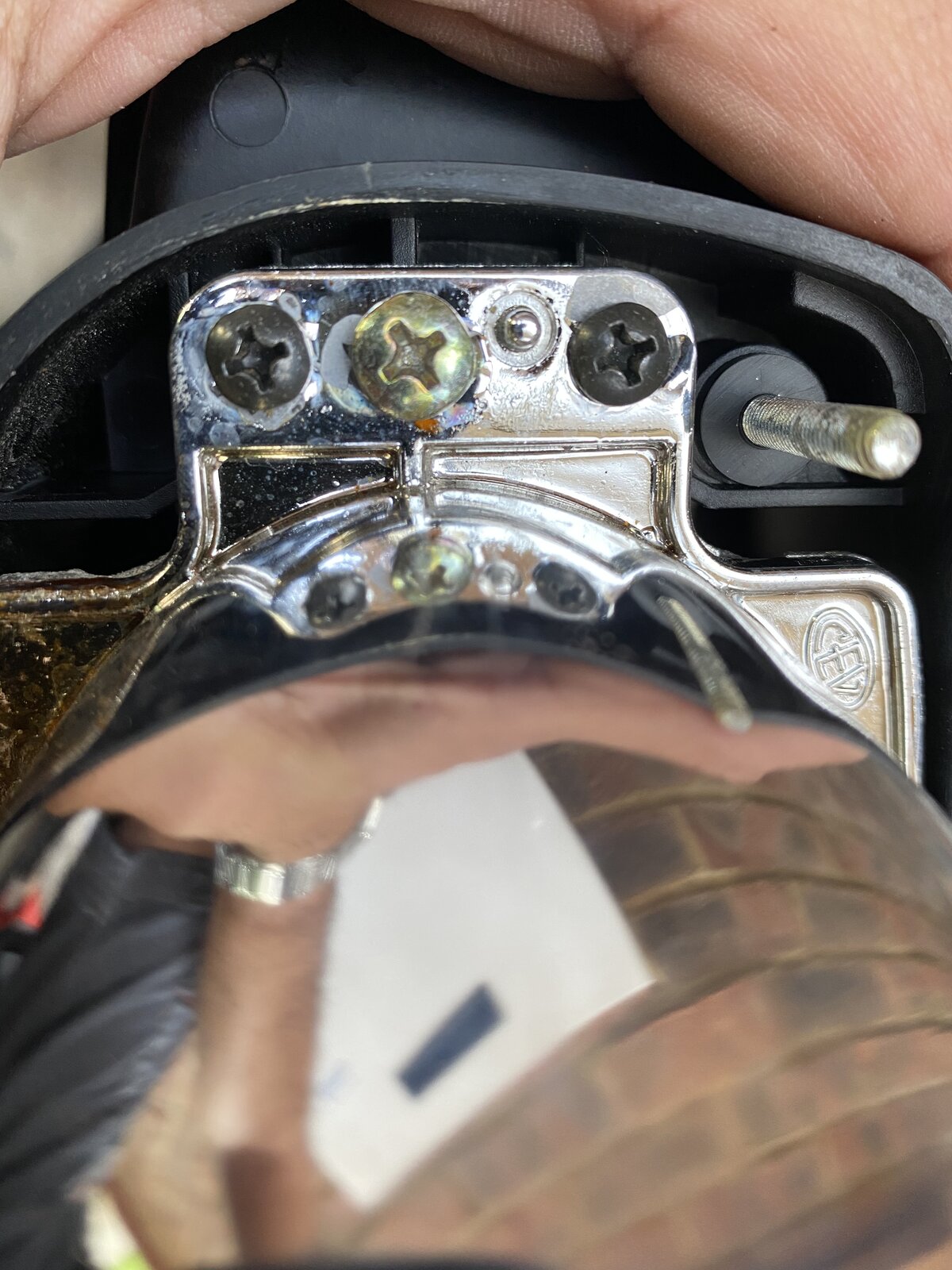

    As mentioned, stay well away from the chrome reflectors, the coating is very thin and prone to peeling.

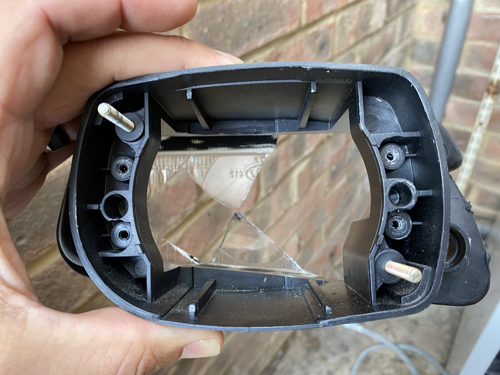

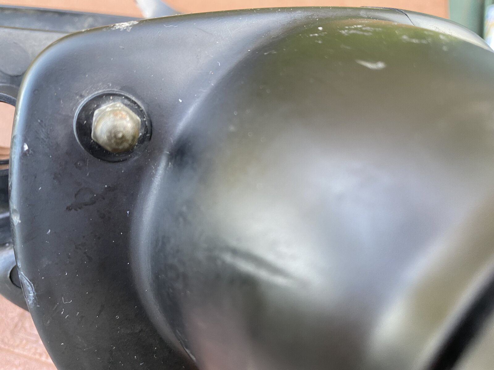

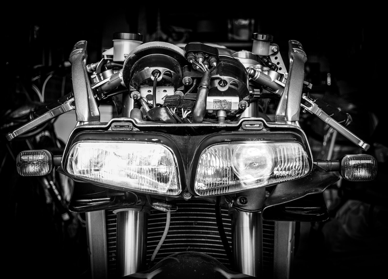

    to access the dipped beam you need to remove these two 8mm nuts (could be 7mm , can’t remember)
    B6AE8E15-283A-46CC-B4E9-1A6FB588937E.jpeg FD07048E-B9F3-4E55-8826-F753979B8178.jpeg

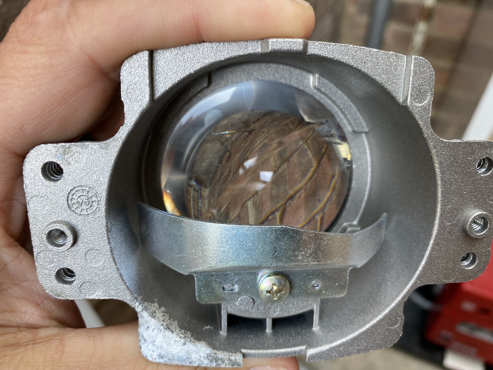

    that will expose the projector unit. There are 6 screw in total. The 4 black ones hold the projector into the headlamp , the middle two gold ones allow you to remove the back of projector to clean it properly.
    after removing 4 black screws you can remove complete projector and clean main headlamp lens with glass polish.
    access to the main beam glass requires the bulb holder to be unscrewed and a long implement used to clean the glass. I use a wheel cleaning brush which is a long thin paintbrush type thing with a round 1” brush on the end. That allowed me to clean main beam glass properly

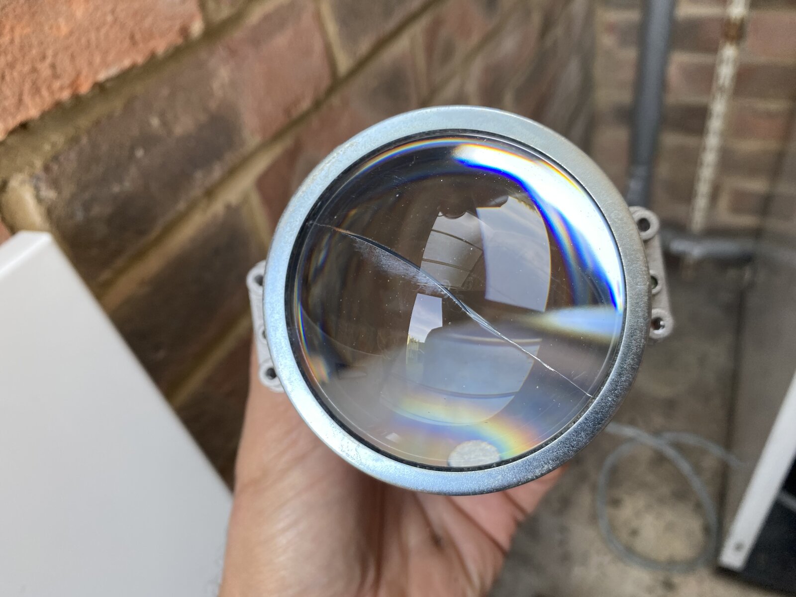

    once you have removed projector unit you can clean the front off it (ignore broken glass, this is an old light I used for the pics
    And once you remove the two gold central screws , the back comes off and you can clean inside the projector too which gets equally as dirty.

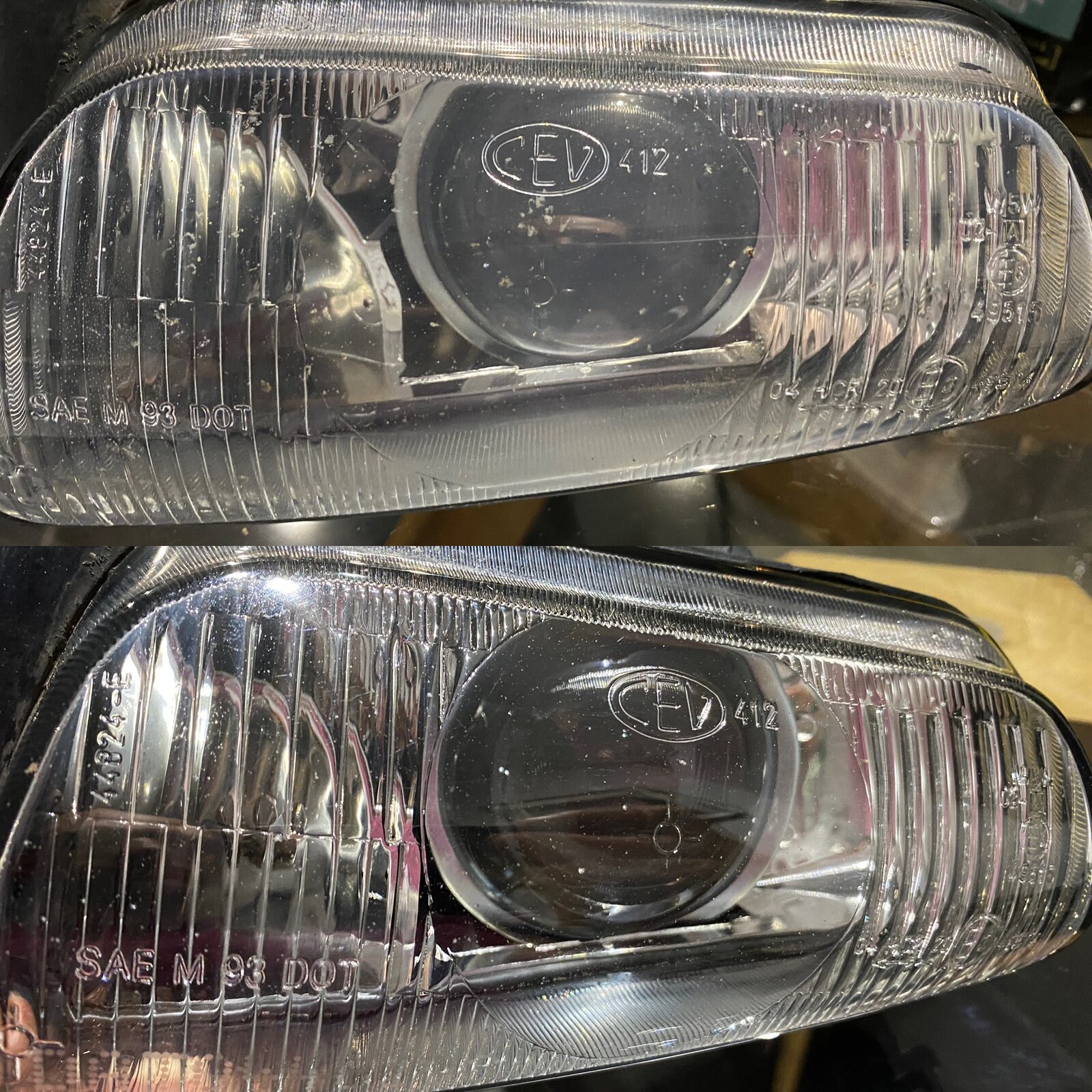

    a couple of before and after comparisons and my lights were barely dirty at all to begin with

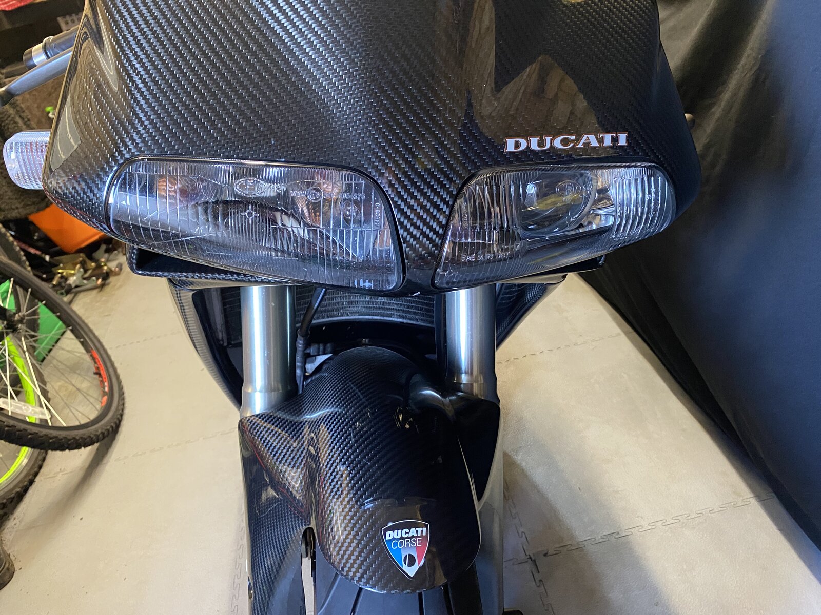

    255F18C4-7FA6-46FE-8599-C7085BEBFED3.jpeg 7D97776B-0642-49DC-A05A-E0D8DD906F50.jpeg

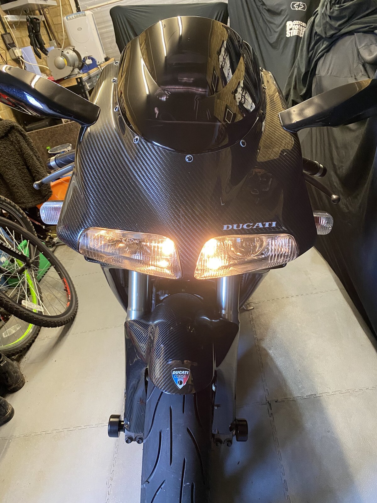

    And back on the bike.
    E2077D92-7B1C-422A-A5D9-109F259F6067.jpeg 54198EC2-F4EC-44DE-A2F0-2DD6C03D1213.jpeg

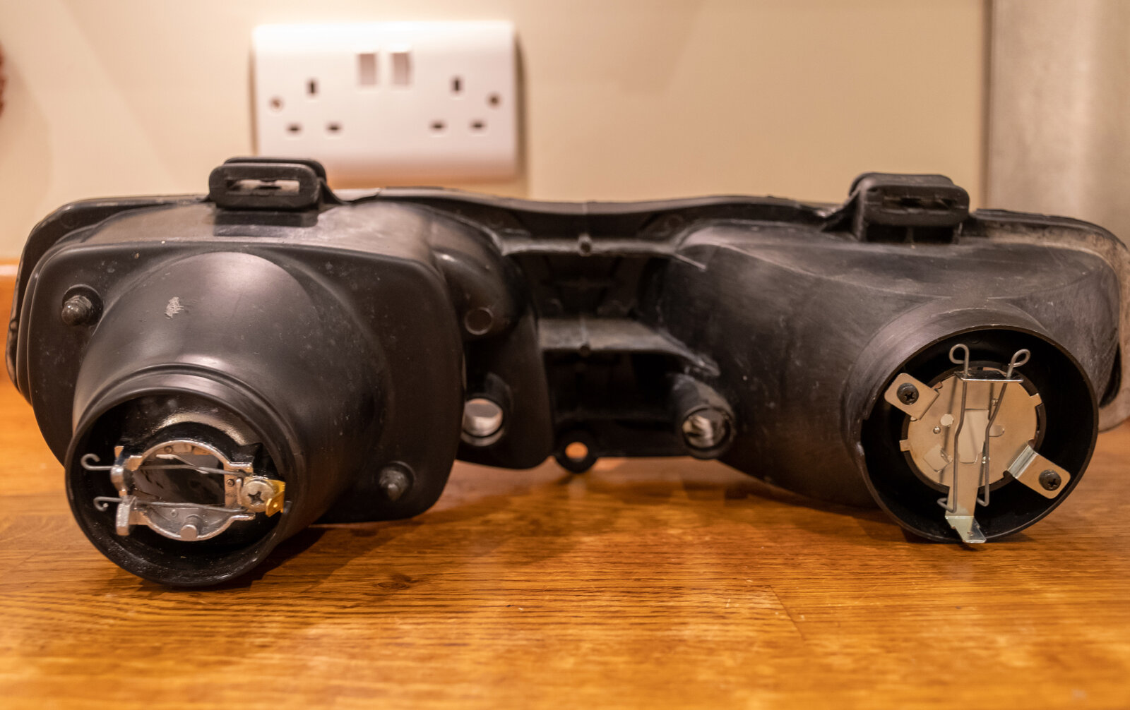

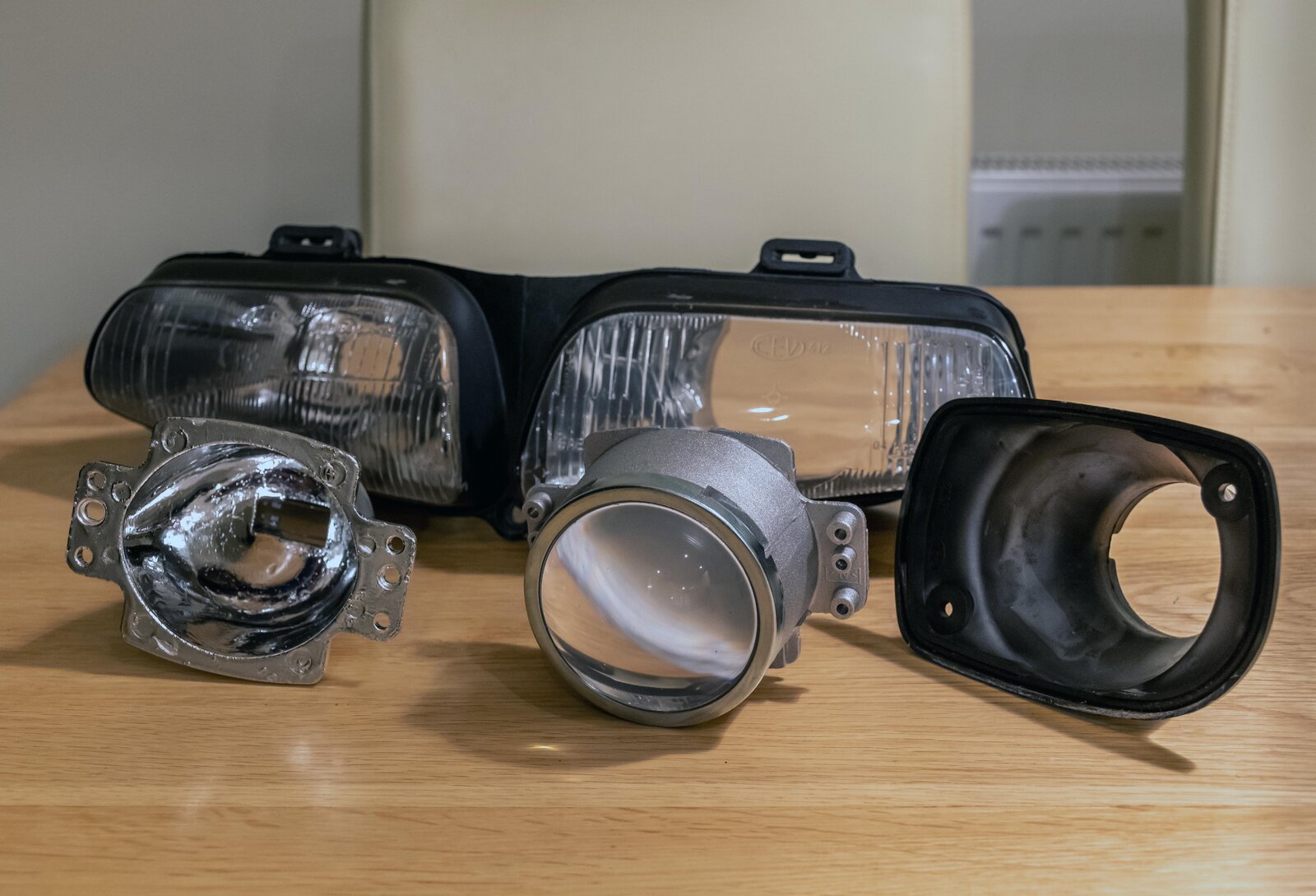

  12. So this evening I've removed fairing, nose cone and the headlight unit!
    Thanks to @Chris for his advice and @Slingy123 for the really helpful photos. Tomorrow, time permitting, I'll take the dip beam assembly apart. Wiring to dip beam also looks a bit dodgy so good opportunity to tidy that up.
    When you've been sat in front of two screens all day this is quite therapeutic!
    Cheers
    Neil
  13. Disassembled :)
  14. Glad you’re doing it properly. It’s far more satisfying that way.
    Definitely don’t touch that chrome reflector, it’s looking a little flaky already and will peel as soon as you touch it !

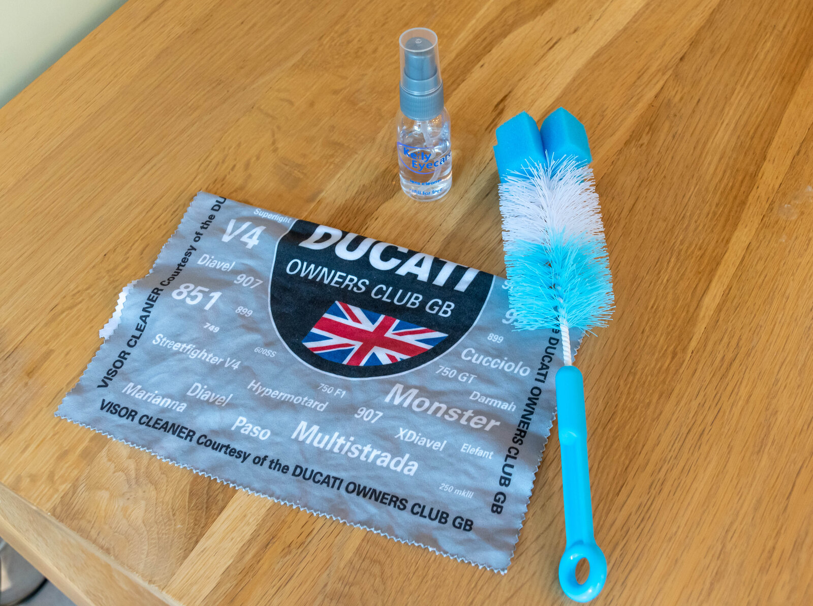

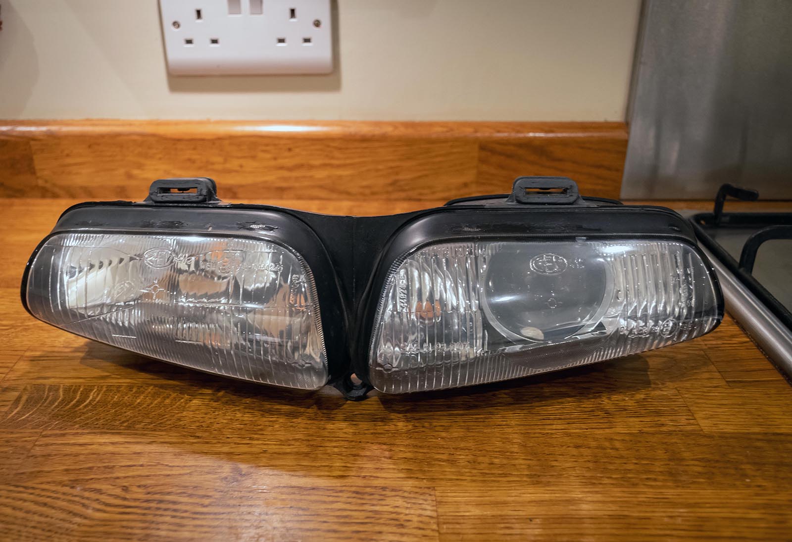

  15. So cleaned the inside of the reflectors with this brush with the Ducati Owners Club visor cloth (knew it would come in handy!) wrapped around it and a lens cleaner spray that the optician gave me (ethylene glycol monobutyl ether). The internal lens in the dip beam got a very careful wipe and I left the chrome reflector well alone.
    I've just realised that the wiring loom for the headlights detaches really easily - I'd removed the connectors at the bulb and side lights leaving the wires attached to the bike - Doh!. At least I can now reassemble it all off the bike which is much easier.
    So my conclusion is that even changing a bulb is easier if you remove the whole headlamp assembly rather than trying to fiddle about with it in situ.
    Final assembly and attaching to the bike tomorrow. Thanks for all the advice.
    Neil
  16. Much brighter! I did buy some new bulbs.
