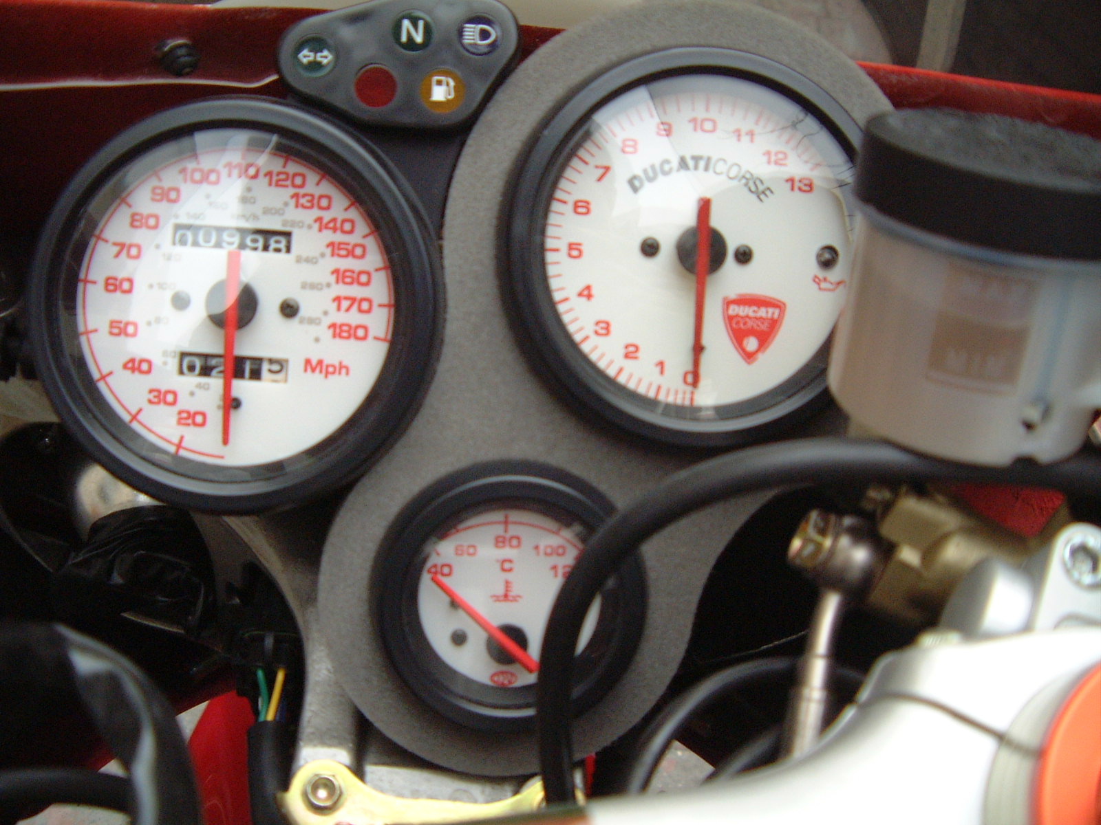

  12. A friend of mine used to own Superdials before he sold the business to Lockwood Dials. He showed me a couple of times how to dismantle the front bezel on both a 998 speedo and also on a temperature gauge. He was an instrument repairer by trade so he had the right feel for the job, it's not really for the faint hearted!
    He would pierce the side of the bezel with a small soldering iron tip by the bezel ring enough to put a blunt bladed knife into the gap, very much like a small letter opener. He then carefully prised around the bezel ring cracking the glue away as he went. Clearly he was experienced at it as he could get the ring off in a matter of minutes with no damage.
    To put the bezel back on he used an epoxy glue that while waterproof was soft enough to be broken again after the bezel had been put back.
    Here is the result of the dial faces he changed on my 998. The mileage incidentally is coincidental but you can see the clocks were clearly quite new when he did this.
    I did suffer a crack in the temperature gauge bezel after a few years and he used the same method to replace the bezel with one from a spare gauge I had, so the glue he used was totally correct for that application.

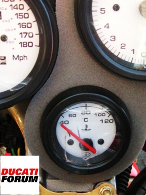

  16. Red, in 10 years I have only seen two 748/916/996/998 bikes with white clocks, yours in the picture on this thread and mine as fitted to my 748 when I bought it. I have the temp gauge problem and a spare one to donate the 'glass' but was too faint hearted to do the "damage". Were the clocks supplied white as OEM or were they modified?
  17. I'd be interested to know what you think of his work as I too think that he knows his stuff and seemed quite happy to take on the work that I have lined up for him.
  18. Mine are a copy of Ducati Corse Items and were made up by Rob Driver when he owned Superdials. I was there when he made up the whole set from scratch, he allowed me to watch all his methods including being involved in the design and screen printing of the dials.
    As mentioned he sold the business to Lockwood, so they should have all his design work and the program\s that he used to create the dials. He used an oldish Apple Mac at the time to do all the design work and then screen printed the dials and painted the needles by hand to match.
    http://www.lockwoodinternational.co.uk/dials/mph.html
    You can see from the link Lockwood now Incorporate Superdials into their business logo and are known as Lockwood International Superdials.
