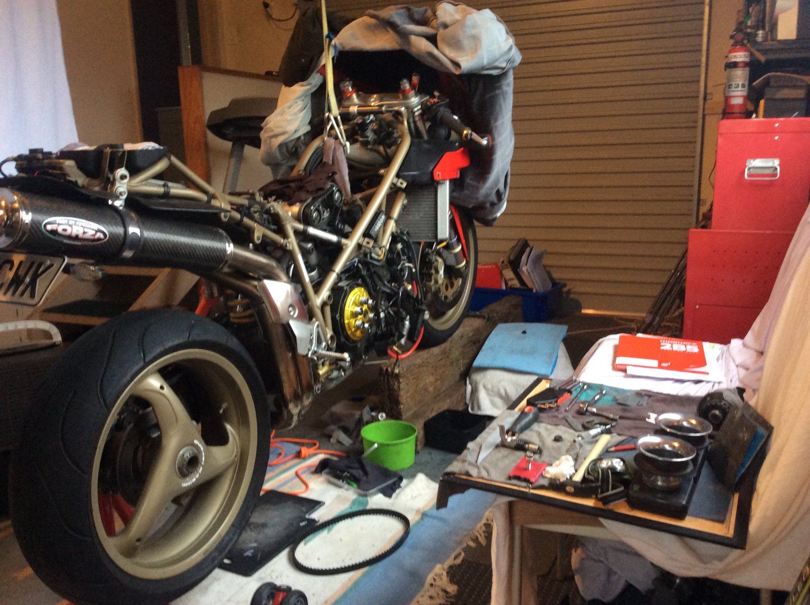

Yea well I've torn my knee and waiting for a op so off work,so I'm bored as.I have had the bike for just under a year and not a lot of history came with it.I have it supported so I can work on it with a dodgy knee doing belts as well.
