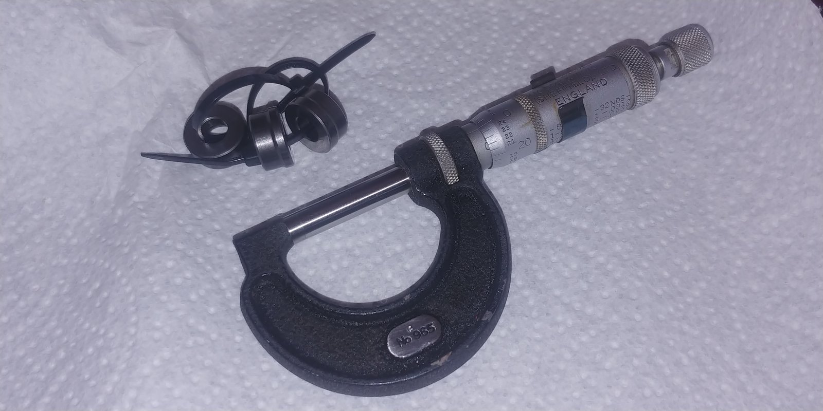

Multistrada 1200S 2010. I am in mid service and three inlet valve closing clearances are out of tolerance. I have removed the shims and have found that one is clearly marked as 2B 3.20 but the other two are devoid of all markings. The inside shoulder is curved to match the retaining collects so I cannot use a micrometer to measure the shim size - does anyone know how to measure this dimension?
Buy a shim measuring tool that fits into the closer, you subtract 10mm from the measurement. You need one for 7mm shims. The one for the openers isn't really necessary. https://www.lasertools.co.uk/product/7311 https://www.ebay.co.uk/itm/Valve-Cl...183321769318?_trksid=p2349526.m4383.l4275.c10
