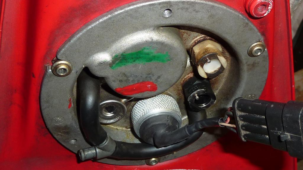

  1. As title a bit heavy handed, in need of a fuel sensor fixing nut for the 748, the usual problem with a slight leak, so decided to nip it up and yes you guessed, it snapped the flimsy plastic nut.
    Is there a metal or ally replacement, if not has anyone got a spare plastic one and last of all can they be purchased separately from the complete sender unit.

  10. Done a small batch for Steve, mine and a couple of others that are spoken for.
    Will make some more soon. Hopefully within two weeks.
  11. Perfect fit, great job Andy, can't thank you enough.
    Steve
  12. Well here it is fitted, a bit fiddly removing the electric plug to fit the nut, a bit of patience required.
    Left on blocks overnight to check for leaks and pleased to say all's well and back on the bike.

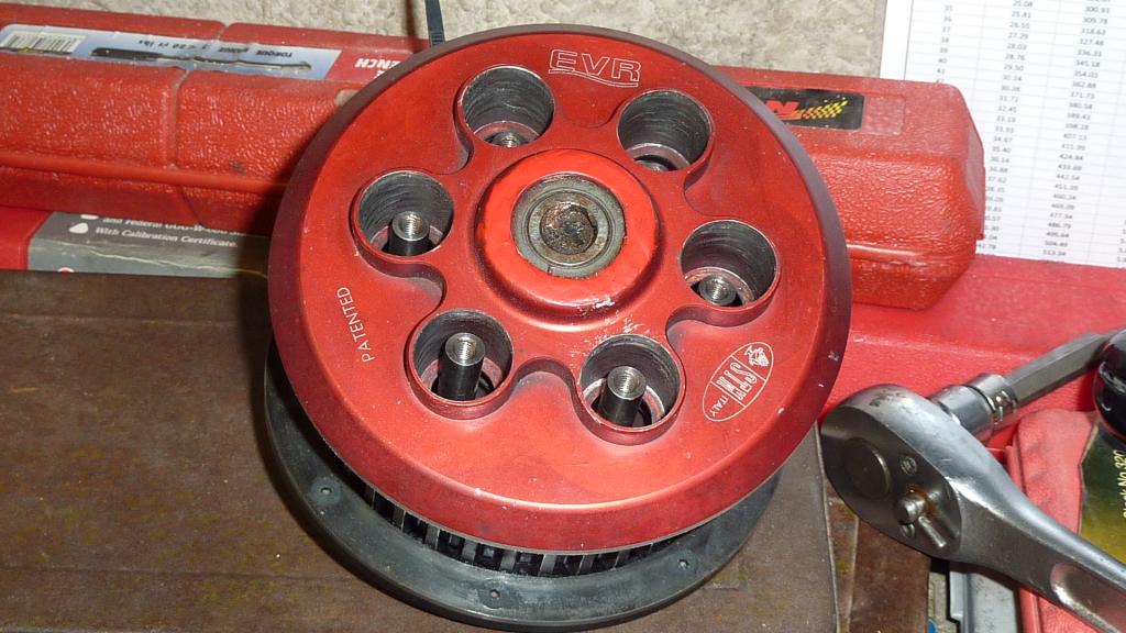

    Haven't a clue how the clutch got there and cant remove it.
    It is mine.
