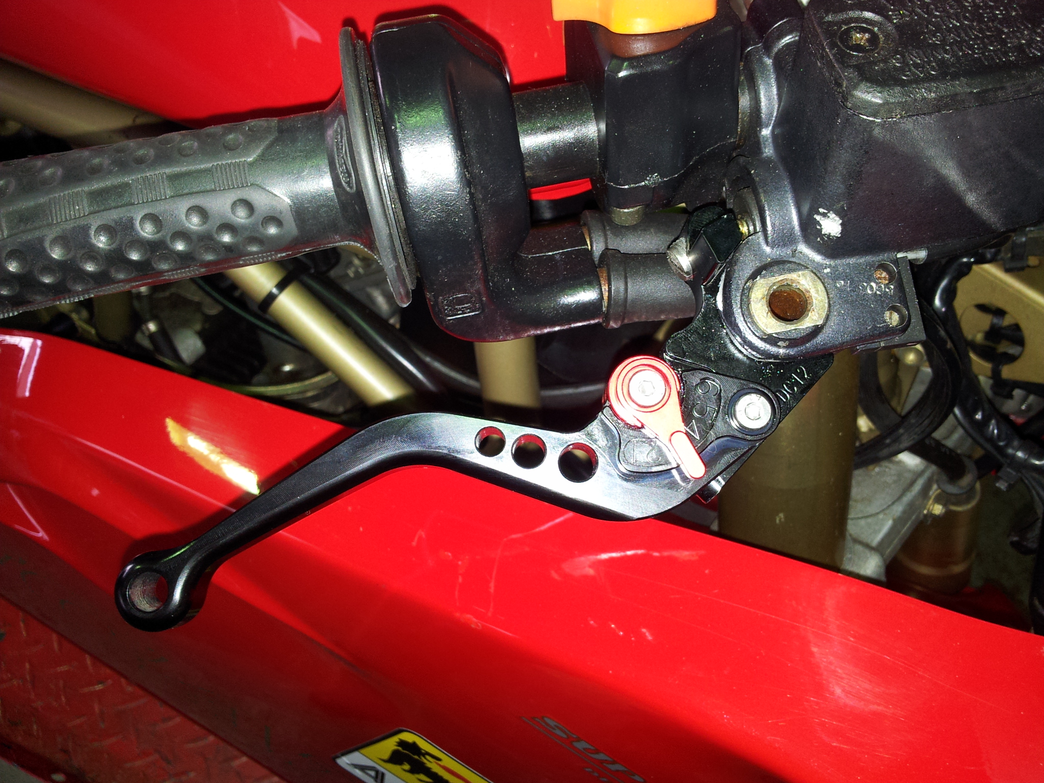

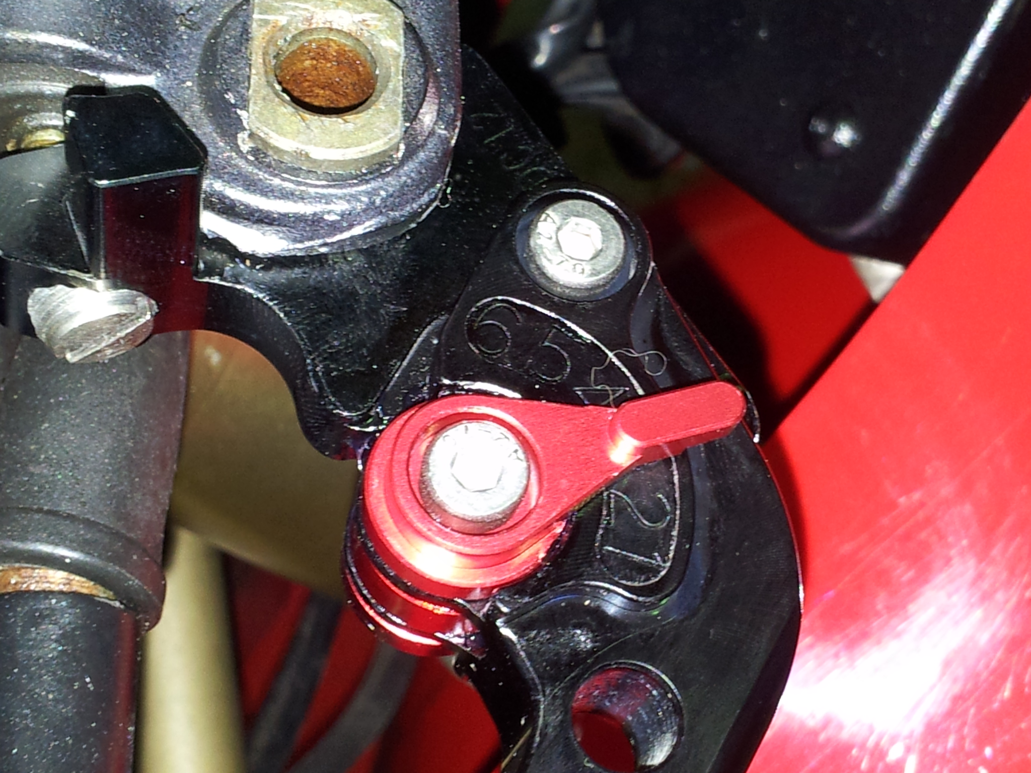

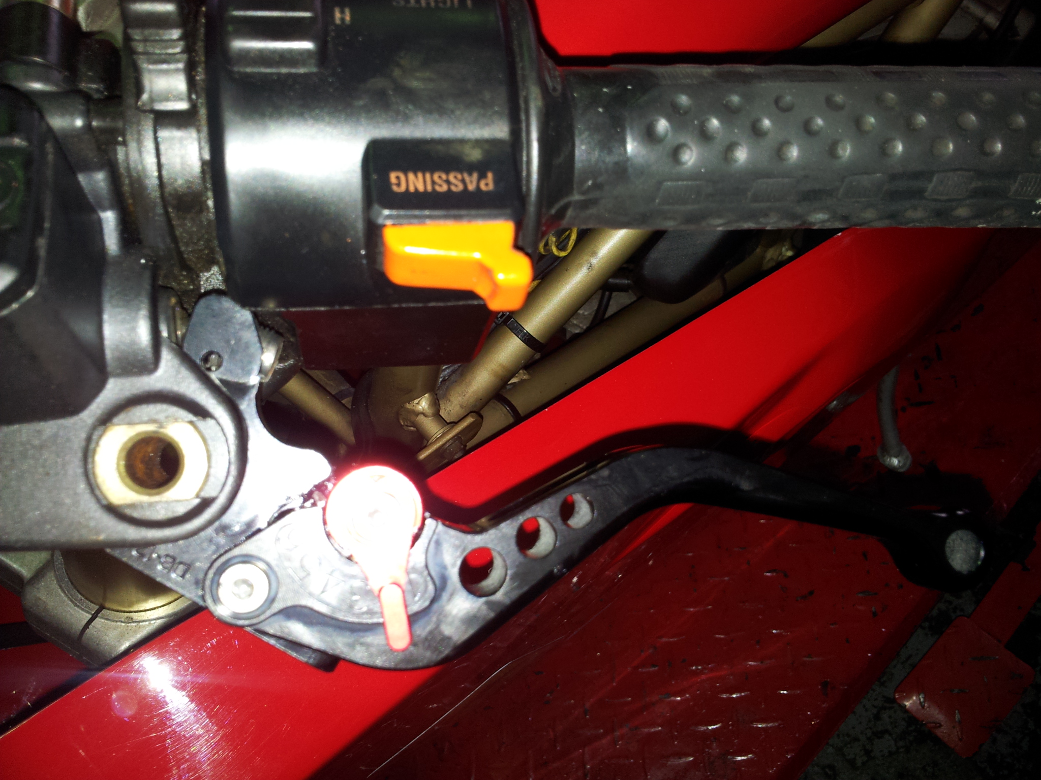

Well they have arrived and been fitted and fit with no issues except the clutch and brake mtg bosses we're on the wrong side so entailed dismantle and swap over went for a short ride and all worked well they look good and cannot fault the quality very happy with em and even as shorties do not affect clutch pull etc. pics below
