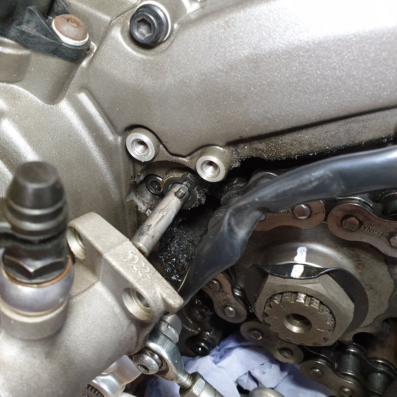

    Help please. Discovered my 2015 MTS has started leaking fluid from the slave cylinder. Looking at the workshop manual I assumed it would be the two O-rings which would need replacing. With new O-ring to hand, I set about removing the slave cylinder.
    Once removed, there is no sign of any o-rings on the shaft nor in the slave cylinder.
    put it back together, any thoughts help would be greatly appreciated before contacting dealer.
    regards....... john.

  4. No I didn't, I expected to find a couple of grooves on the shaft for the o ring to sit in but nothing. No sign of any o rings at all 20190726_171426.jpg
  5. They are at the other end of the shaft. Andy
  6. Forget the O rings, if your clutch fluid is leaking it's the slave piston seals. You'll likely need a new complete slave cylinder
  7. Thanks Taskmule, I'm starting to suspect that is the case. Logically, the main piston seal is the only place the fluid could be coming from. Looking at posts on here a lot of people have replaced the standard with Orberon cylinder. Could be the way forward!

  14. I had a same problem, just take out completly long shaft (number 16) and you see a o ring on it probably o ring has been damaged or cracked just change it.
