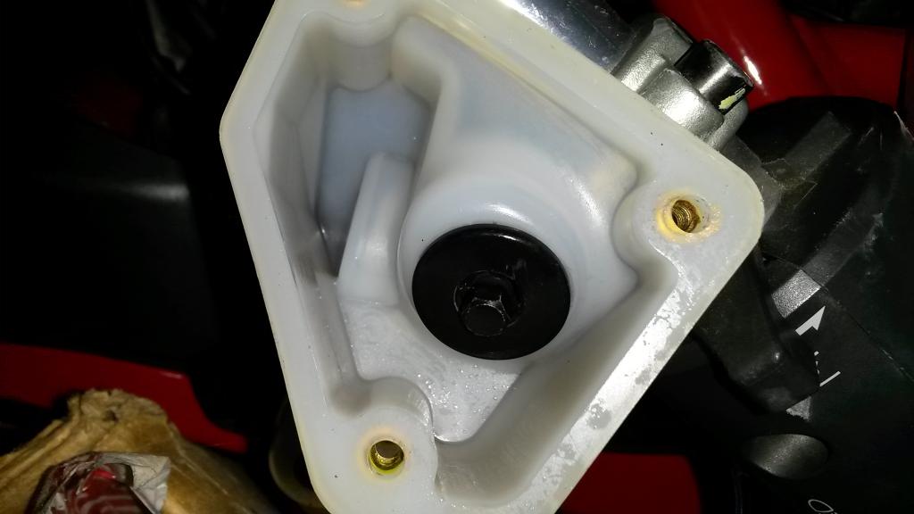

  16. Just skimming previous threads....I have/had (not yet tested) the same issue of not being able to get neutral on my 749, then the bugger stuck in 4th. Fluid was like Guinness, so i guess the PO neglected that one. The fluid reservoir was a shambles.
    Before and after
  17. I've found the same, that the reservoir had some black residue on the bottom.
    I cleaned that out last time bleeding.
    After about a week or two the same issue came back though... again loss of pressure...
