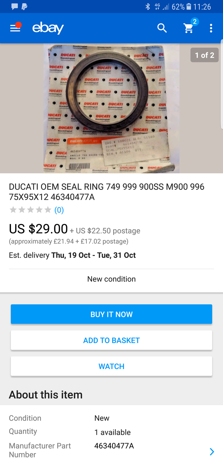

  4. I can't remember if I got seal this from Ducati, I'm sure I used an SKF which was a bit cheaper than OEM. Sizes are on below listing and I have checked with Stein Dinse 75x95x12.
  5. $29 is a bit pricey... they're £8.50 from Ducati... ;)
  6. Aye, I'm just using the image to show the details of part number/seal size. I paid less than a tenner.
