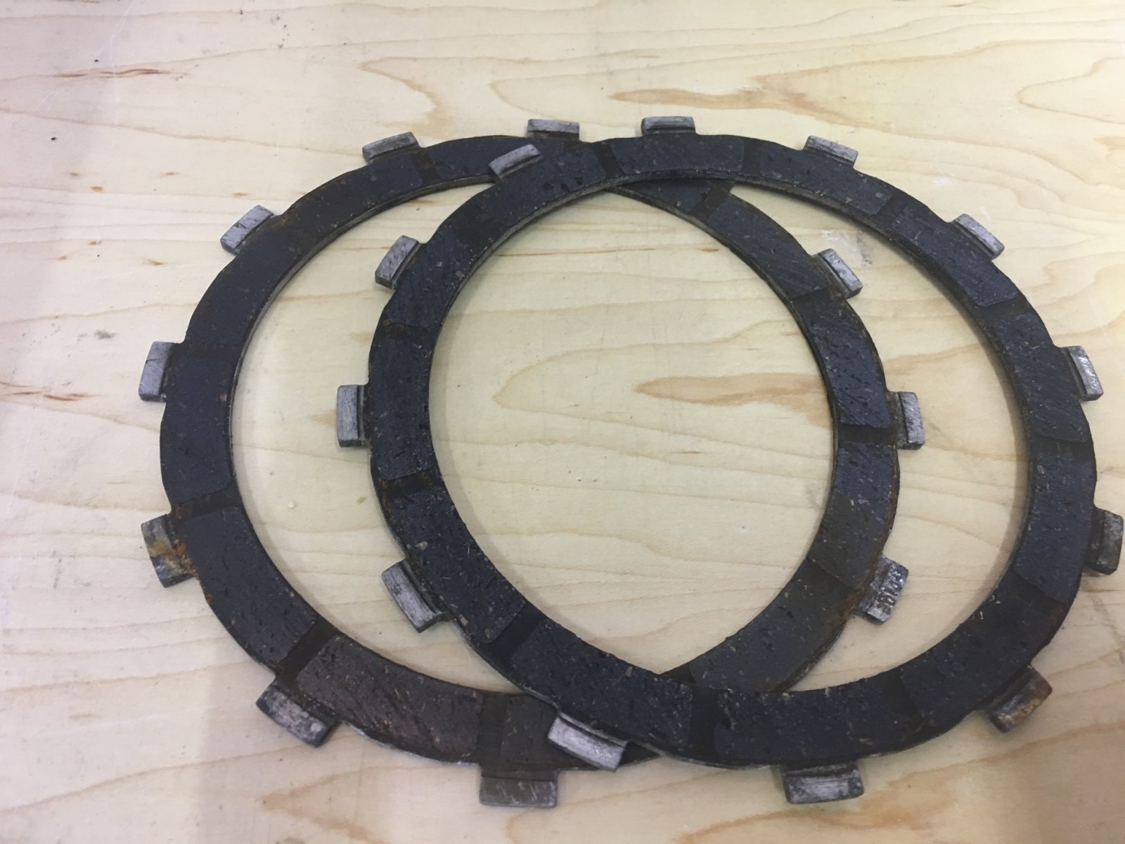

  2. Are these any good for you Rick? I've never looked into this mod, is it the friction plates you need?
    Pop me a PM with your address and I'll drop them in the post for you. (or the steels if it's these you need)
  3. that's a really nice gesture ^ ^ (yes, it's a friction plate that's needed for Q.C. mod)

  10. I've popped them in a jiffy bag and dropped them in at the Post Office for you Rick (luckily it's open till 11pm).
    They should be with you early next week. Have fun. :upyeah:
