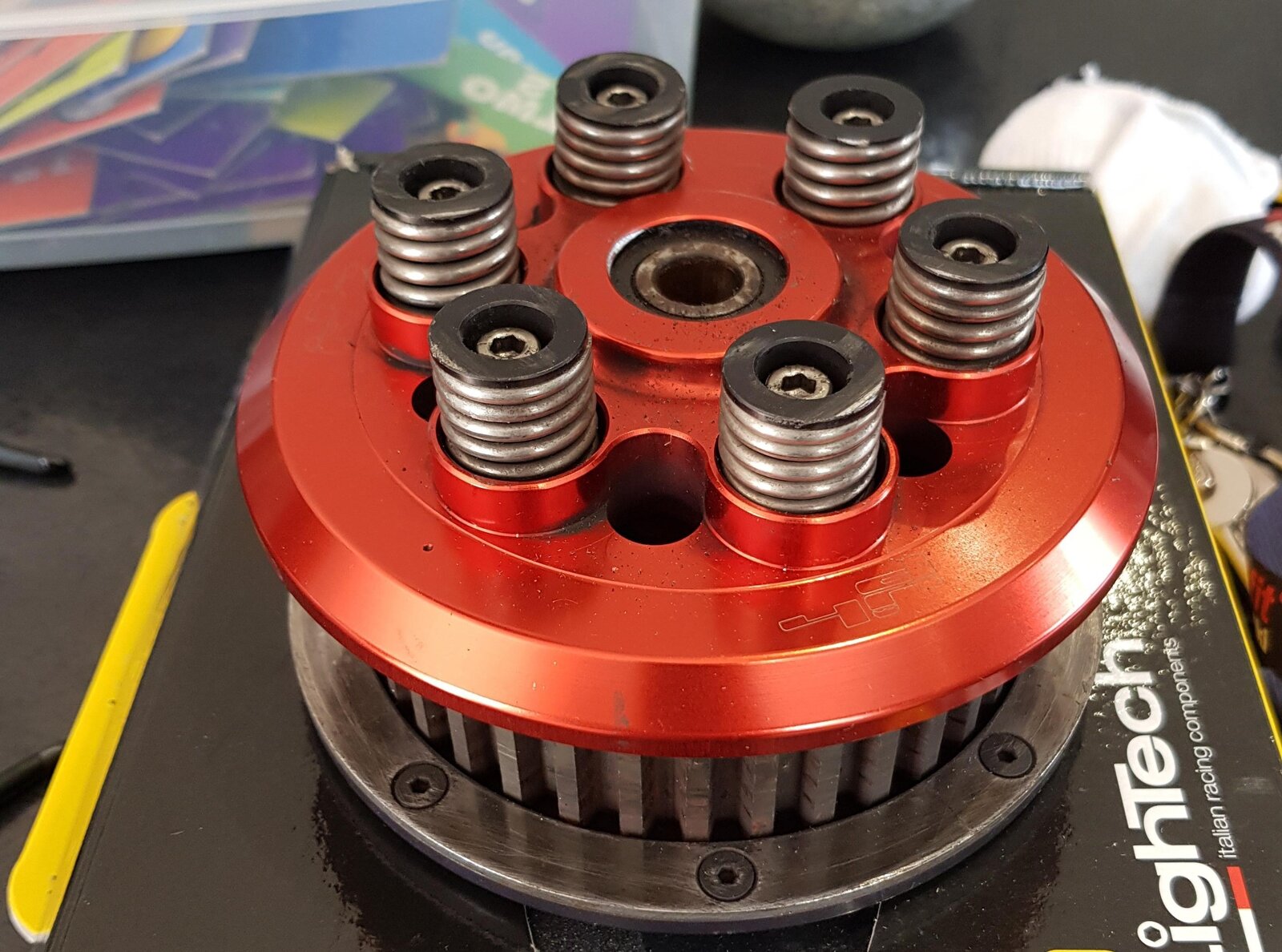

  1. Took a punt on a box of bits from ebay and had a hunch that this might be a slipper clutch, turns out I don't think it is ! It does have a rather nice JHP pressure plate (I think that's what it's called).
    Is this something that's easy to fit and compatible with the OEM clutch on my 996s that I could fit, I've got a nice Casoli open clutch cover I've never fitted, or should I just clean it up and put it back up for sale ! ?

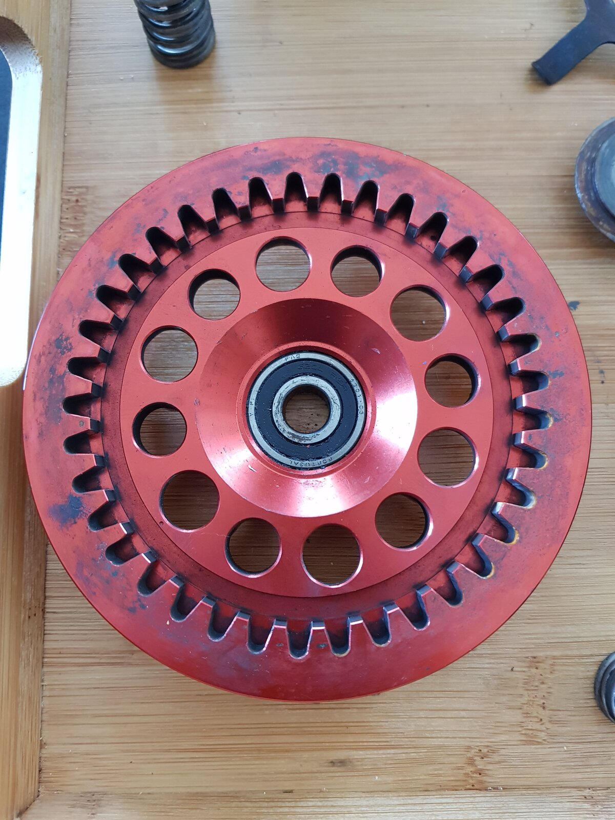

  2. Are there teeth on the underside of the pressure plate? If not, then the plate is at least a slipper one.
  4. It is a nice pressure plate and will replace the stock grey one if you want a little bling. I would keep the other stuff as spares. Did it come with a basket? That will be handy as it's a consumable part

  8. The external surfaces of the pressure plate bearing race are rusty so I'd fit a new one and your spring retaining caps have come into contact with a clutch cover whilst rotating. You need to compare the relative wear of what you have to what you bought and go with the best ...... which might not be the one you bought. Steve is correct, there are 3 different lengths of outer cover bolts. Andy

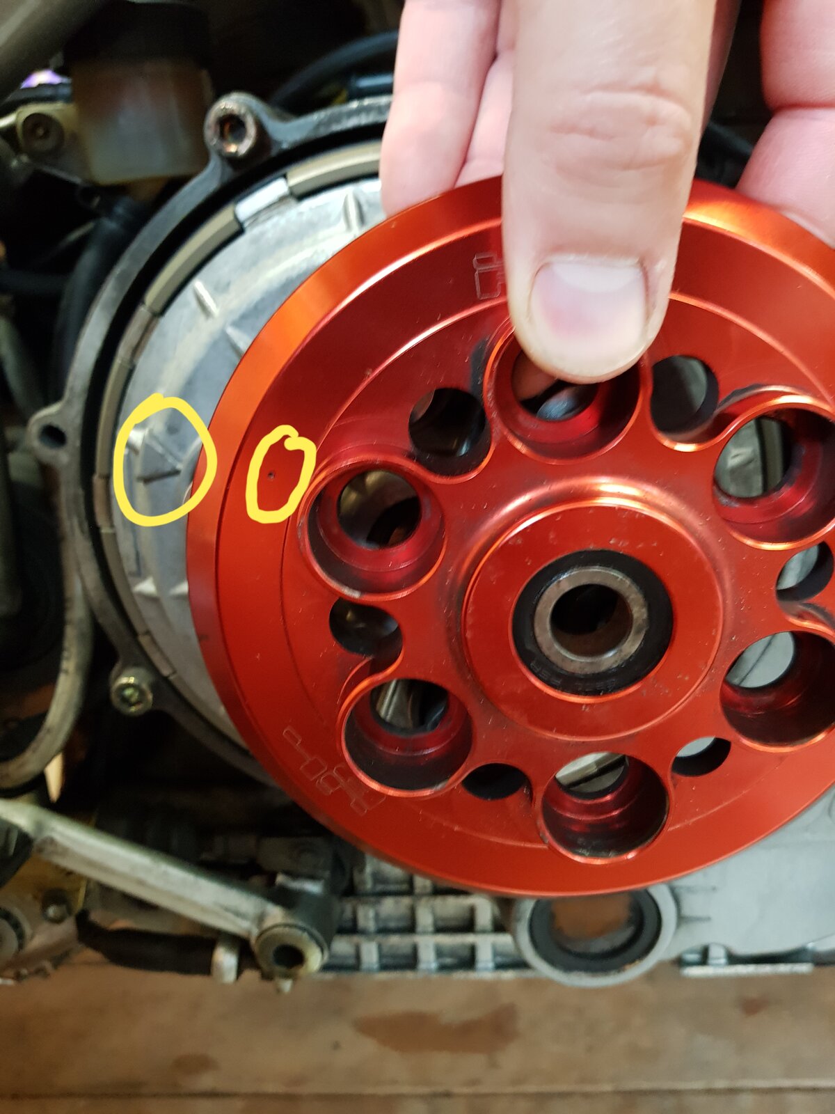

  10. Ok so clutch cover off, is the dot on the JHP pressure plate corresponding with the arrow on the oem grey plate ? So remove springs and cap. Slide off oem plate put JHP one on with the dot in the same position as the arrow was, put springs back and hand tighten to nipped up ?
  12. The dot should line up with one of the pillars the pressure plate bolts go that has a groove in it, then yes finger tight bolts then nip up. 748clutch8_LI.jpg
  13. Dot should line up with the groove.
