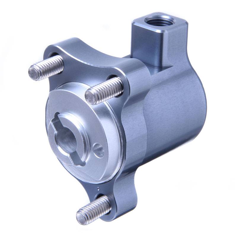

  5. The slave appears to have provision for the pin
  6. When you put the rod into the slave cylinder does it go in far enough for the pin to locate in the slot ?
    if not you could have a space stuck in the cylinder and may need a magnet to pull it out.
  7. Once lined up , it will press all the way in
    I think it is something stupid , the spacer is in there but measuring the 2 rods , they are the equal length, only difference is the pin
    Will have a go at it again tomorrow
