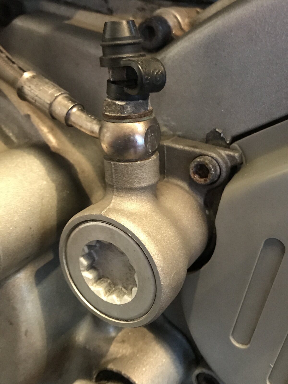

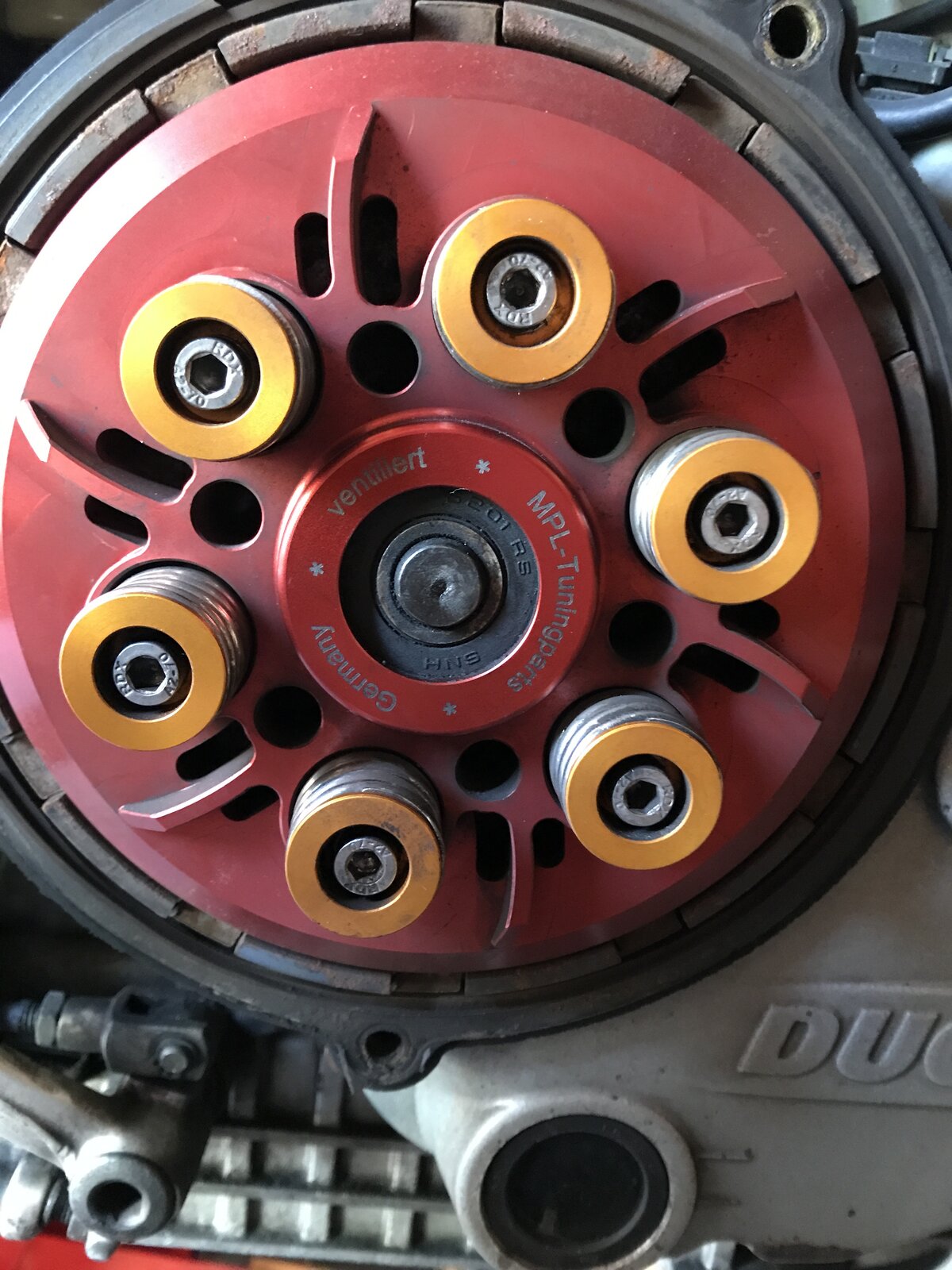

  1. My clutch was very heavy so have been running on 4 springs, which does make it easier on the wrist. Was wondering if switching the stock slave cylinder (pictured) to an Oberon would make much difference?
    Also, I don’t think my clutch is standard so wondering if this MPL (see pic) is any good?
    thanks

  2. As Sev said. Clutch pack is probably std and previous owner added the bling pressure plate?
  3. it looks like you have stainless steel springs which will almost certainly be contributing to a heavier action, sometimes as much as 30% of total lbf/inch depending on wire gauge.

  4. I agree. I have standard master and slave cylinders and 6 spring slipper and my lever is no problem in stop/start traffic. I have standard steel springs
  5. Ahh... that’s really helpful, thanks. I’ll look into that and see what other spring options I have. Many thanks.

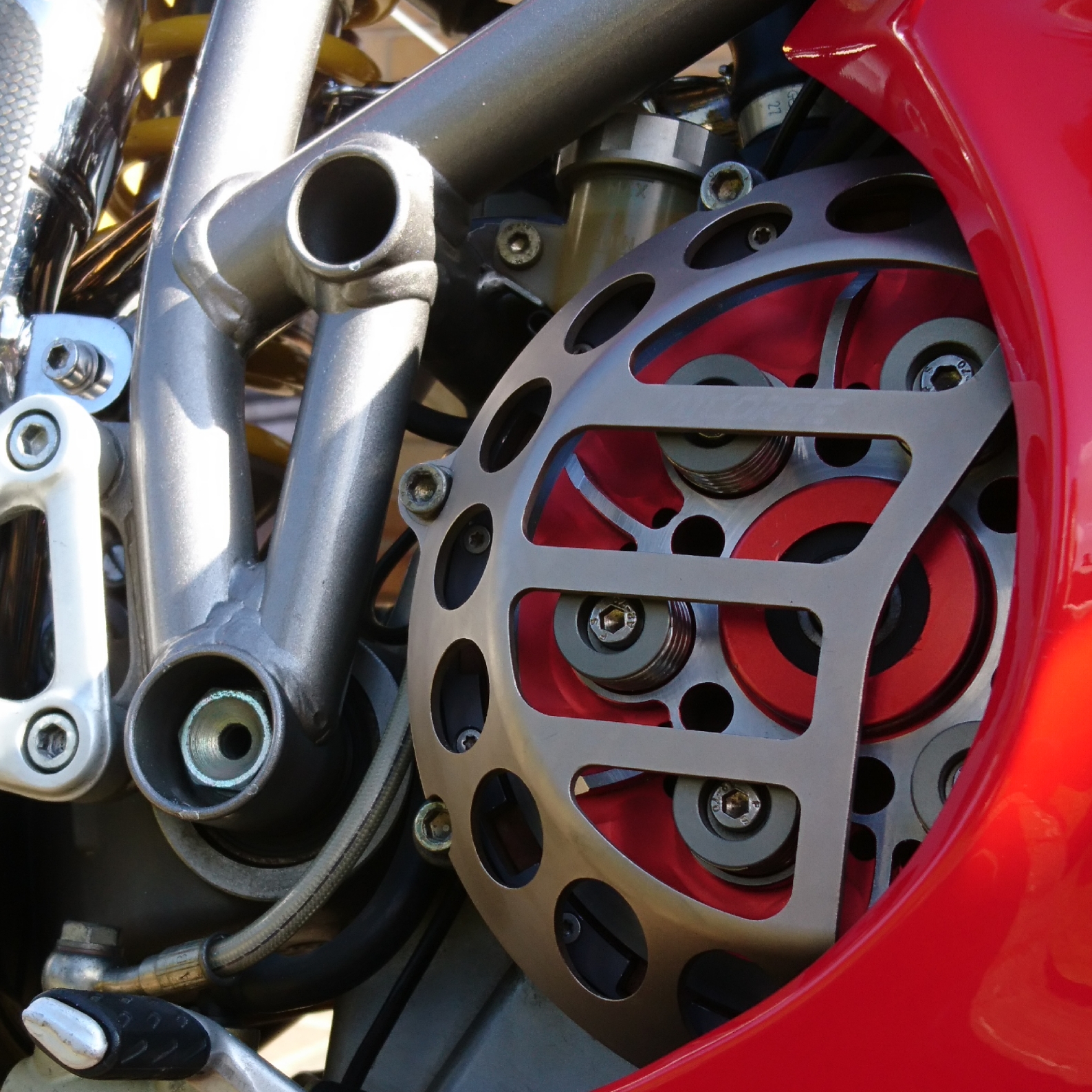

  6. For question two. I've been using both mpl pressure plate and basket with standard plates for the last 30000ish miles with no issues, so yes

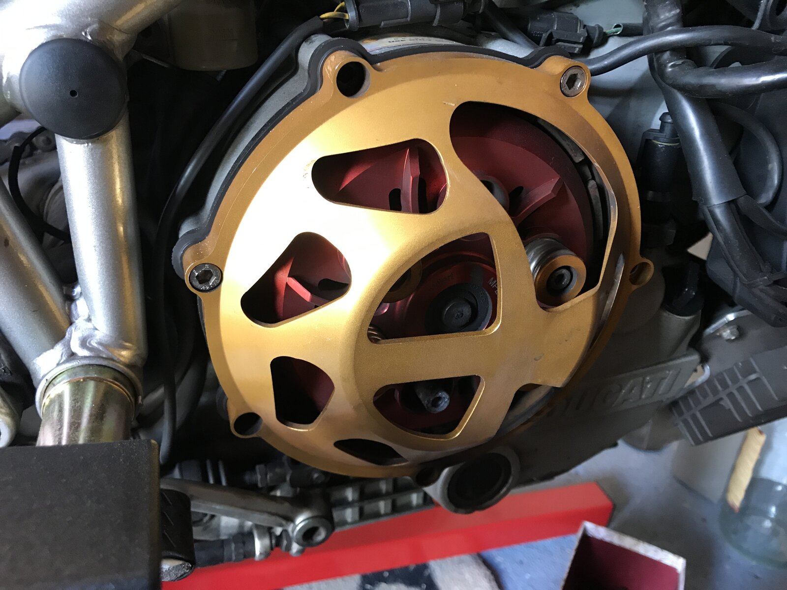

  7. Two pics ?? Can't edit it either. It's not spot the difference, just so you know...:p
