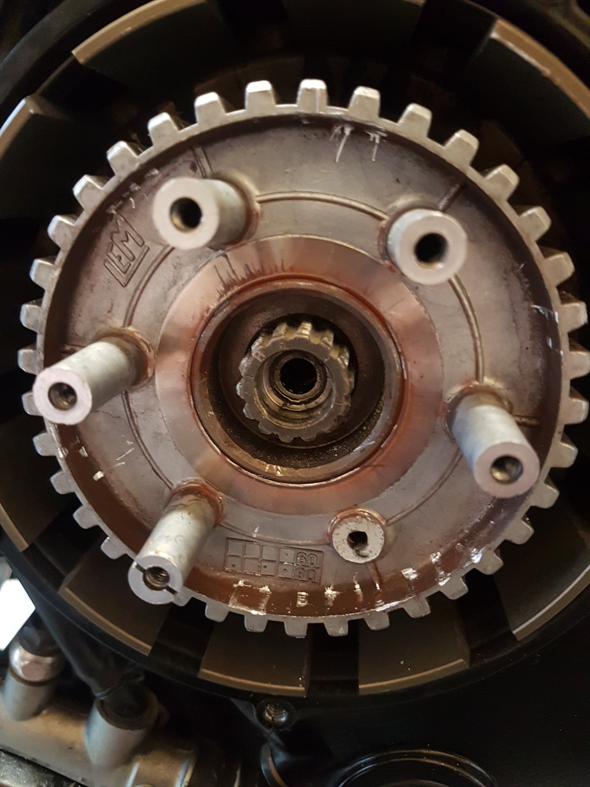

  1. Am i right in saying i have this stripped enough for the main clutch shaft to slide out?
    Its solid still.
    Tried videos on YouTube cant see any similar to mine.
    Any help will be greatly appreciated
  2. Recently experienced by another forum contributor. The use of a rubber mallet resolved it. To be fair you just need to break the metal to metal bond resulting from being assembled for a long time. Andy
  3. so im right in saying that the centre bit that has teeth doesn't unscrew off etc the unit in theory should just come off now?
  4. Yes, you are right it should just pull off. Andy

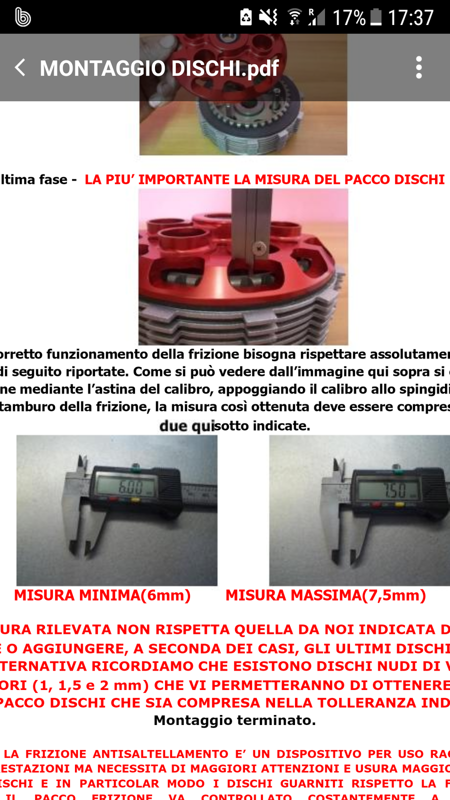

    My next issue is i have fitted the new slipper clutch its a kbike one.
    But not its fitted my clutch lever has no stiffness at all like its not reacting slutch springs arnt de compressing
    Any ideas?
  7. Did u put the rod back in?
  8. Yeah i put the rod back in.
    The only thing i think im unsure about is the dish shaped washer im wondering if i have put it on the wrong way round.
  9. Have you put the dished plates back correctly ? The ones with the punched mark on them ?
  10. Whats the stack Height ?
  11. hi yes i put the plates back in. according to manufacturer it should be roughly 6.5-7mm
    I haven't checked with a micrometer but it is roughly that when i check with measuring ruler.
  12. I’m hoping the stack height is a typo. If you are using a standard basket which it looks like, stack height should be around 36.5mm. Andy
  13. Im.just following what it says at you measuring it from a different point?
  14. Okay, that measurement isn’t what is usually understood as the stack height :upyeah: Stack height is all the alternating friction and pressure plates measured one on top of each other.
    You might have to go back to basics. The first thing that I would check is that handlebar lever movement is translated into movement at the slave cylinder. If you remove the compression plate, you should be able to measure just how much the clutch push rod moves. In actual terms probably no more than 2mm should be enough. If you can’t see the push rod poking through, as has been suggested, there might be an extension piece missing from the slave cylinder. If you can’t see any movement my guess would be an air lock in the master cylinder on the handle bar. Good luck. Andy
