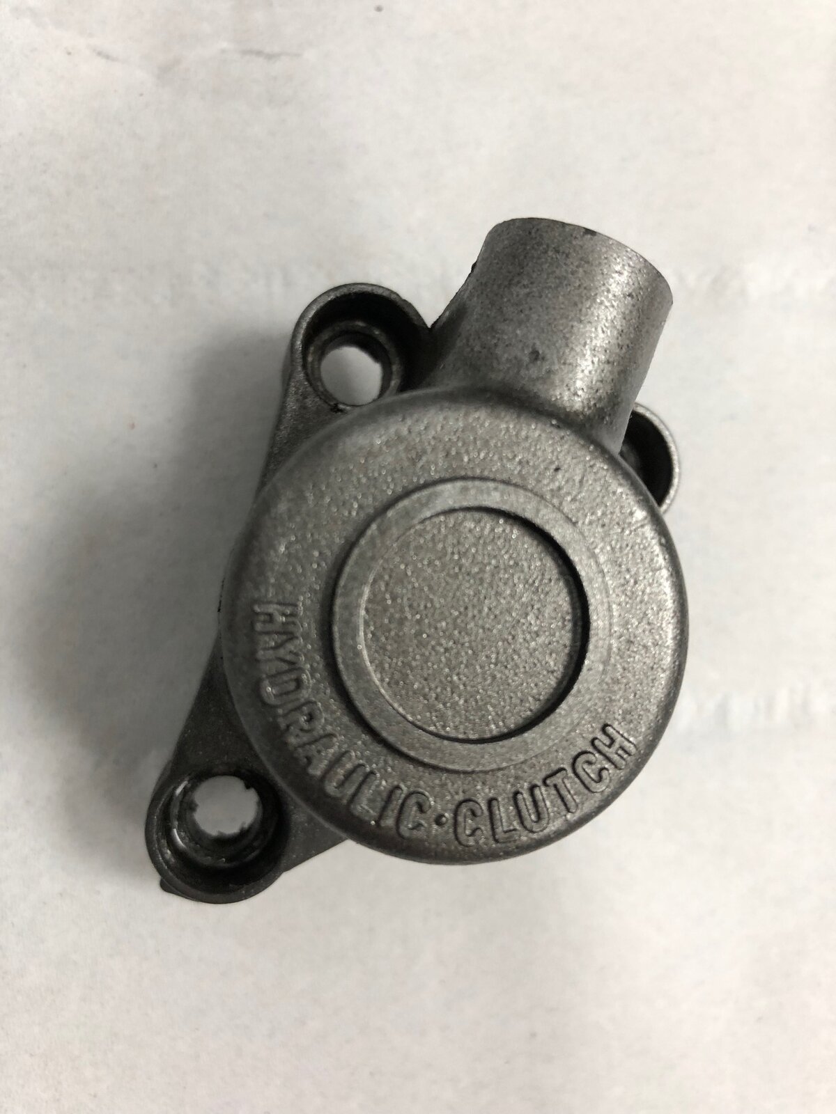

  1. mine is leaking, whats the best way to mend it? is there a repair seal kit? cant find one . there are few units on ebay from later bikes - looks the same but not sure they will fit?>

  3. here is my current slave cylinder . is it correct for the model?
    mine is 1995 Senna Mk1 916 ? most of the others ive seen looks different?

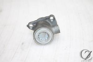

  7. if you can get away with a new seal/bore not badly worn then it's the cheapest fix by far. Yours looks like the early 25 mm unit. If you want to try getting a slightly lighter effort at the lever you could try an aftermarket slave (i'm sure you knew that) or even a secondhand later Ducati unit. (749 is 27.5 or 28 mm which is a nice compromise)
    This is always a compromise as lever will travel further as a result and may not suit you Have done this many times as they can still turn up for £25-30 posted from breakers. As said, you need to determine pushrod length. You can check slaves back-to-back by measuring how far pushrod protrudes in slave with 'piston' pushed to bottom of bore travel.

  8. But it looks different to the one I have on the bike now... or is this one a correct one for 95 senna 916?

  10. it is different but will fit although might need a different length pushrod.
