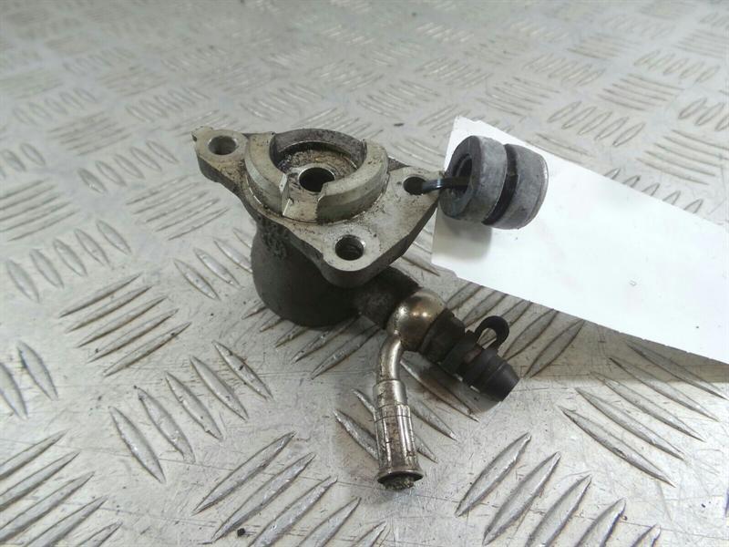

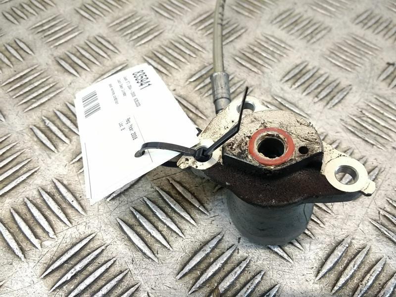

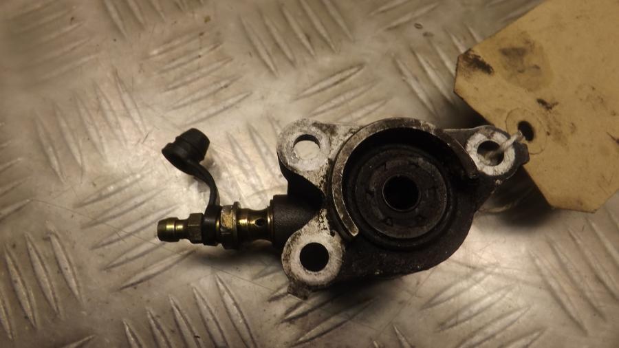

  4. This still leaves concern to me. None of the after market ones look like pic 2 and 3, both of which have a protective collar to stop the shit getting anywhere near the seal I think?

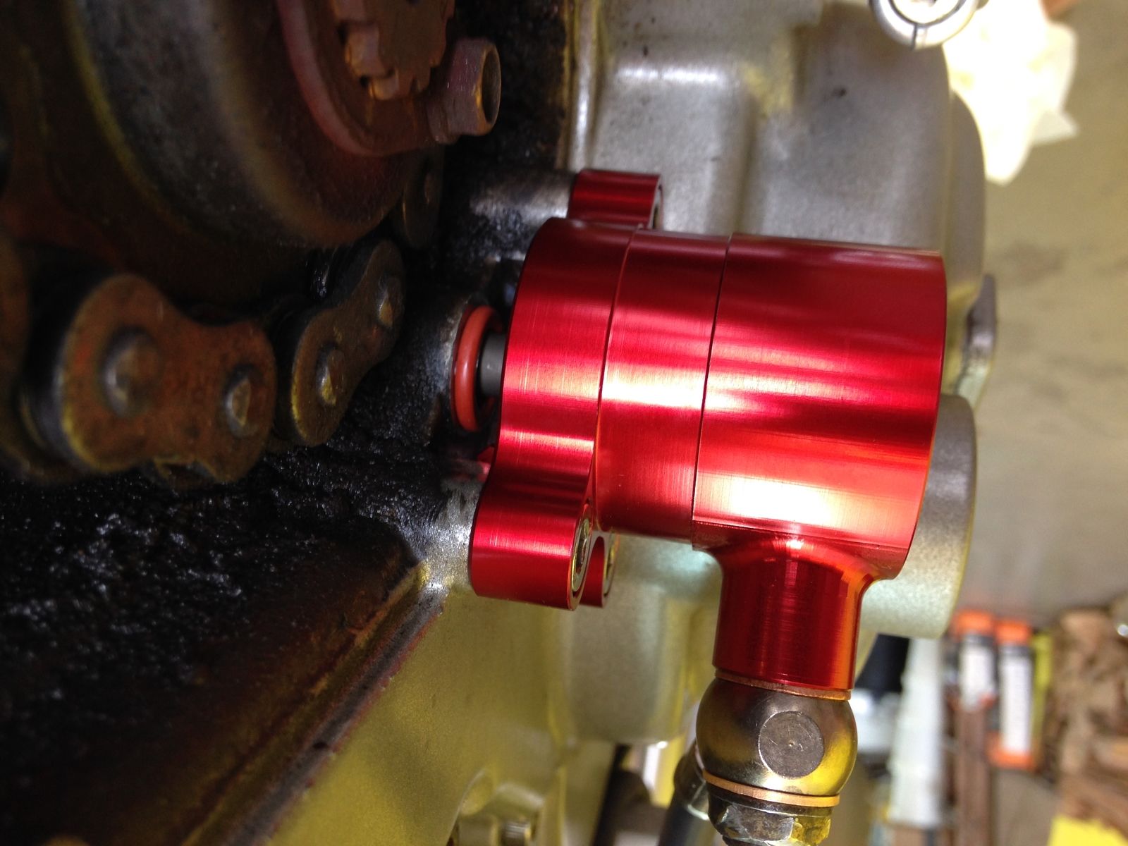

  8. Here is an illustration of mismatch..this Avanti one has the same back as Oberon's, ie it is flattish. It fits well, it works well....but look at that gap near the chain.
  9. The Oberon slave cylinders I have fitted have all compressed the green o ring, without exception. Andy
  10. They have worked well on my 750SS and 999S, too.
  11. Rich, the primary seal is the one inside of your slave cylinder in the same way as the seals within your brake calipers.
    The crap won't bypass this to get into the inner workings, and if it does then you've probably got bigger problems anyways as the seal will have already broken down. With a radial master it will move no more than 2.2mm so the piston will never by pushed out far enough to be a concern given the relative position of the seal inside it.
    If in doubt might I suggest a case saver?
    After rebuilding a gsxr engine which had suffered a chain strike i'll never underestimate the value of these and it will probably do the job of being a pretty good crud catcher as well.
    The other option is to squeeze a ring of grease into the gap to act like a wet seal. :)
