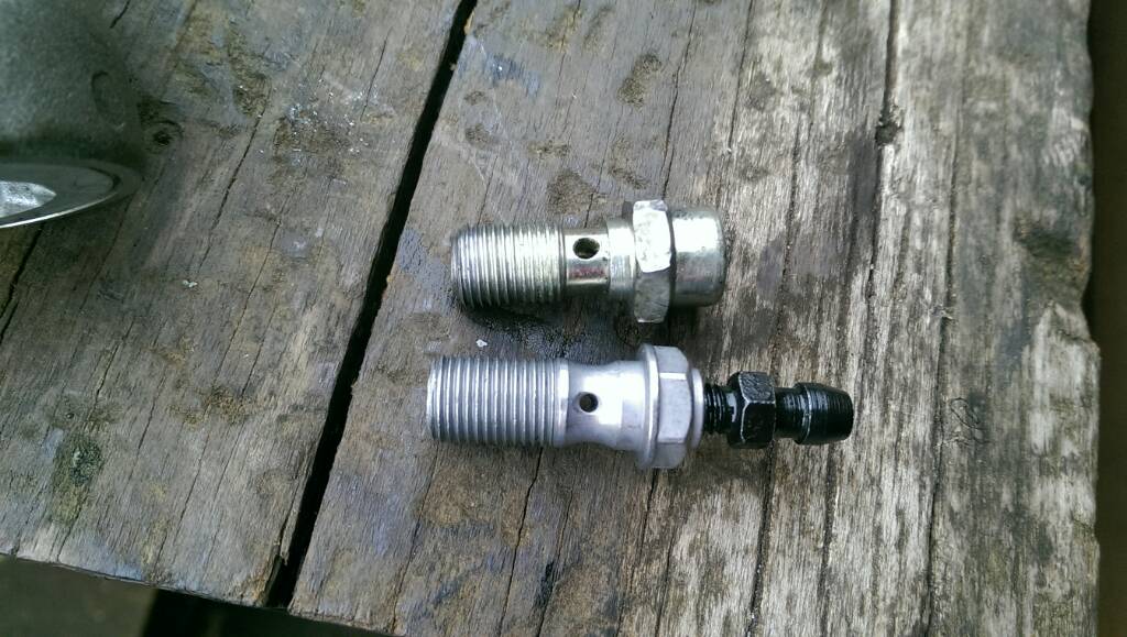

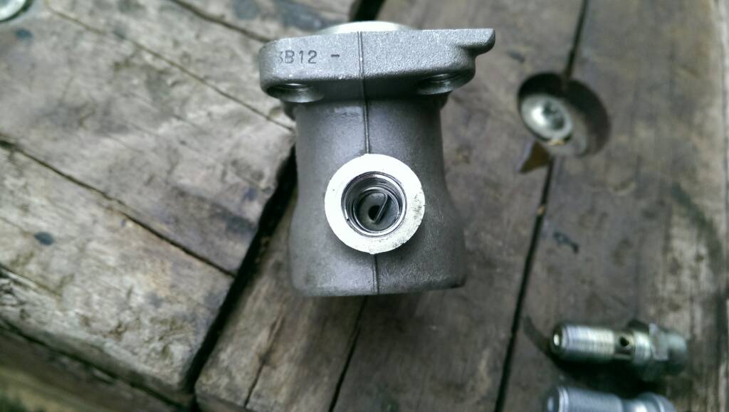

    1: is this a helicoil

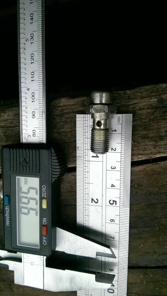

    2: This will be why the part MotoRapido sent is too long?
    3: can someone point me to the correct banjo on eBay as I'm struggling?
    TIA

  7. Or just cut down the one you have

  9. not a bad idea......
