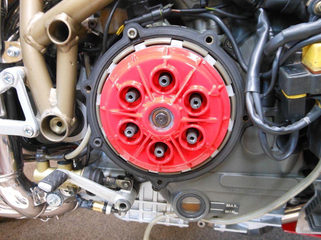

  9. proxy.php
    Not sure if i linked this correctly but look at the top right and zoom in there is an arrow pointing to one of the pots with a slot in it, this is from my 748
    If not this link page 4 scroll down a few more photos.
