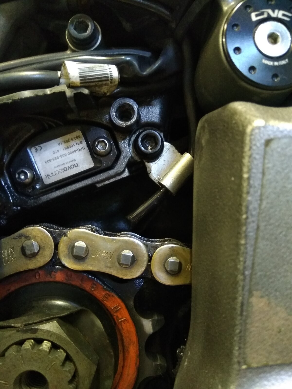

  13. Old thread updated after a query from Nigel about mounting the oil dispenser pipe, in the original position on the lower chain run it did work for while and then the chain hit the oiler pipe. No issues caused and never any oil on the tyre but the end of pipe did get squashed so I ended up moving the pipe to a better location.
    I made up a small bracket / arm from 2mm alloy to hold the pipe above the chain close to the front sprocket and it is now mounted behind the front sprocket cover so can't be seen at all.
    The bracket is shown in the photo below
    The alloy is bent round at one end to hold the pipe and a hole drilled in the other end to attach it to the Allen headed bolt just above it. much better install and no issues for the last 5k miles and completely hidden from view.
    Makes a chain drive almost as easy as a belt to maintain - but that is another thread :)
  14. That is ingenious, Veetwin. Thanks for posting.
    I have located mine in the same place now but used a bit of wire coiled round the feed pipe to deliver the oil to the correct place.
    Nice one.
